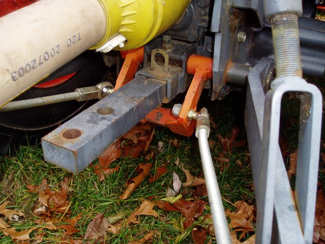

I did something a bit different for stabilizers on my B7500. It keeps the hitch centered no matter what width the arms are at. It was modeled after the hitch linkage that came with an old IH 686. I do have Pat's on my hitch.
