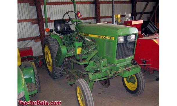

Have you seen the John Deere cultivator model 900HC? Not sure what wheels and tires it uses or if the axels are made different.
BATTY54
Many times I have wished I had bought one of those JD 900HC tractors. I got such a good deal on the 850 that I chose it. Plus, there weren't any of the JD 900HC's around although a local dealer did have a used one for sale a few years afterward.
