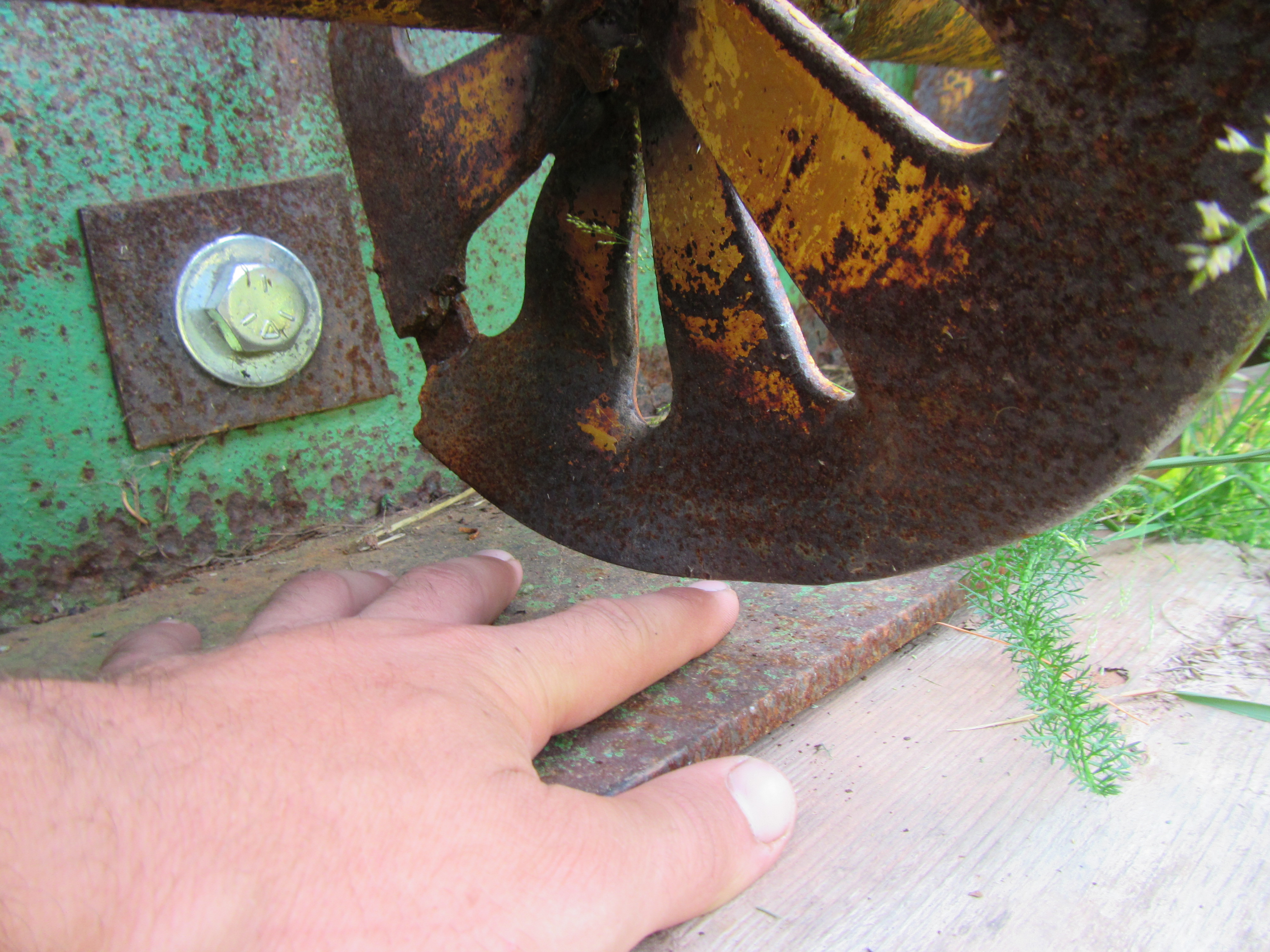

If the bearings are four bolt flange bearings you may be able to just drill two new mounting holes on each side and put what is now the top of the bearing into the bottom holes. I did that on a old blower and it helped a lot. Make sure the chain will clear, you may need to trim the steel where the chain goes through. I am not sure why so many blowers have the auger high up, all the commercial grade blower around here like Pronovost and Normand have the augers set just about an inch and a half above the ground. Lucknow has the auger low, and on the McKee blowers they are real high.
These two pictures show the old Walco after I lowered the auger. You can see the old bolt holes in the side of the blower box. The auger is just about an inch above the cutting edge and the ground. That blower would go through hard snow and was the easiest pushing blower I have ever had.

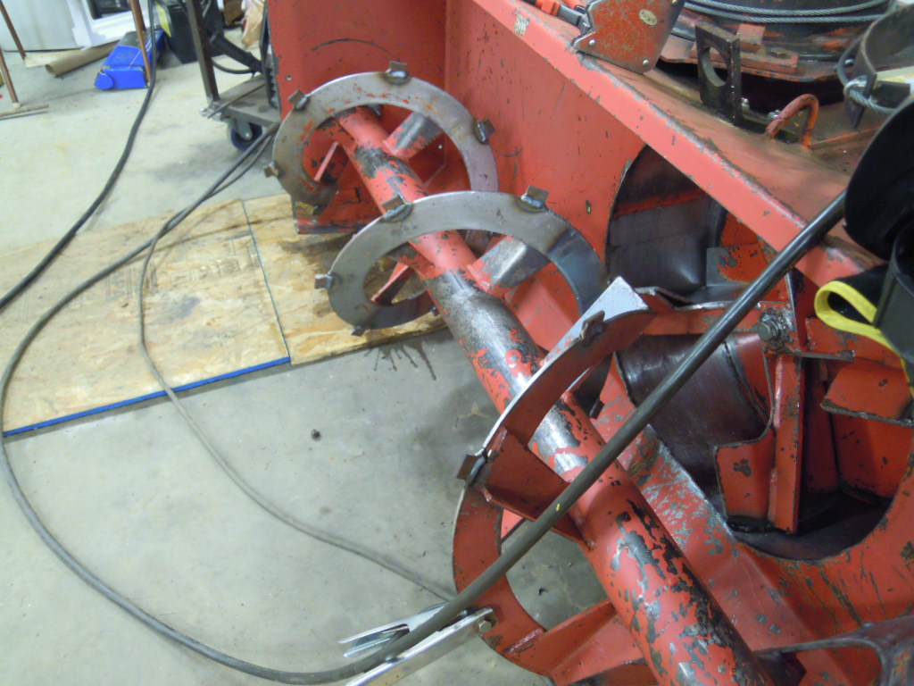

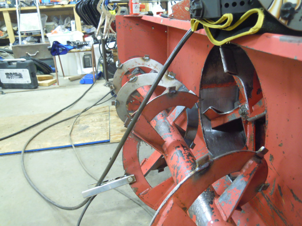

I ended up adding the tabs tonight.
I'm not going to lower the auger because it would involve cutting down into the base plate of the blower, lowering the support arm, making a new shield for the chain and drilling 4 new bearing mount holes on each of the side plates. Too much work on this blower unless I feel it will really improve the performance. First step is to try the tabs.
Here are some pics of the tabs.

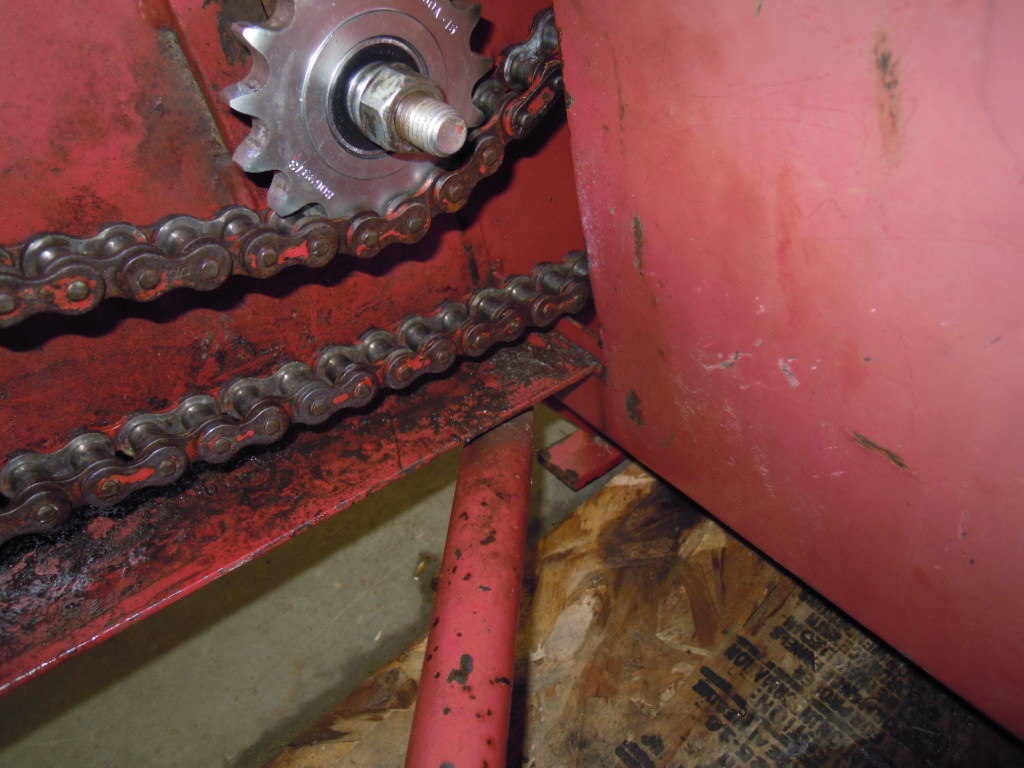

Pic of the chain going through the back plate. You can see from this that there would be a fair bit of work involved in lowering the chain.
I'll see how the tabs perform and might consider adding more tabs between these ones if I think it would help.

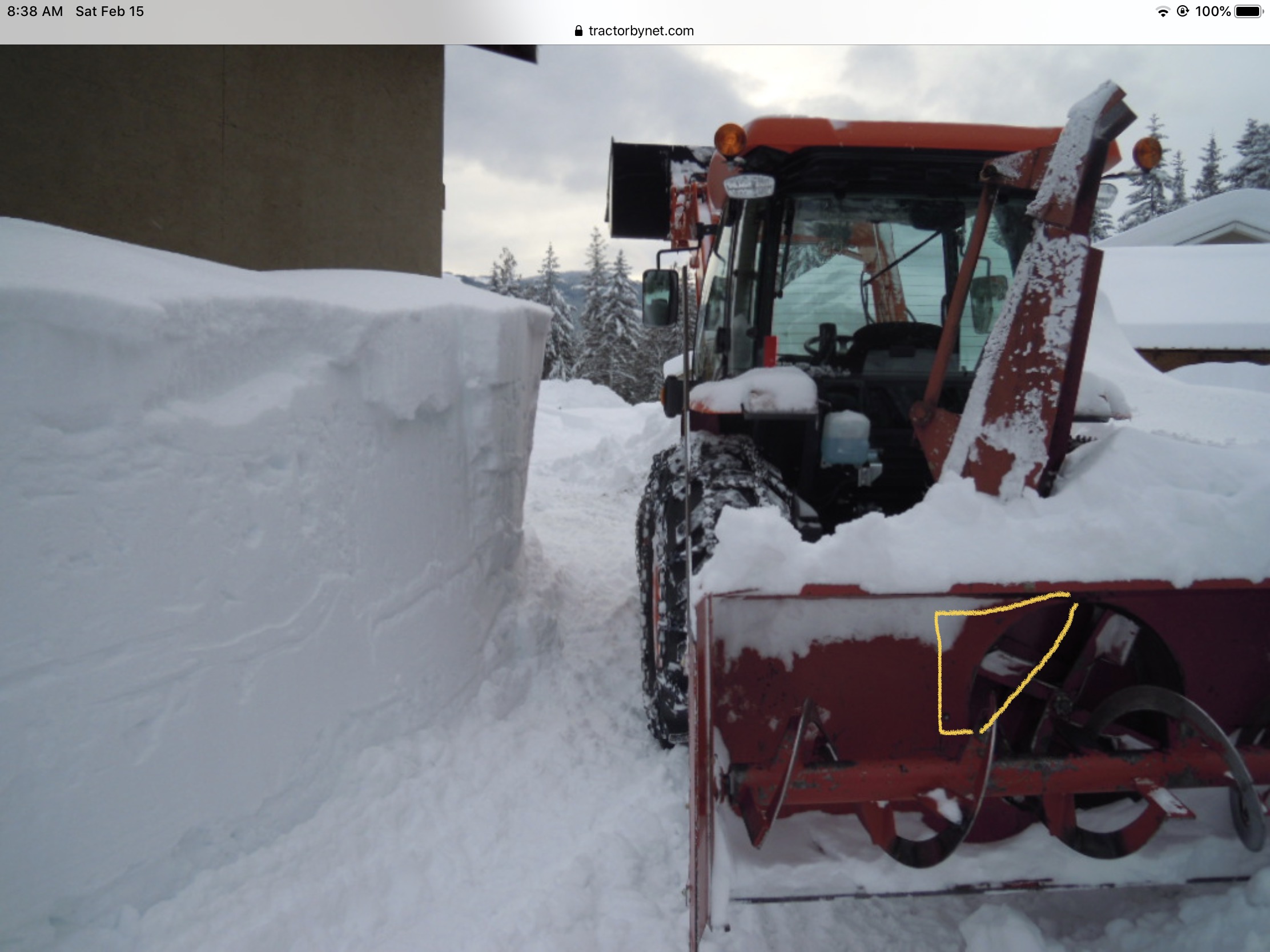

Hillbilly, nice work with those tabs, they look very aggressive and should do fine.
Noticed in your second pic last post, there are two holes top left quadrant of the drum. I am wondering if you are missing a partial closure plate.
   / Adding Tabs to a Snowblower Auger to make it serrated.
#27
Good eye. This blower did not come with a plate there. I made one, thinking it would help with blowing the snow further but found it didn't blow any further and actually wouldn't process the snow as well. So I took it off.

I tried it out today and it worked well but could be better. I noticed wherever I stopped, the auger left chew marks where each of the tabs were located and there was about a 2" gap between the chew marks. I think I am going to add more tabs. These ones are located with a 6" gap between them, so I will add another tab at the center of the each gap. This will double the number of tabs to 28 on each side. I was surprised at what this chewed through though. There were some areas where the snow has been pushed repeatedly and at the base of those piles there was solid ice, not hard snow but solid ice. You know, the stuff that looks like dirty glass and this thing chewed through it without even bending the tabs. There is still the issue of trying to push the bottom of the blower into the hard stuff but I don't think I will bother with lowering the auger just yet. Tomorrow I'll see if I can get some pics of where the auger chewed into the banks, to clarify what I'm saying about the gaps.
