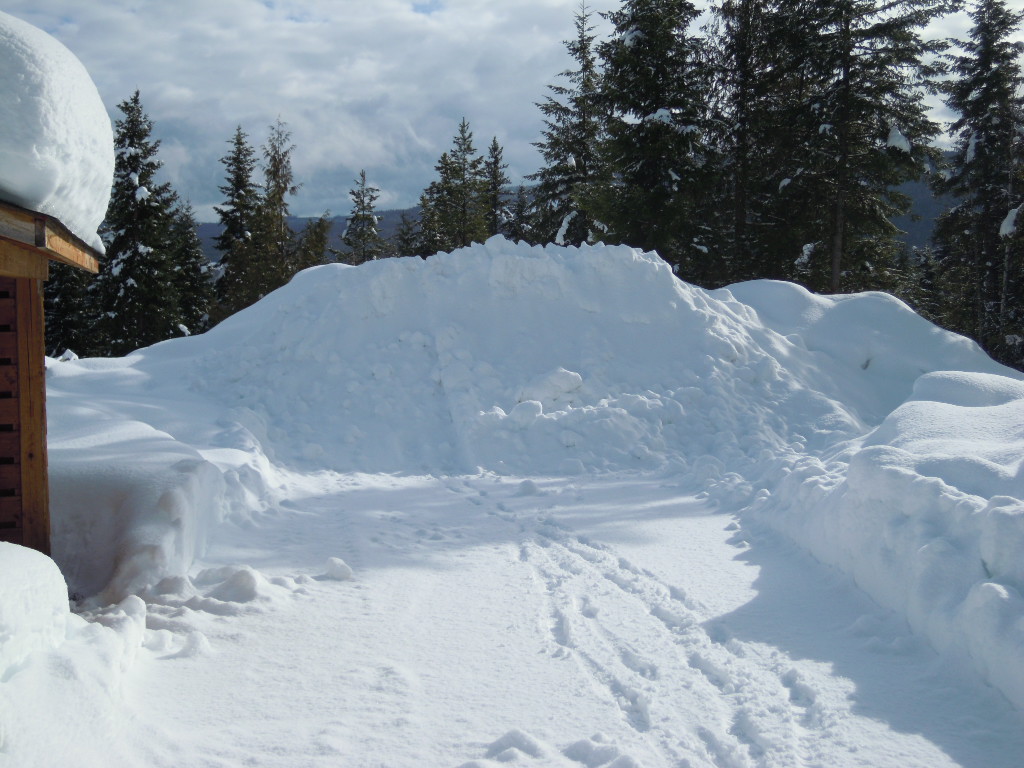

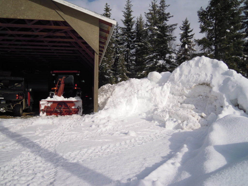

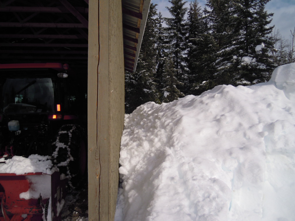

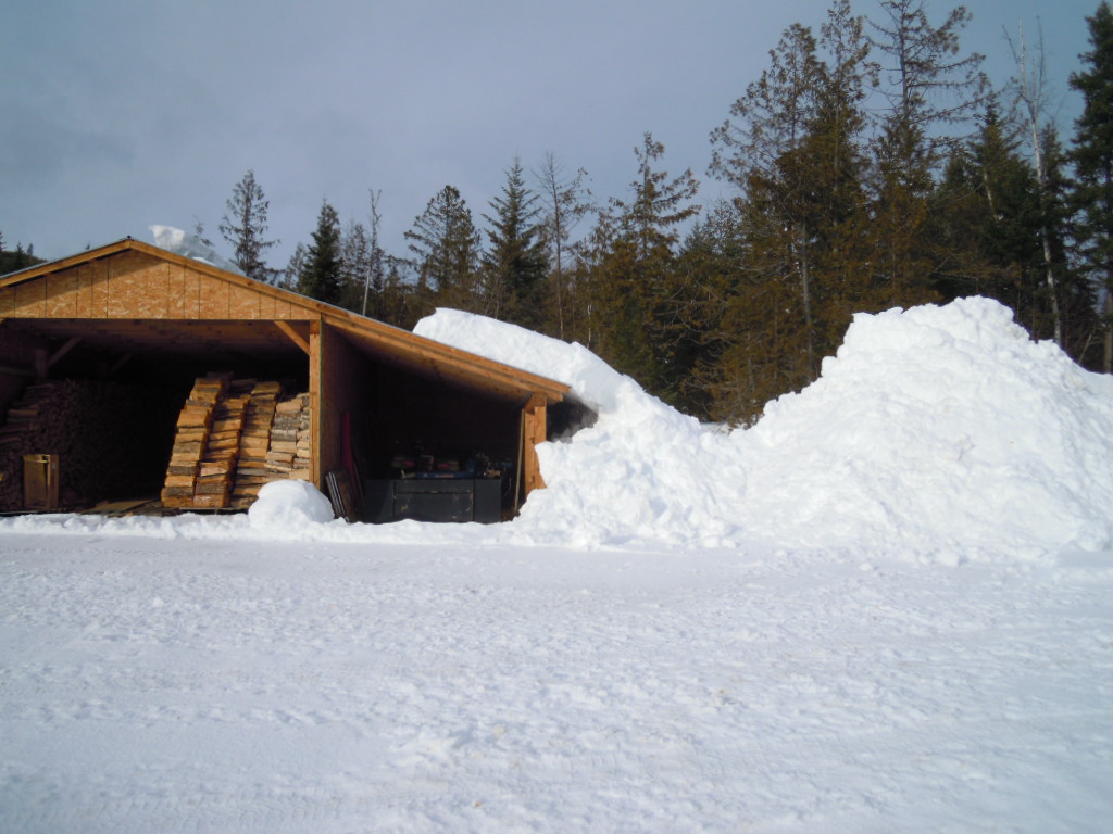

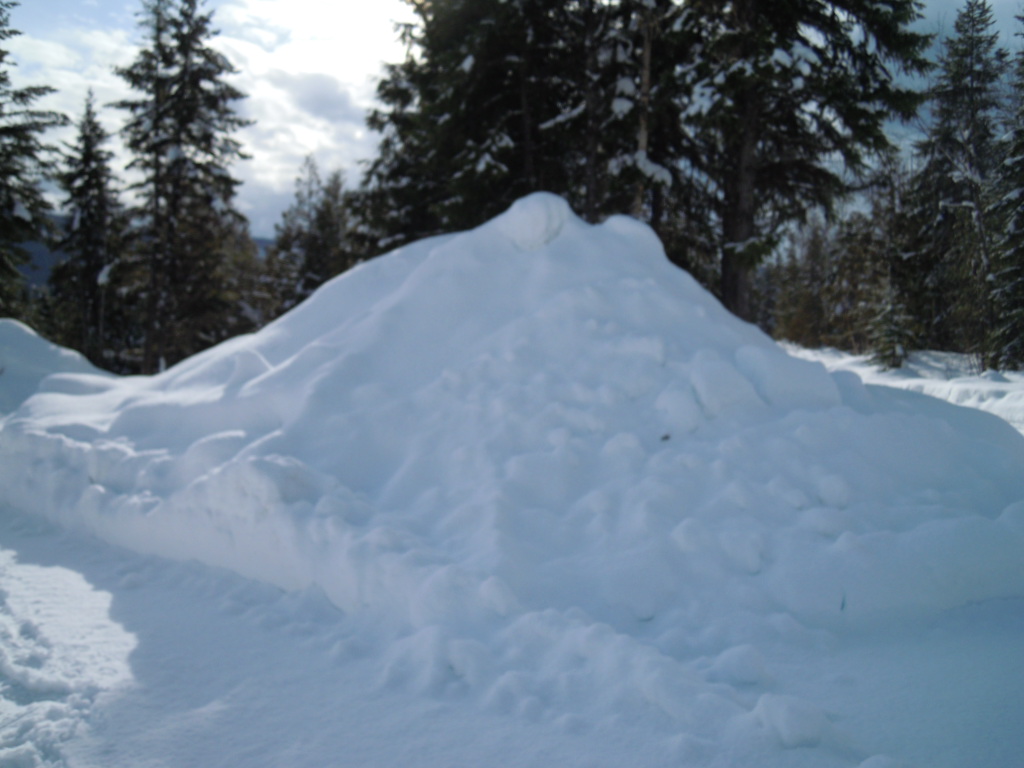

That's certainly an option but a slow process. Which is fine if you don't have a lot to move. I'm looking for a better, more efficient way, since I have a lot to move.

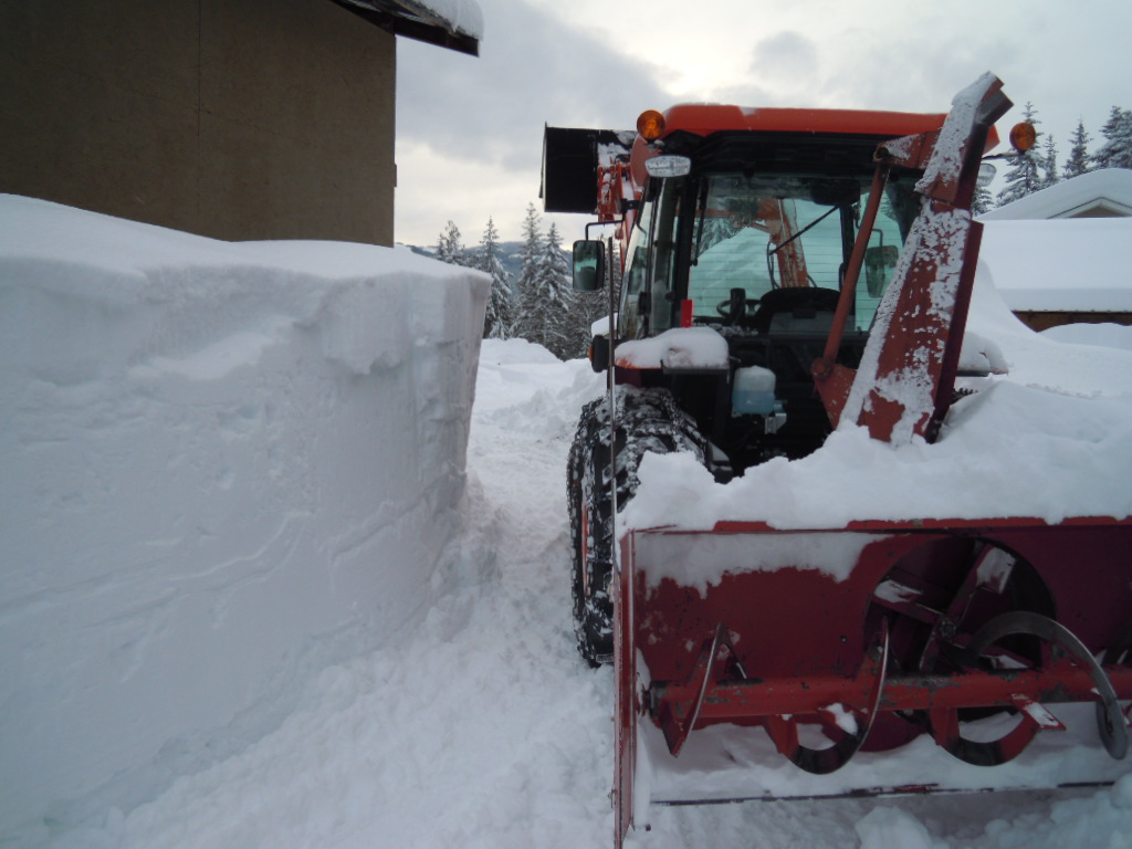

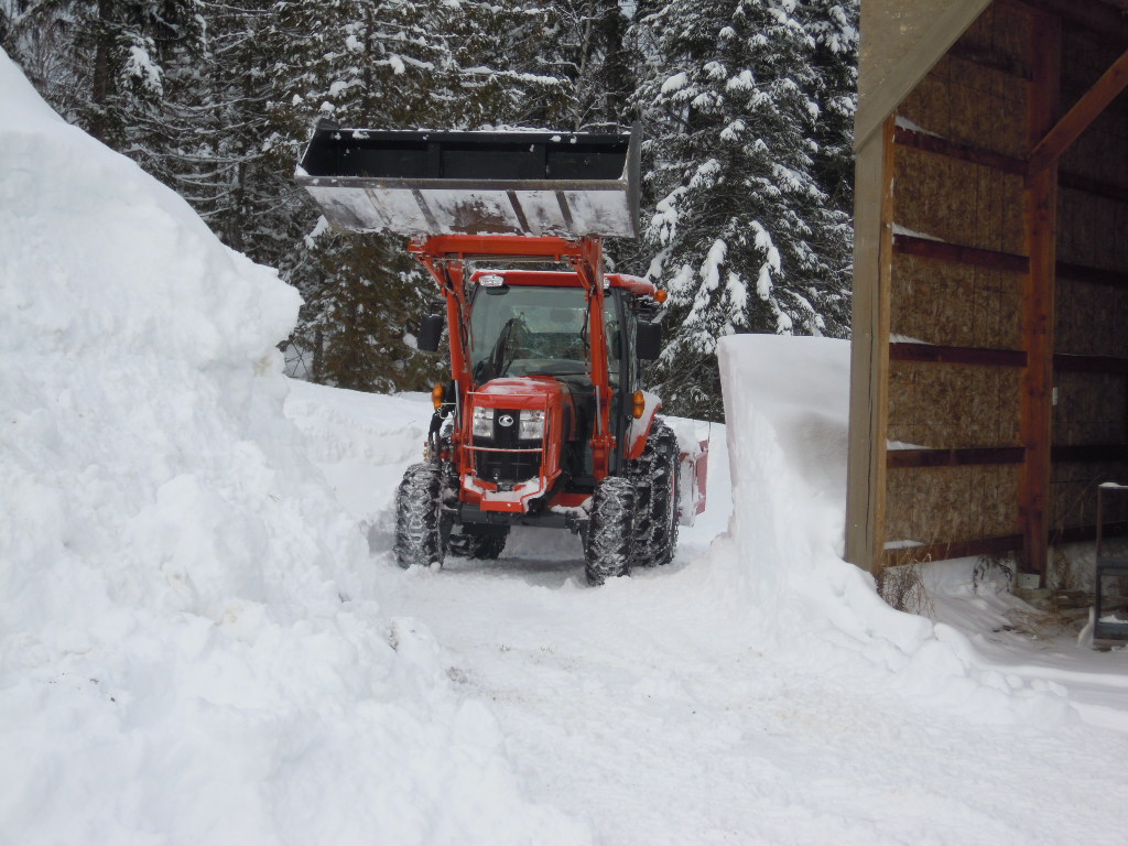

Today I blew a pile from one side of my equipment shelter. The pile was about 2 1/2' to 3' deep and about 10' wide. This is the amount that came off half the roof the last time,which was not very much. This stuff was so hard I could walk on top of it without sinking in. I didn't think the blower would work but it did and quite well. But there are other piles that are much bigger and harder. I tried the method you described and found it to be too time consuming because of the constant need to pick away at the pile, then turn around and blow it, then turn around again to chip it back. That's OK for a small job.
I'm going to go ahead with welding some tabs to the auger and see if that makes a difference. First I need to get some time and then I need to find some steel under all the snow we still have.
Some pics from today.
and some from about a month ago.
View attachment 641177View attachment 641178View attachment 641179View attachment 641180
View attachment 641182View attachment 641183View attachment 641184View attachment 641185

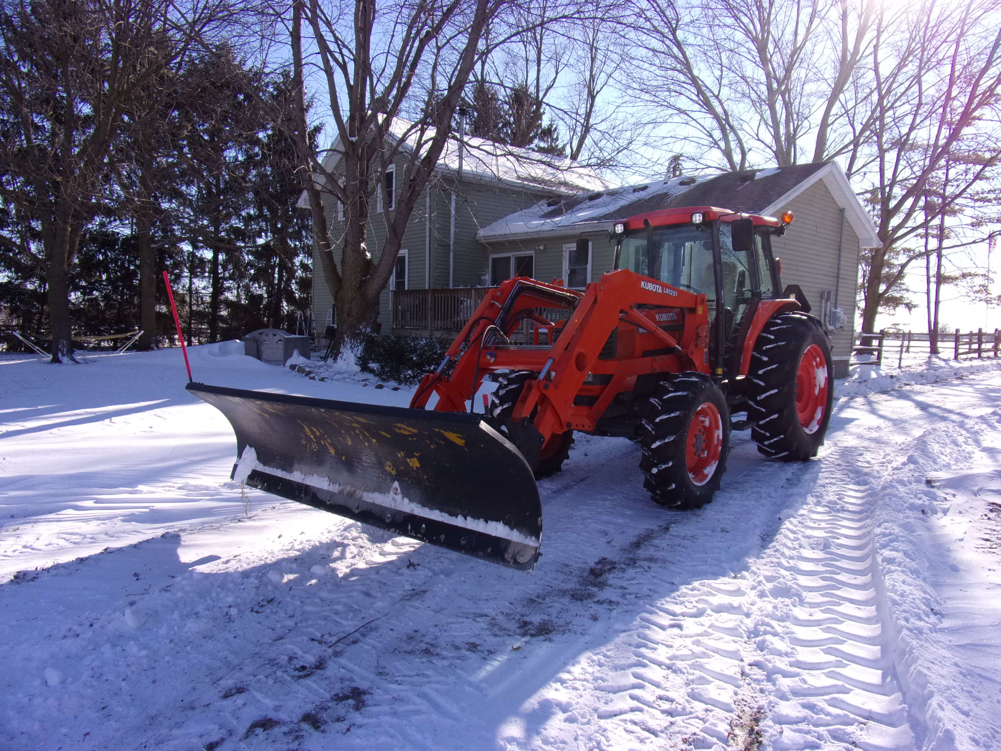

You need a bigger Kubota....
More like this.....

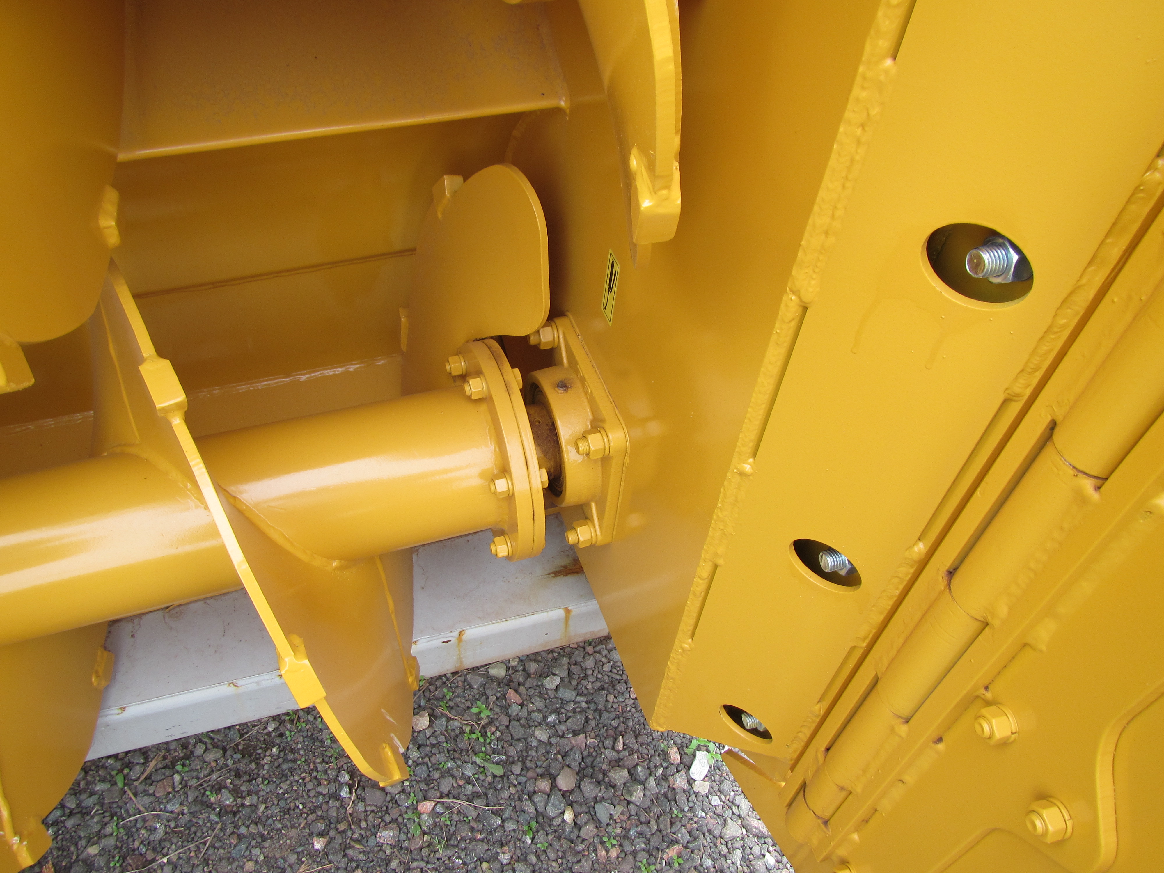

Here is a photo of the teeth on the auger of a Normand heavy duty snowblower.
