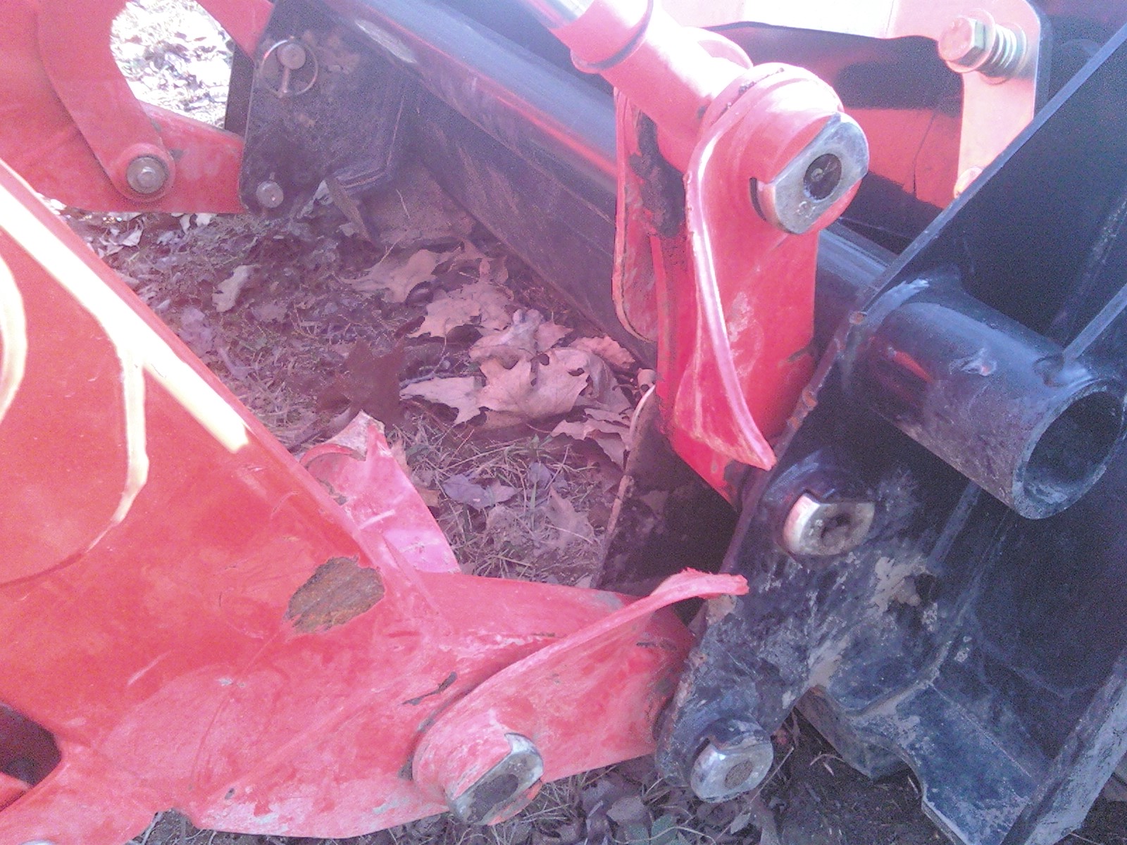

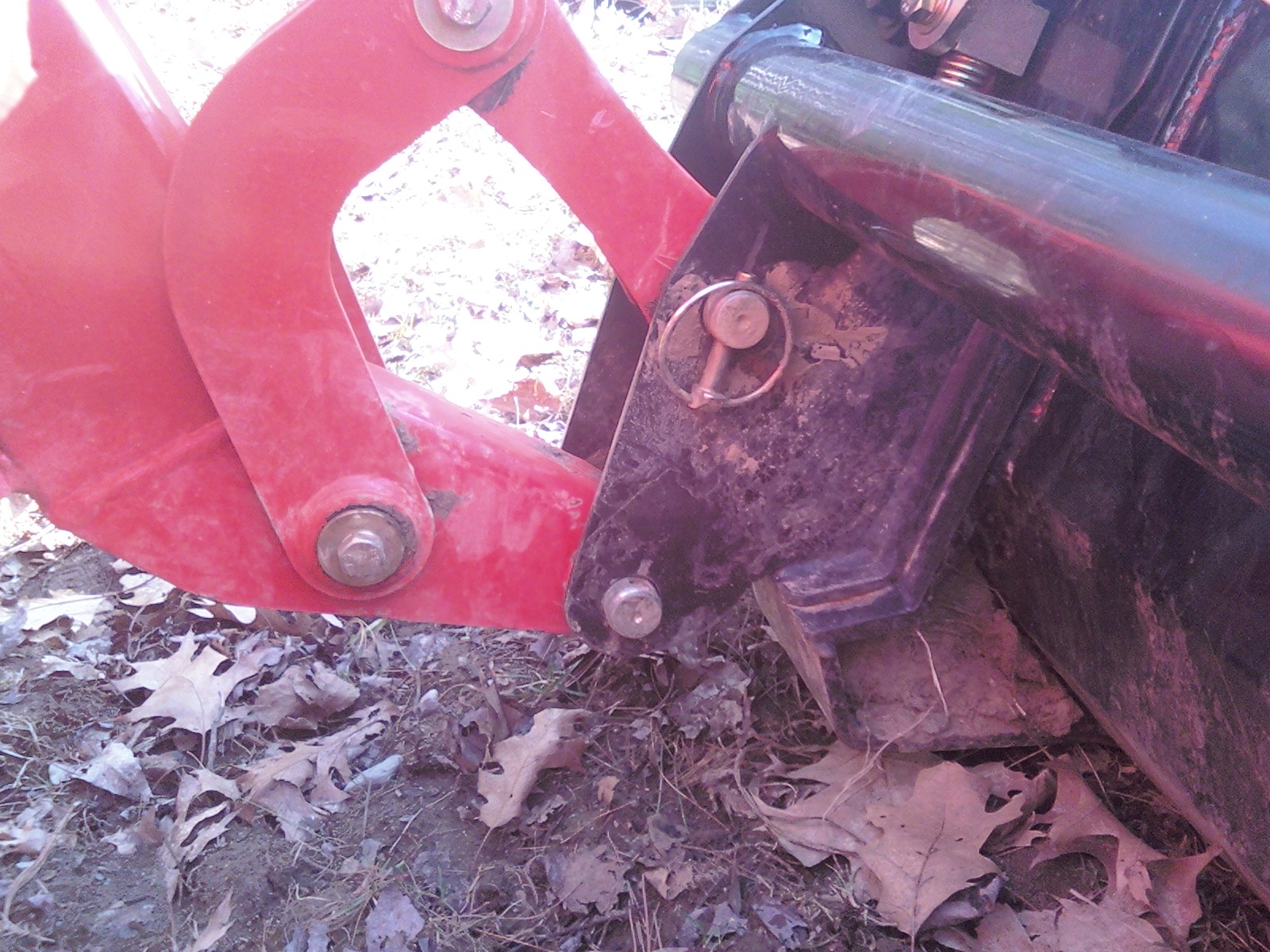

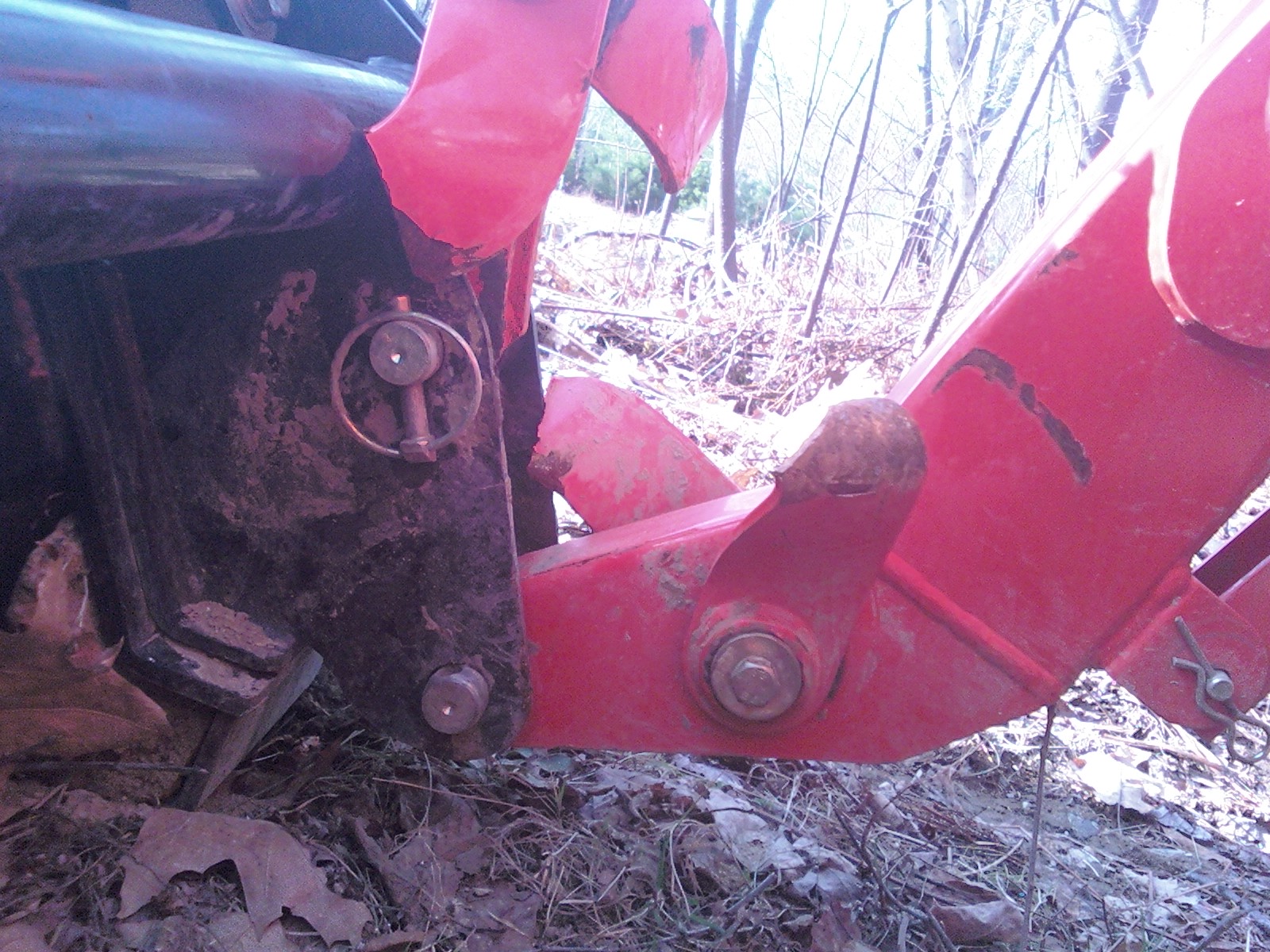

I did find missing pins - on both sides (see pics). Does this mean the bucket torqued off at the bottom at some point on the side that broke?
Any recommendations for keeping the pins on? I can certainly check every once in a while, but it seems like better attachment would be best.

I haven't lost a lynch pin yet on the pivot pins. I noticed you have yours going through from the lower side of the pin holes. I drop mine in from the top so if the keeper ring gets caught on something, they have a lesser chance of falling out. Hopefully that helps them little from falling out. I suppose you could always use bolts with self locking nuts like those used on my Kioti bh bucket pins. I've never had a bolt loosen.

I have never lost a lynch pin there either, but it certainly could happen.
Your point about the pin orientation is a good one.
My hoe also uses bolts and nuts, but I rarely take those pins out. I have
lost a few nuts and bent the bolts, however. On my FEL, I change from
forks to 4-in-1 bkt 2x per year, so bolts are out for me. (Maybe I change
my tune if I do lose a pin!)
I just made some replacement pins for a Bobcat 4-in-1 bkt and I like how
the pins are retained: a small pin, which goes thru the pivot pin, is bolted
to the side of the clevis. Nice setup.

I have a Kubota L3240 with an LA724 loader. I have broken the same links (both sides) over the past year. The problem was that the pins "were" secured with a metric bolt and locknut. The bolt was too long, and when curling and dumping the bolt would get bent. Eventually it fell out and the bracket swung loose. Since only one side of the connection came loose, I didn't notice anything wrong with the bucket. My "fix" was to replace the brackets with new kubota links (about $25 each) and replaced the bolts with 1/4" cotter pins. Now nothing can get bent and it has held fine.
I also replaced all of the metric pin bolts and locknuts with grade 5 hardware and locknuts on all other connections. I removed all of the pins when I did that and found that two of the lower link pins on the QA bucket were actually broken. MORE stuff to fix, and a GOOD reason to do routine lube and inspection. I found the broken pins BEFORE they "found me." No complaints here, I use the heck out of my loader. "Fair-Wear-and-Tear" has a new meaning when dealing with loaders.... Heck, IF you are not "overloading it," how can you justify even having one.....

They're talking about losing the lynch pins. These are the pins with the wire ring attached to them. The same kind that are used on the 3pt attachments where they go through the 3pt arms. These lynch pins may fall out and then the one inch diameter pins, that are the pivots for the QA adapter or a pin on bucket to the fels arms, start to move out of position.
