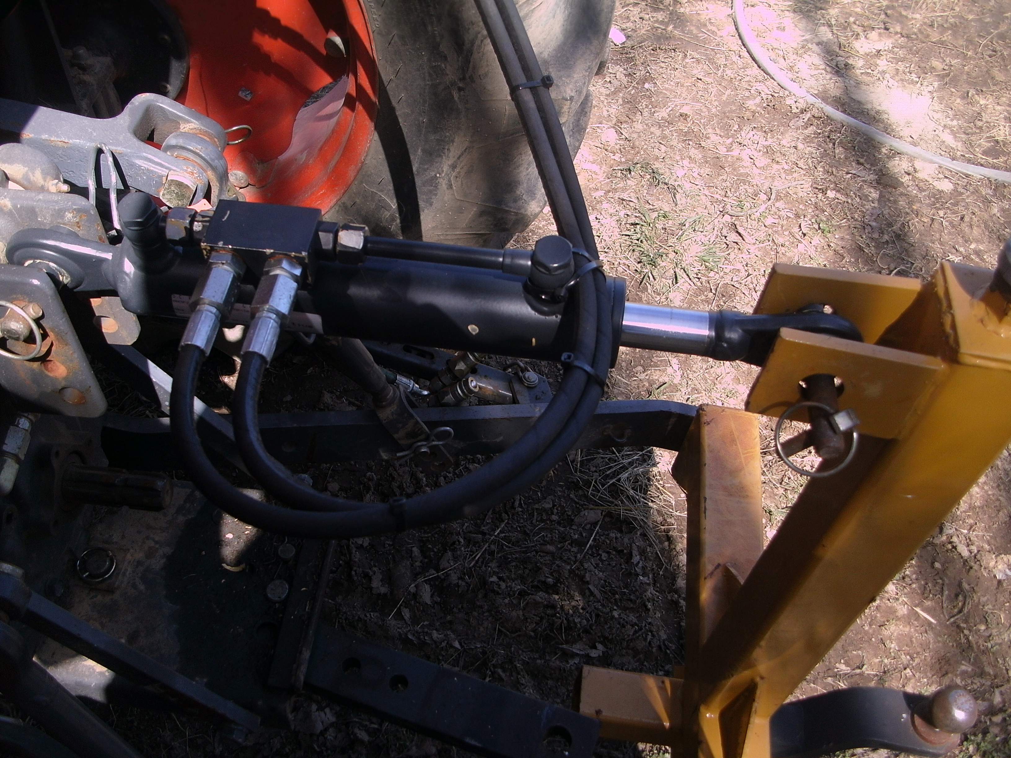

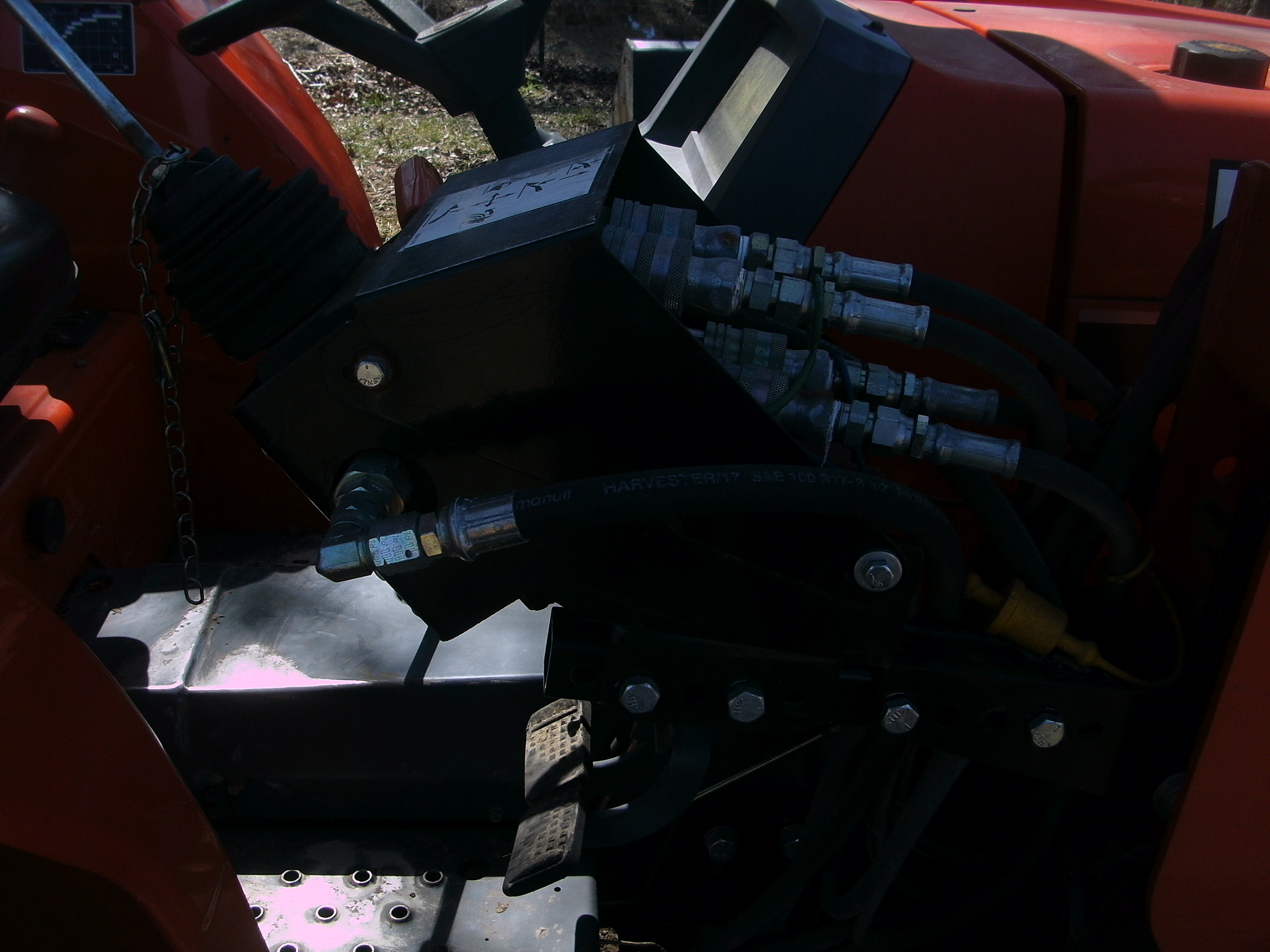

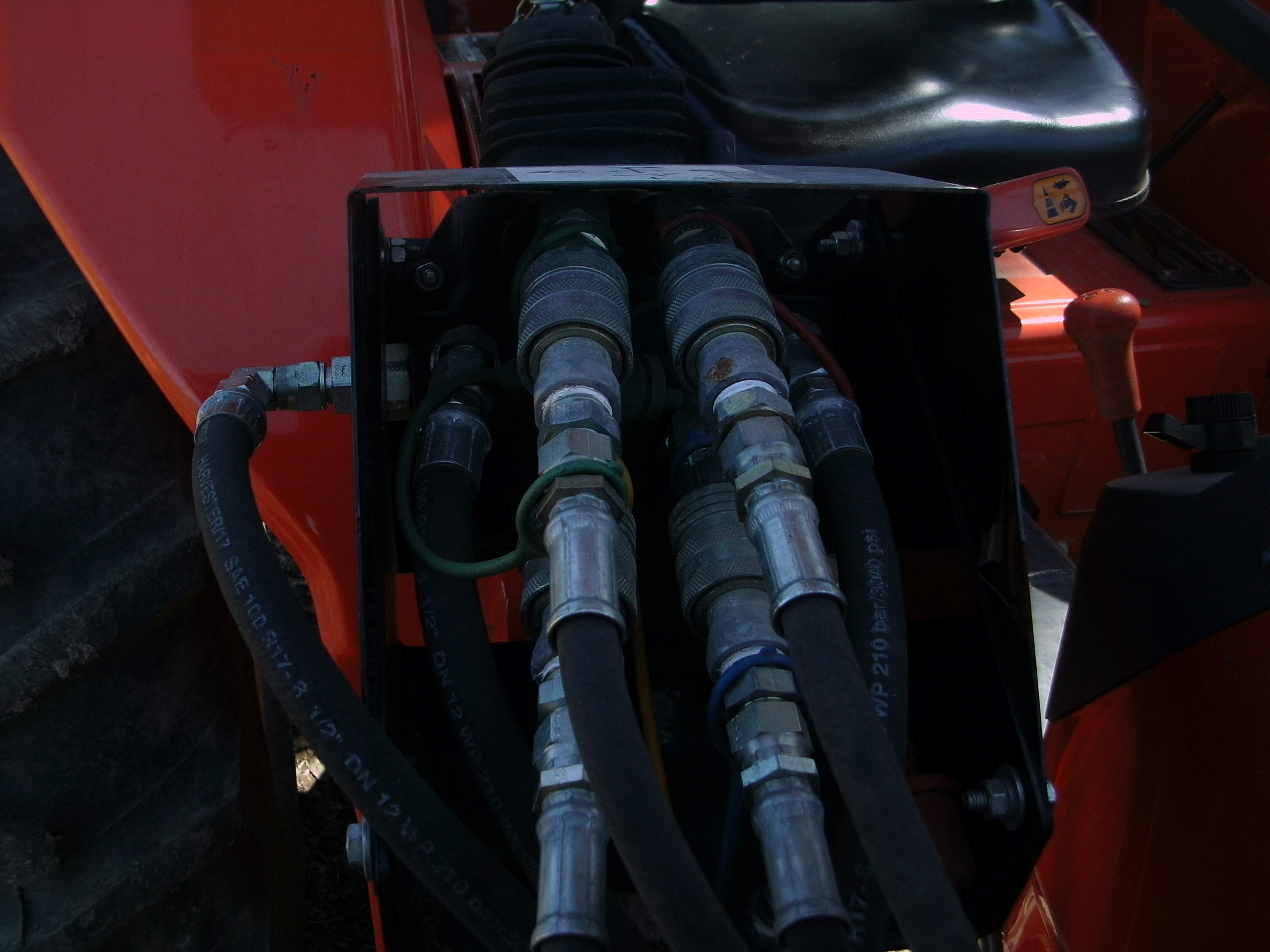

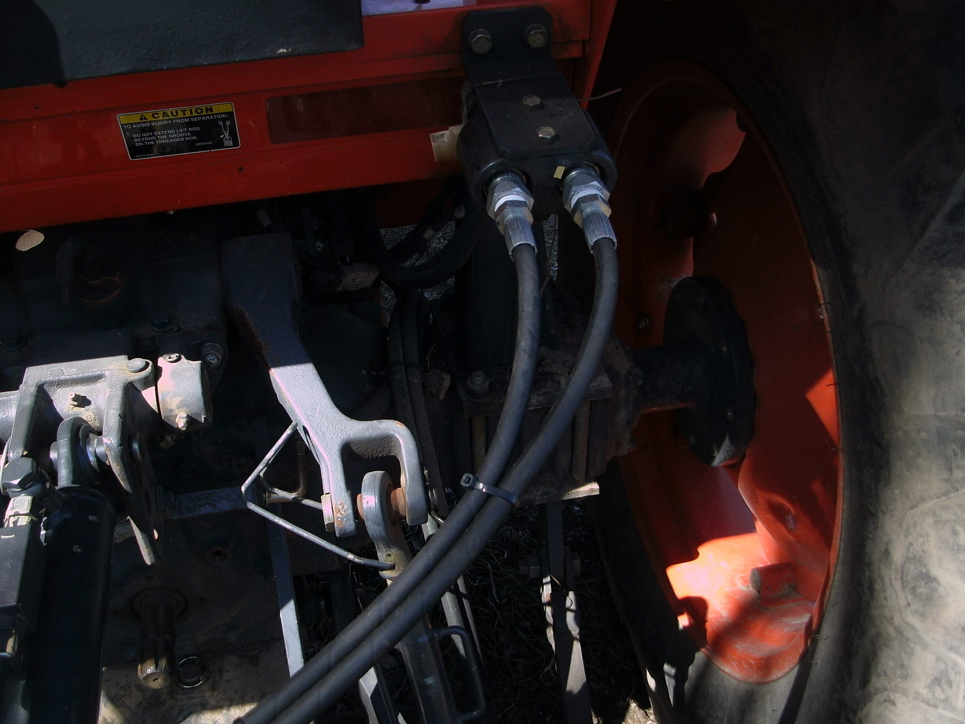

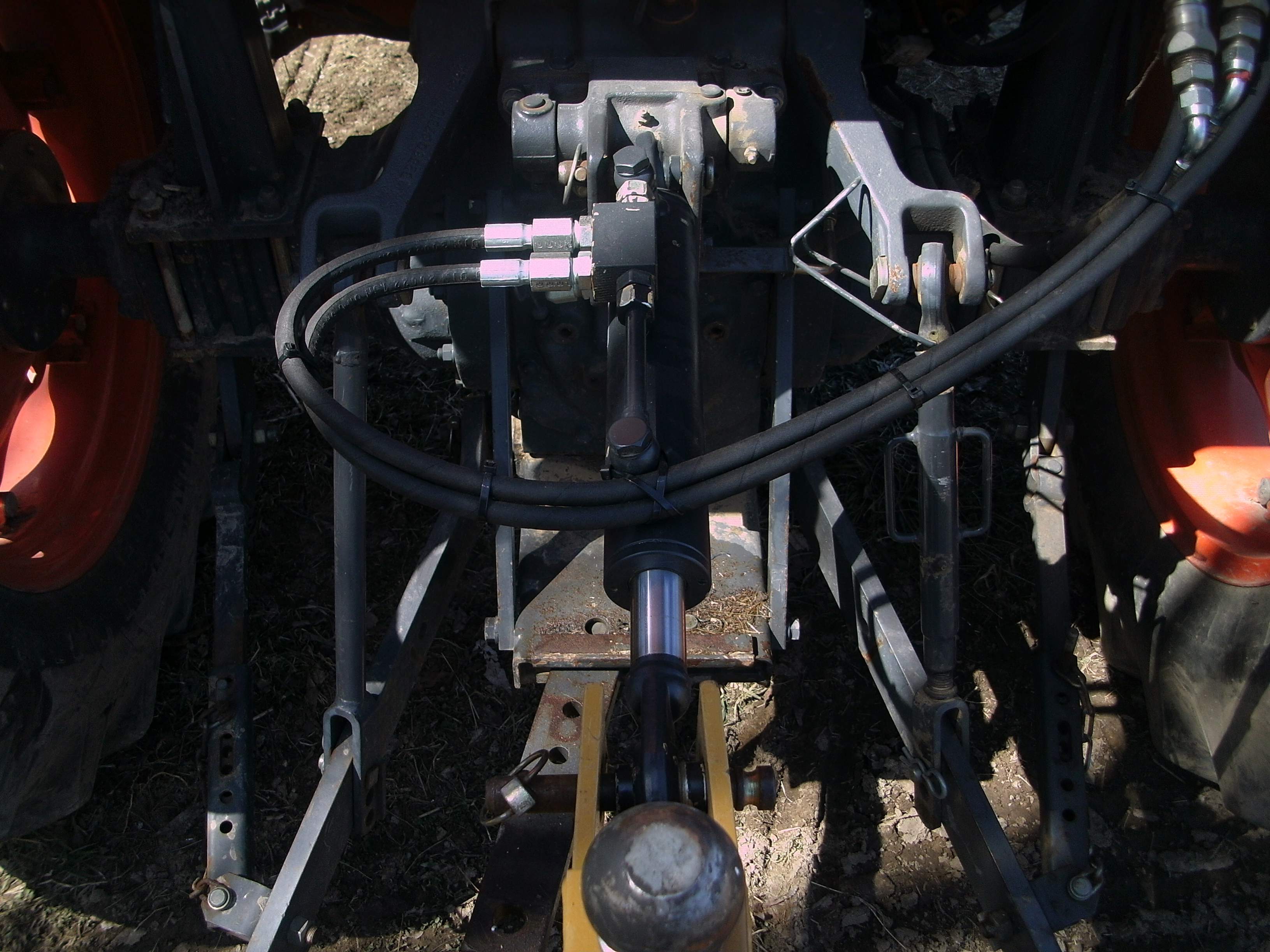

Kennyd, JJ, and Rob,
Here are some pics. I think I have it figured out now.
Pic. #1, 2, 3, are of my CCM HTL. If you look at picure #2 you can just see the 90 on the left side of the picture where the return goes into the rear end housing. #4 is the Power beyond port on the loader valve, and #5 is the top of the loader valve.
Looking at picture # 5 the supply line is on the far right and the return is on the far left.
Sorry the pictures are so dark. They were taken with my daughters digital camera and I couldn't figure out how to get the flash to work. :drool:
Thanks for all the help!!!
Chris

   / Adding remotes to a Kubota M4800 #17
Looks good Chris! Glad you got it figured out:thumbsup:
Just one note though...You can loosen the compression fittings on each side of that DPOCV (the box mounted on the cylinder) and turn it so the ports are facing the right side of the tractor.

#18
Kennyd,
I know. I loosened them and turned it to the left. That way I wouldn't have a big loop in the way on the right side. I moved the 3pt through all ranges of motion with the bushhog on and didn't have any problems with the hoses kinking. I may try it that way to see if I like it better. Right now I have the hoses tie wrapped to the cylinder.
Thanks for the suggesetion.
Chris
