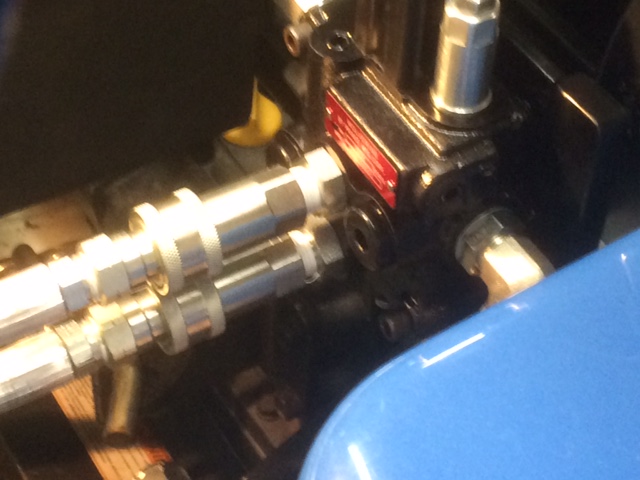

I have a Mahindra 2810 which I greatly enjoy. Should be everything that I need however i would like to add accessories which will make my life easier as I get older. I am thinking about adding remote hydraulics however I know nothing about hydraulics. How easy a job is it to add them and what brand would you recommend?

1 SPOOL 8 GPM PRINCE MB11B5C1 DA VALVE
600-06-06S | Set of 3/8" Hydraulic Quick Disconnects (Steel)
Adapter fittings for using the Quick Couplers with the valve shown above:
6401-08-06 | #8 SAE/ORB Male x 3/8" NPTF Male
I've used the valve shown above on a couple projects with one being a three spool valve instead of the single spool shown. The 3/8" quick couplers shown above can be mounted directly to the valve using the adapters fittings shown. This eliminates extra hoses between the valve and quick couplers as well as a mounting bracket(s) for the quick couplers.
I mount the valve behind the seat and near the right fender as this is a natural position for me when turning around to view rear attachments. (and top and tilt when multi spool valve is used)
