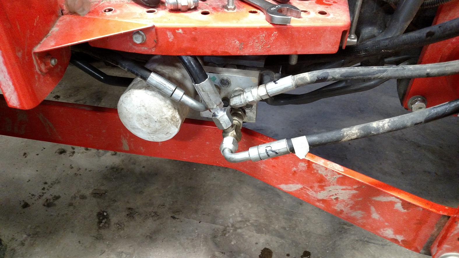

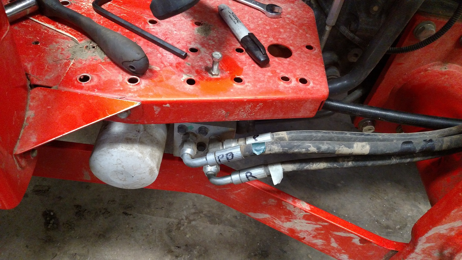

Do you guys see any problem with "teeing" into the FEL "Return"? I'd rather take this option than "teeing" into the Manifold "Return". I realize that's adding an extra 72'' hose and a few fittings but I don't feel safe with the tee sticking out at the Manifold Return. I tend to be rough on equipment and push it a tad too far at times
/ adding rear remotes to MX5100 #14
The return can be tee'd anywhere, but if you use the right fittings it dont add that much.
Before
After
And they are pretty well protected with the loader brace right under there.
