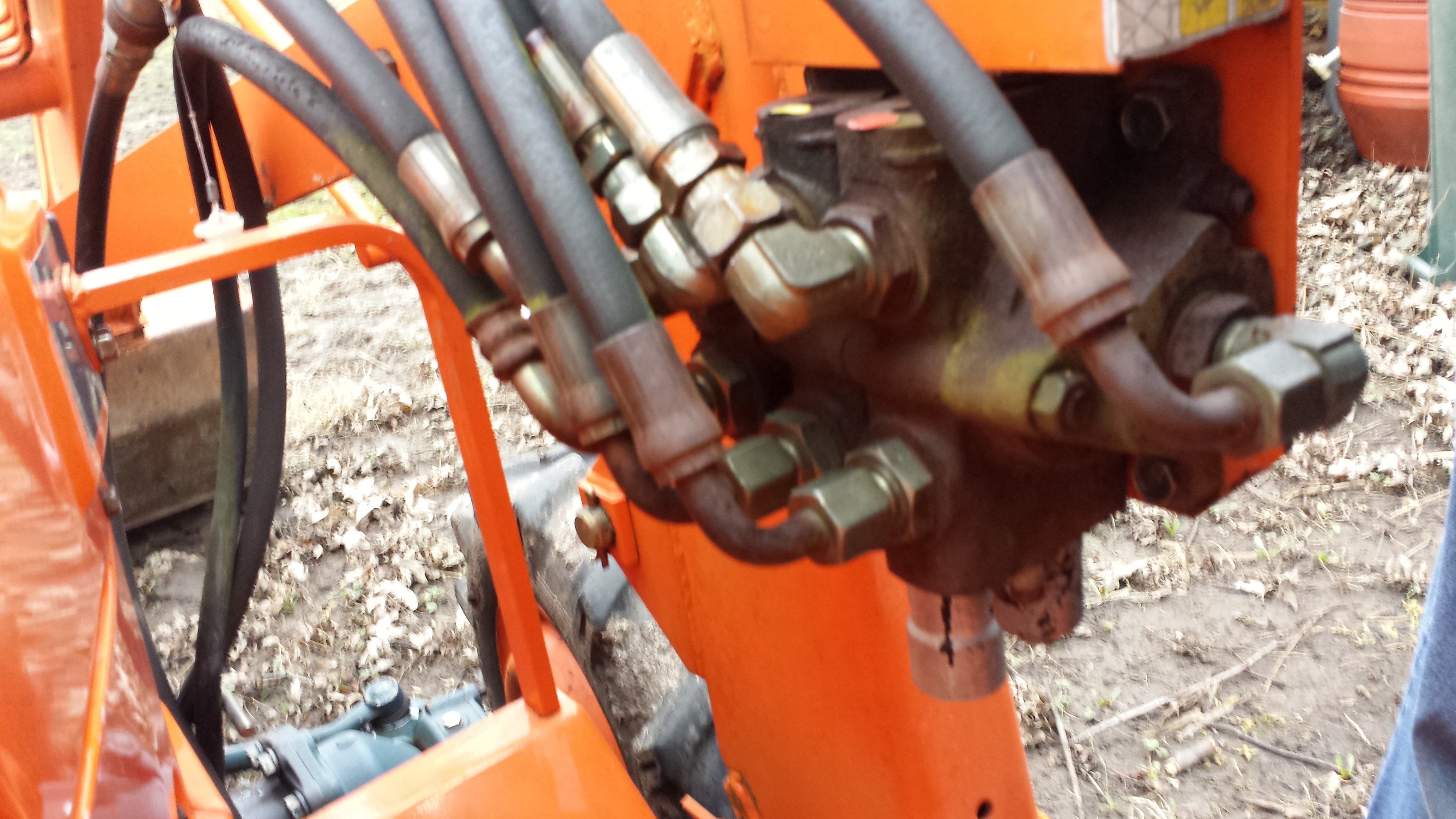

You can not "T" into the FEL, you have to put the valve in series. One after another. Whatever your valve needs to be able to handle 6.7 gpm flow (anything less, the oil will heat up). Do you have any photos of you hydraulic block? also, you FEL valves?
So you'll have high pressure in, high pressure out, and you'll also have Low Pressure return to the tank (you can "T" into that line with the new valve and the FEL valve).
/ Adding rear hydraulics to L2250
I will shoot some pictures.

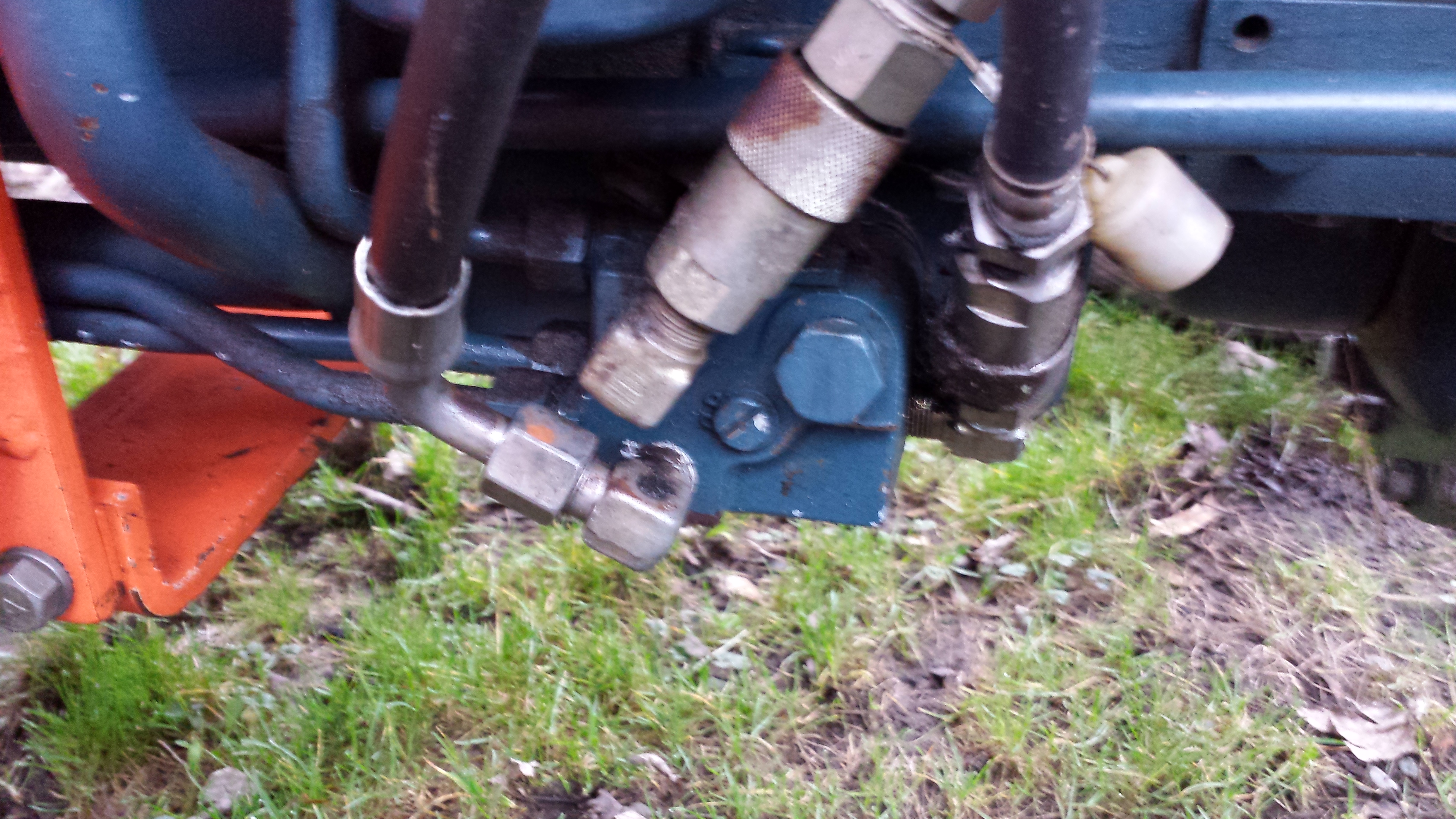

Here are the loader valve and what I assume is my hydraulic block
If I'm understanding correctly, I would connect the return hose from my loader valve to the pressure/feed port on a new valve. Then the return from that new valve would connect back to my original hydraulic block return port. Is that what you are referring to as a series circuit? The hoses and new valve need to be capable of handling the loader valve flow, correct? The LP return hose could be teed into the existing LP return hose.

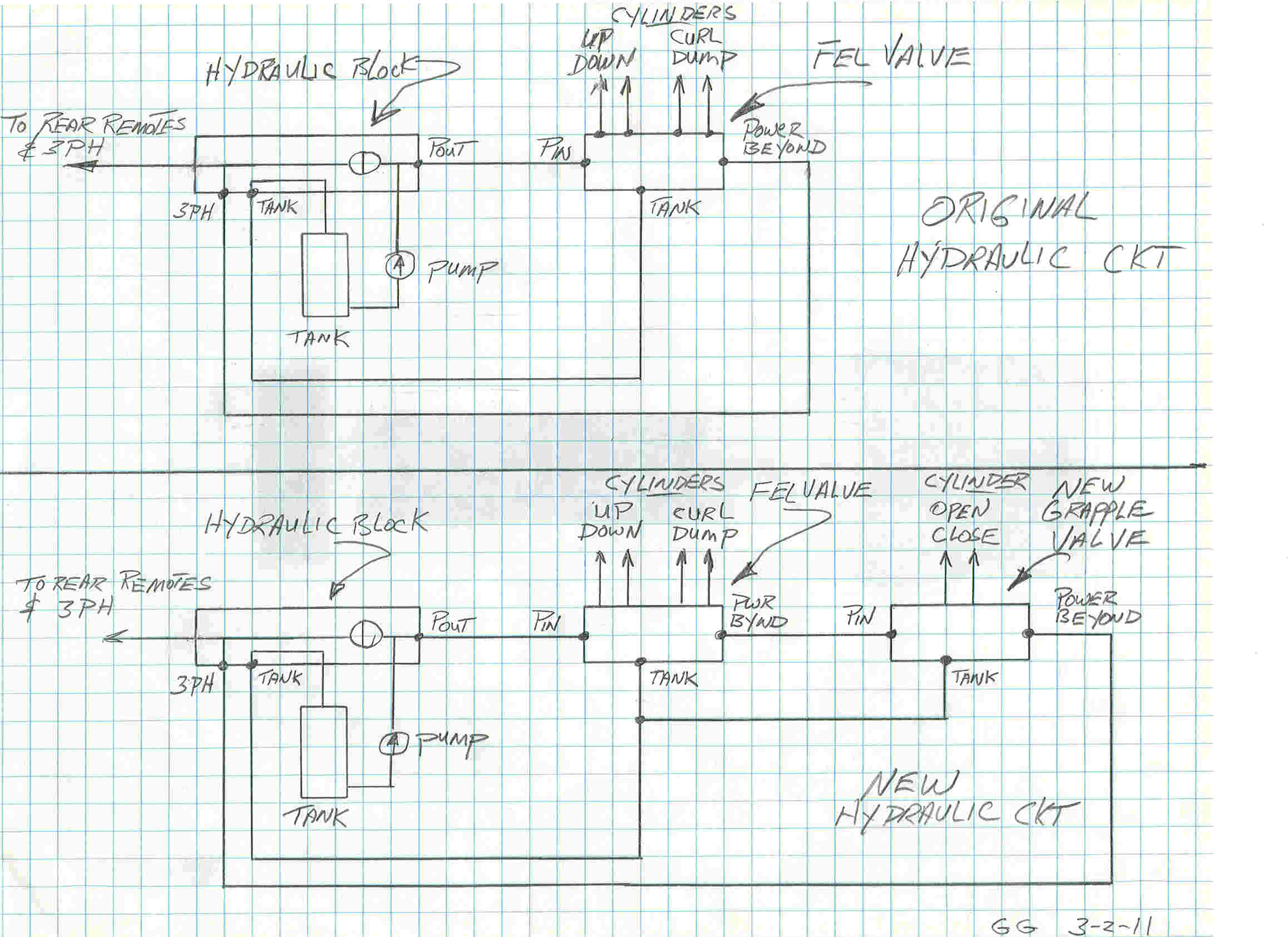

You are in good hands with teg. Here is a diagram of how I added a grapple valve in series with my loader. Maybe it will help. I put the new valve after the loader. Like teg says it doesn't matter - that is if you know which line is the power beyond out of the loader valve. If you don't know it would be easier putting your new valve before the loader valve. The power beyond from the new valve would go to the FEL valve Pressure in. The out from the new valve would go to tank. And the P in to the new valve would be the P in line you took off the loader valve.
gg
