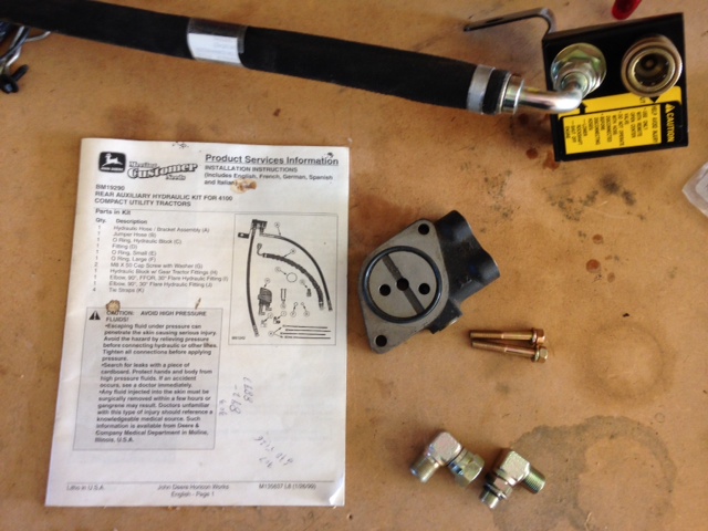

Ebay listing will go live this coming Friday with an item heading John Deere 4100 Tractor Power Beyond Kit BM19290 Components.
