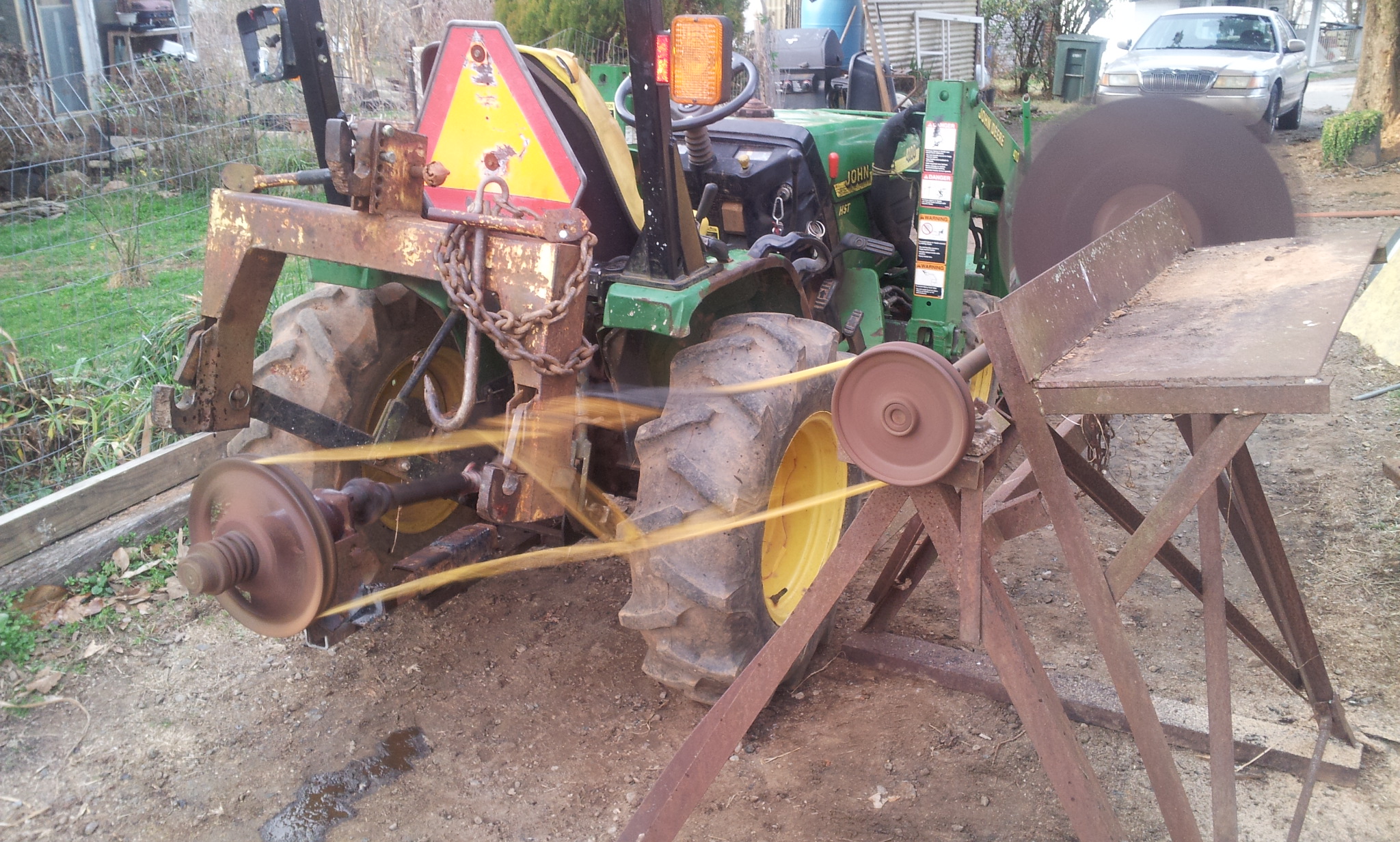

Thought I would share a 45mins project I did today. The saw was one made by my Pops back in the 80's. The JD is the one I will be doing the Hydraulics Mods on. The shaft to the pulley attachment was found at the local Scrap yard for $1.35. The Pulley attachment came from a old sickle mower from years ago. Last night I decided to make an attachment to the draw bar with a receiver tube. This way I can use any of my hitches on the JD. Then it hit me.. be nice to have an attachment for power the saw, the cement mixer and a fan I found not to long ago that runs off a v-belt as well. First cut was with a simple yellow rope for the belt and it tore thru a 4x4 piece of green red oak in no time. Now to find a proper belt and sharpen the blade. 20121211_154853.jpg
