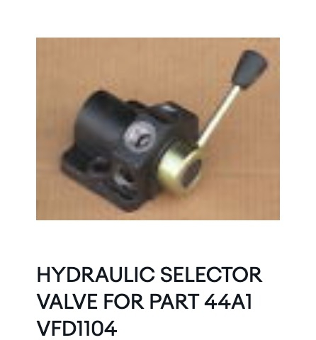

Hello, I hqave a MF231. I recently purchased MF 232 loader and am trying to tap into the internal hydraulics to power the loader. I purchased a hydraulic selector valve but it doesn't have a return port back to the selector valve form the loader control valve. The 3 ports shown only supply 3 options for pressure as far as i can tell. Can anyone help me with a place on the tractor hydraulics case or transmission that i can hook my loader control valve for the hydraulic return? Or is ther a better diverter valve i should be using? This vale replaces 180908M1 INTERFACE COVER PLATE WHICH IS LOCATED ON THE HYDRAULIC LIFT COVER. Thank you for any help!

Did you ever get this figured out. I have a 240 with the valve and the pump seems good but the valve does not send flow to the MF232 loader.

Is the draft lever all the way up and position control lever in constant pumping? That's how you fool the pump to supply externals.
