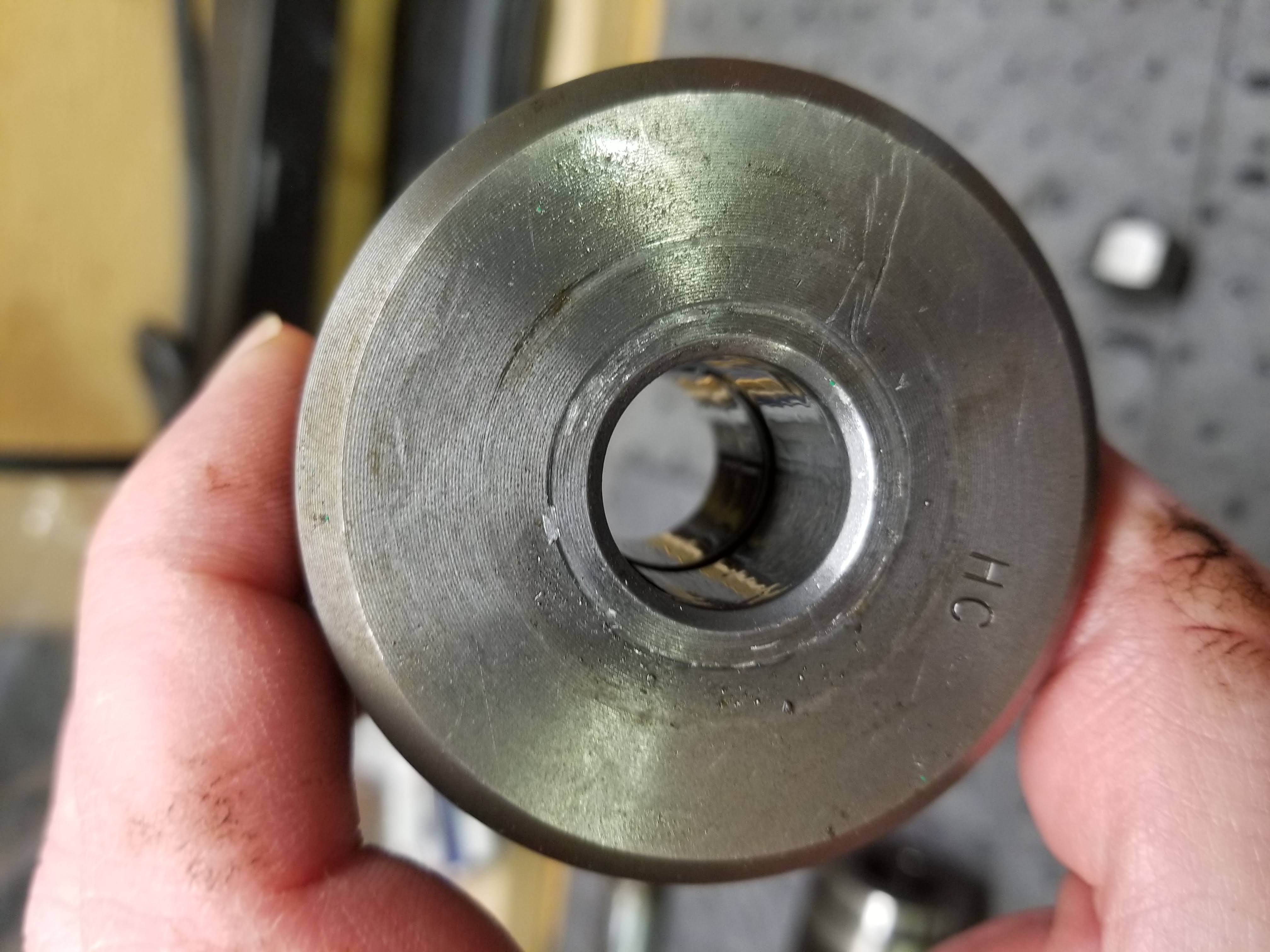

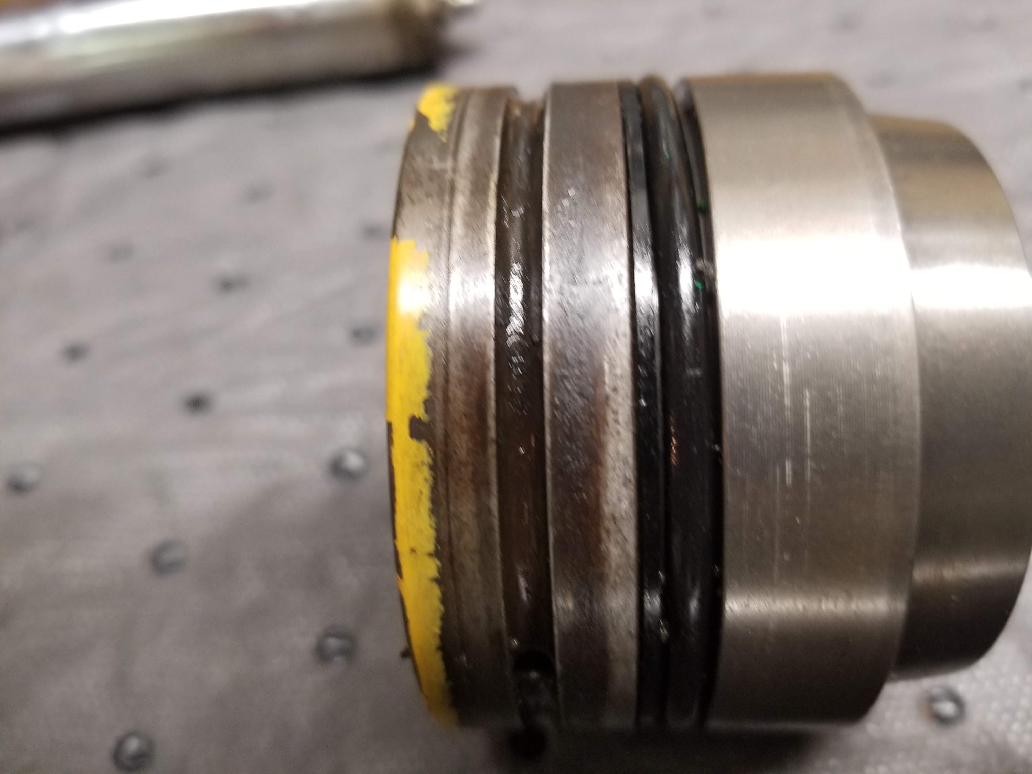

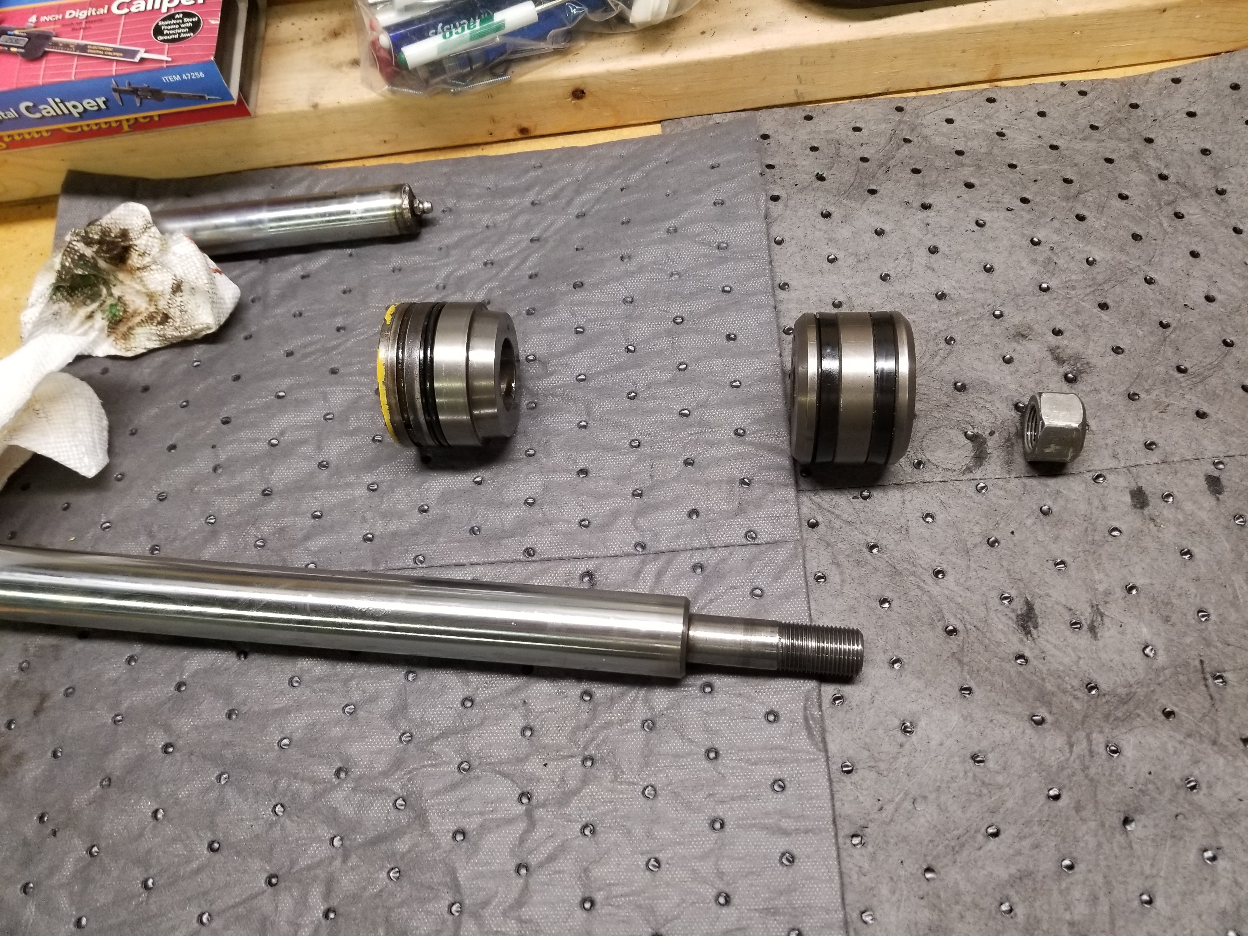

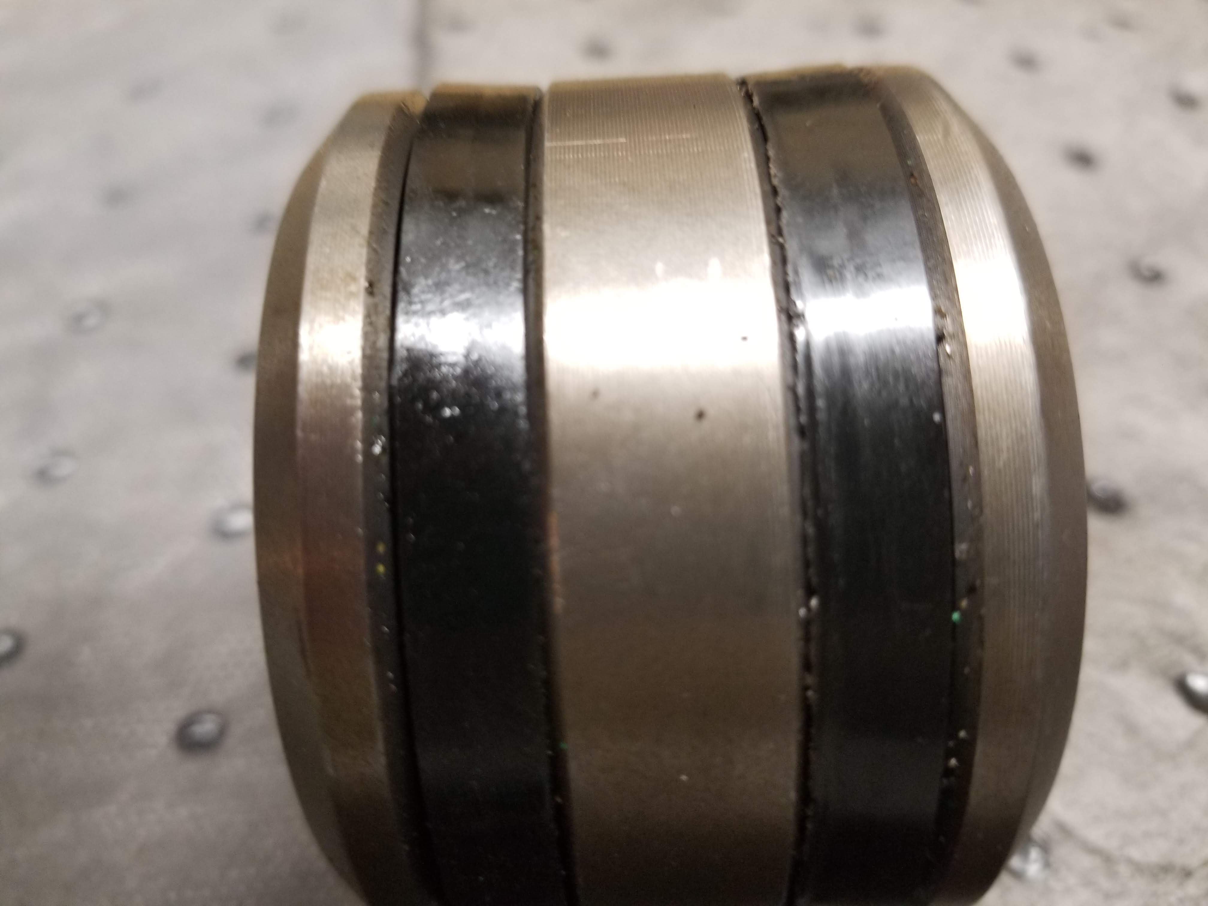

A few pictures of the Cylinder guts just for reference:

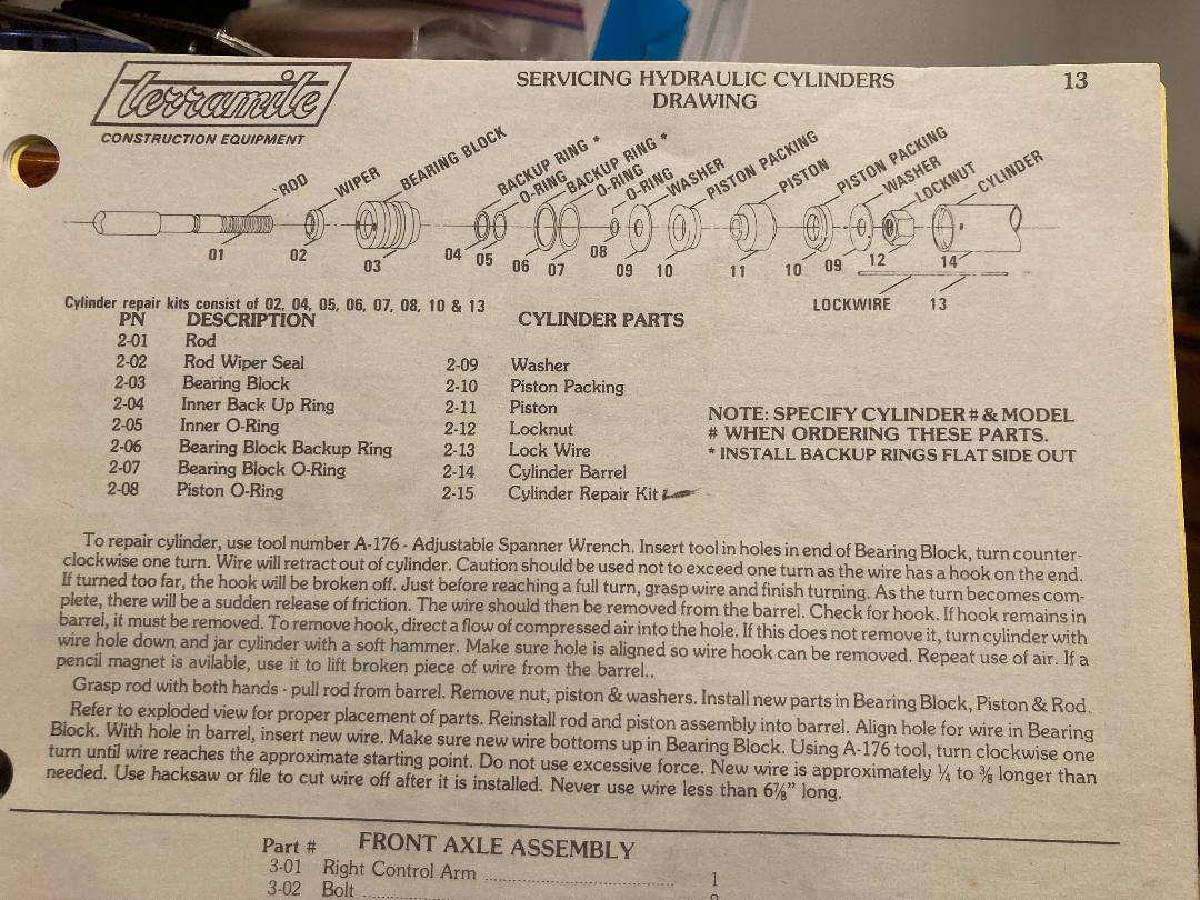

Ok, some good advice. I'm working on a T5B and would like to repair a couple of the cylinders, especially the front bucket seals. Without going to a "Terramite parts" dealer, how would I go about coming up with the correct replacement seal kit. I do have the Service manual with a full description of how to disassemble/assemble the cylinders which will get me through the process. Hope the picture might help someone else along the way.
Do these directions, old as they may be, apply to a specific Terramite models or years these models were produced? Does anyone know where this attachment came from? Thanks!
   / Adding Lucas hydraulic booster and seal conditioner to a terramite T-5c hydraulics #20
All I can say is that this is the manual that came with the T5B. I would only guess that it would apply to other models they produced at the year ours was built. I also have a parts manual for the T5C model and they had made several upgrades, parking brake, power steering and i believe the seals changed some where with the T5B.
