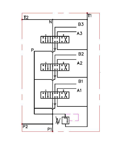

As I finally close in on finishing the Top and Tilt add, I think I want to convert my mechanical thumb to hydraulic. I found several threads here on exactly that, so I got the gist of it.
I ordered a single spool open center mono block valve, with power beyond, from Summit, thinking to use that. After some thought, planned on mounting it on backhoe, "in line" with the existing BH lines (before or after seems to be just a matter of my convenience), but, since this valve requires a Tank line, I paused realizing the BH itself has no Tank line. That seems to be done in conjunction with the 3pt hitch "maze o' stuff" where I see what appear to be two Tank lines. I guess to do with selector position. Not great at reading hydraulic schematics.
While can run a Tank line (gotta add one anyway for the TNT) and just use two smaller Quick Couplers for when I need to dismount it, it "would be nice" to find a valve that does not require a direct tank line.
Is there such a thing? I was gonna refresh myself on open center vs closed center but am having too much fun playing with fire in the form of plasma cutting and mig welding the valve mount. I'll hold off on the bulkhead until I figure out if I want to allow for a future coupler, based on what I hear back.
I even hear of people adding a section to the BH modular (?) valve, but that seems WAY beyond my skills and budget.

The "tank" line continues to cause me confusion. It seems the valves I have, for this and a Top&Tilt, from Summit Hydraulics, and most others from what I can see, have a Tank line even with the PB adapter installed. Still, reading some threads here and elsewhere seem to say this may not be the case. While I don't doubt Summit, it still leaves me confused.
In any event, I will go ahead and plan on installing a return to Tank line, hoping to find a convenient place to T in, but have questions. I've been told there is very little pressure on that line and it does not have to work line a plumbing drain, that is, working by gravity. So there must be "some" pressure, surely?
Also, no mention of what flow rate, hence what size line or hose should be used. I don't want to overspend or overbuild, but, since I have no clue, gotta ask.
Thanks.

That is kind of what I thought early on, but when I did some asking around and other "research", some said, including the vendor, that Tank must go to tank in all cases. Some mentioned some valves are not built to handle full pressure everywhere internally. I just accepted those statements without really thinking about it, but remained a bit puzzled. Only have the schematic (below) to go by, no idea of the valve internals. I would tend to think the PB should block the T ports (goes into "N") otherwise it would "short" the next in line, but who knows, maybe they are concerned about leakage past internal seals?
I suppose I can hook every thing up with a temporary line from the Tank port to the tank fill and see what happens when I fire it up. If nothing comes out at "center" I
can put the implement through a couple of cycles and watch for any fluid out.
The diagram is for a 3 spool, but same for all, I guess.

No. That's not correct. I see the problem. Assume that the PB is not involved in return flow. In fact, begin by considering a spool valve assembly that doesn't have a PB at all.
Instead, think of it this way: Every valve assembly - in fact every spool valve within an assembly - will have its own return path which is opened by the movement of the spool. Moving the valve spool always does two things simultaneously - it provides pressure to one end of the cylinder and also provides a return path for fluid from the other end of that cylinder.
To help visualize this, think on what it means when you are not moving the spool valve. When the spool is centered, the oil that is going to become the return oil is trapped in the cylinder because it cannot get past the spool valve to go anywhere. In fact, that trapped oil is helping to hold the loader arms and bucket from flopping as you drive.
Now take another look at your valve schematic. Follow the arrows inside the schematic as the spool valve is moved back and forth. You will see that the arrows are dead-ended until the spool valve is moved laterally. Unfortunately, hydraulic schematics almost never illustrate how the ports line up when the spool is moved laterally. I wish that they did; but you have to either draw it out or use your imagination.

No. That's not correct. I see the problem. Assume that the PB is not involved in return flow. In fact, begin by considering a spool valve assemble without any PB.
Instead, think of it this way instead: Every valve assembly - in fact every spool valve within an assembly - will have its own return path which is opened by the movement of the spool. Moving the valve spool does two things. It provides pressure to one end of the cylinder and it provides a return path for fluid from the other end of that cylinder.
To help visualize this, when you are not moving the spool valve, the oil that is going to become the return oil is trapped in the cylinder because it cannot get past the spool valve to go anywhere. In fact, that trapped oil is helping to hold the loader arms and bucket from flopping as you drive.

Just to drag this out a bit more, by "do both" you mean "both", not "either", correct? That is, even with the PB sleeve, which I have installed, it still needs the tank?
That said, the sleeve looks like it would block the internal passage from the P port (pressure supply) to the T "channel", leaving the T ports still open and connected to each other internally as well as to the relief valve outlet.
Does that seem reasonable?
/ adding hydraulic thumb kubota B21 #19
It entirely depends on the valve.
I know (because I have one in hand) that W.R.Long sells a 3rd function valve with ONLY 4 ports - NO return to tank. It's generally mounted up right by your FEL valves. This valve would be perfect for your application; put it "in line" with your backhoe. Also, call them - they are the MOST helpful company I've dealt with. If you are still confused, ask to speak with the founder's son (I did, he was very knowledgable).
Other valves do require the atmospheric port. If it requires it, it requires it. I happened to talk to Summit today, it turns out ALL their valves DO require Tank. Sounds like a call to W.R.Long is in order for you :)
keep in mind - if the valve has an overpressure, it WILL require an atmospheric pressured port (eg 'Tank') - otherwise, it would be impossible for the OP valve to function!

You last sentence pretty much sums it up.
I do have a WR Long solenoid valve at the FEL for the 4 in 1 bucket. It is an HVAIR D03S-2C-12D-35. Even has a metal tag with the schematic on it.
It does have a (marked) T port that seems to function as the PB port, which goes to the BH/3PTH. I think that is what set me down the path of wondering if I needed a Tank at all. Short answer, yes, I do, for the valves I bought.
BTW, that valve does specify "High Tank Port Pressure: Up to 3000 psi tank port back pressure", so, I guess that explains some of the other comments I've gotten over the course of my roller coaster ride of "learning hydraulics".
