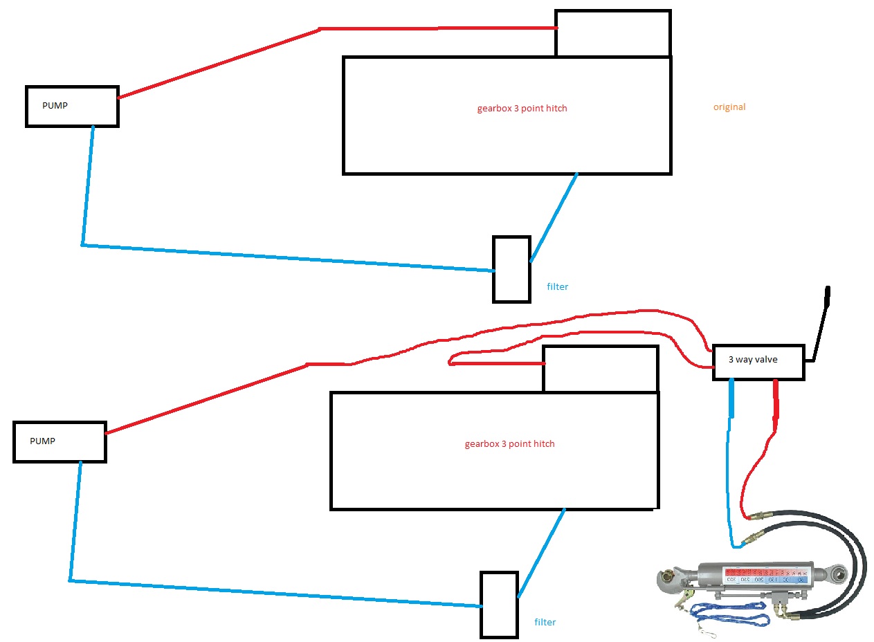

Hi,
I have an Hinomoto E1802 it is very similar to ferguson 1020.
I have no hydraulics and want to add a simple 2way on the back of this tractor.
Is this possible ?
can somebody pin point me in the correct direction? some pics would be nice!!!
tanks

Steiner lawn tractors used a front pto to drive a their implements. One of the implements was a front 3 gang reel mower that was hydraulically powered. The pto turned a hydraulic pump which ran a pump which ran pretty much everything on the mower, including a cylinder to raise and lower it. A friend had a B6000 grey market that didn't have hydraulics and we seriously considered robbing the Steiner mower to get the belt driven pump, tank, cylinder to add to his tractor.
All it would have taken was mounting the pump on the engine since it was belt driven.

i've made this drawing is this possible ?
/ adding hydralics #7
Need a relief valve. Sometimes they are incorporated into the SCV control valve, it would then require another line to route bypassed oil back to the sump/transmission.
