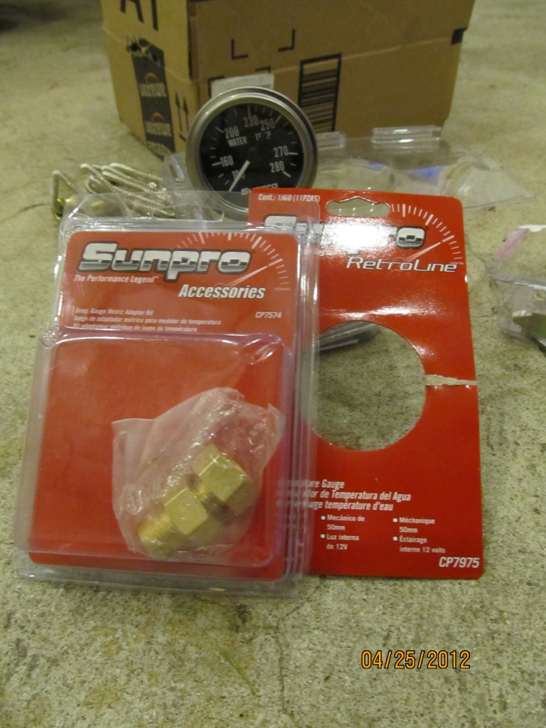

I decided to add a temperature gauge to my new YM2210. Here is what I chose:
Sunpro 2" temperature gauge CP7975
Sunpro metric adapter set CP7574
I chose this gauge because it matches the look of the stock Yanmar tachometer pretty closely.

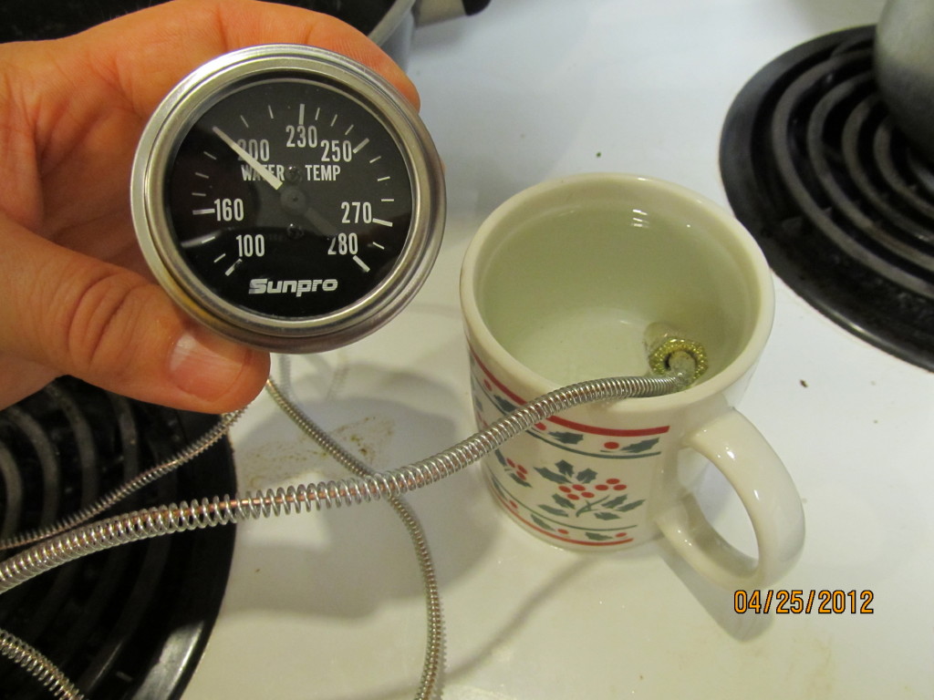

The first thing I did was test to make sure the gauge was operating properly. I boiled some water in a mug using a microwave then put the temperature sensor in the water. The gauge read about 201 F. Obviously water boils at 212 F, but I think 201 is pretty good given that the water starts cooling as soon as you pull it out of the microwave plus the sensor itself cools the water as soon as you put it in.

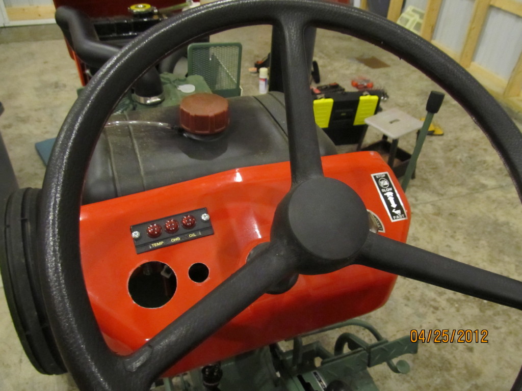

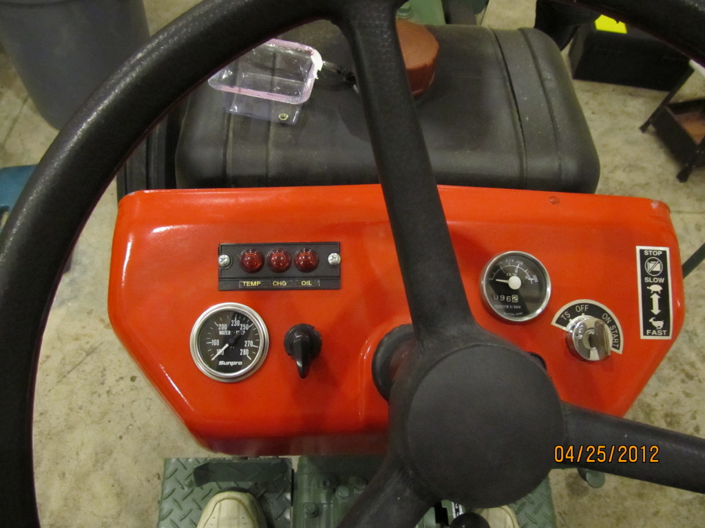

Next I punched a nice hole in the dash using a hydraulic Greenlee metal punch. I decided to put the gauge where the turn signal switch had been and move the turn signal switch to a new hole. I had to touch up the paint a bit at the edge of the holes. It was mostly hidden by the gauge overhang, but I did it anyway... :D
Next I pulled out the bolt with the old temperature light sensor and installed the new sensor line into that hole using the metric adapter. I didn't use any teflon tape on the bolts. If I find that it starts leaking, I will pull it back out and add some. Lookin good! :thumbsup:
Note that getting the old temperature sensor bolt out is a bit of a pain because it's in an awkward spot that's hard to get a wrench into. I took off the left side panel (looking from the driver's seat) and reached in with a pipe wrench -- btw, this worked well to break the bolt loose on my YM1700 too.
I ran my engine for a while just sitting in the barn, but it didn't register on the gauge. I put my hand on the engine where the temperature sensor goes, and it was warm, but not hot, so I think it just wasn't hot enough to register. I expect it will register when I'm actually working the tractor. It's pretty impressive how much better this engine cools with the water pump installed vs. my YM1700 which uses the thermosiphon approach, i.e., does not have a water pump.

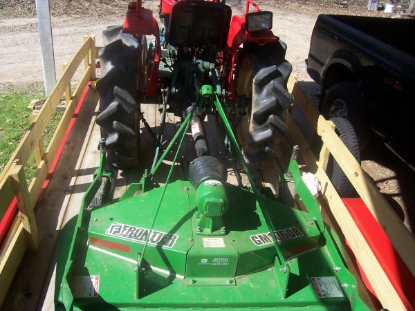

That's to hot IMHO. I would be putting a thermometer in the Radiator and get a exact reading of the Water Temp. In AL. average temp was around 50 Deg. in Dec. about the same here in Ga. I run a 5' finishing mower "alot" during the Summer months and my Radiator never gets hot. Last I checked 195 was about the hotest I ever checked it in 80-90 deg. weather. No reason to even bother with a temp. gage running that cool. Now I've had it 4 yrs. I just put my hand below the dash and can tell how hot it's running.;) here's a few pic.s of my Mower. And the JD. I use monthly. Still Big on Grn.;)
