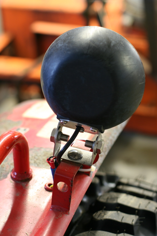

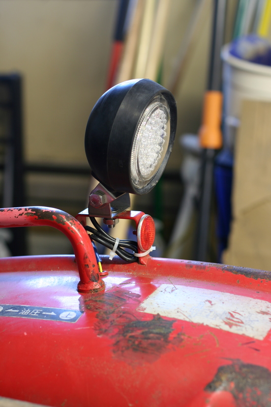

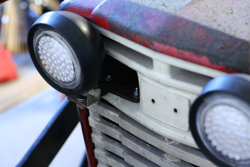

/ Adding extra lights - YM1700 #5
I put four of these lights from Northern Tool on last winter (they were $5 cheaper then, too). They only draw about 1 amp each (or about 48w for all four). The factory headlights in my 1510 are only 25w each, so I replaced each headlight and then added two rear-facing lights to the same circuit. The LED headlights are noticably brighter than the incandescent headlights were, and the four together draw about the same power as the original headlights by themselves.
The headlight switch on the 1510 has two "on" positions (old headlight bright and dim settings). I'm thinking when I eventually get a ROPS I'll mount another set of lights on that and put them on the second "on" position on the light switch, so I can switch between "lower" and "upper" lights.

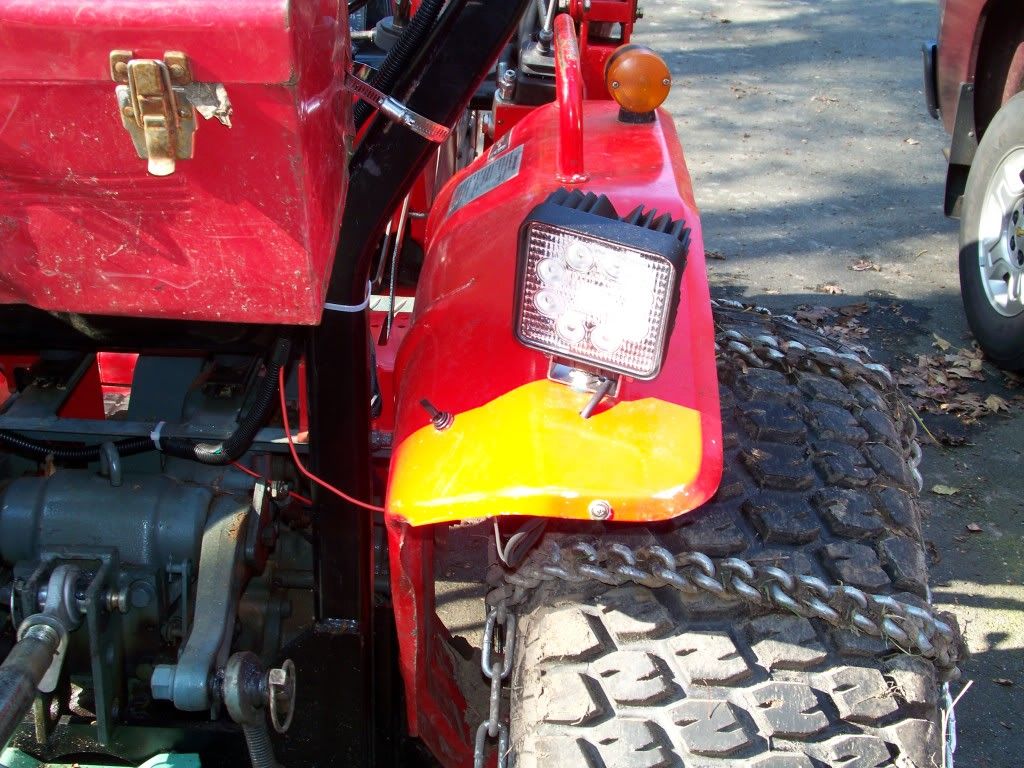

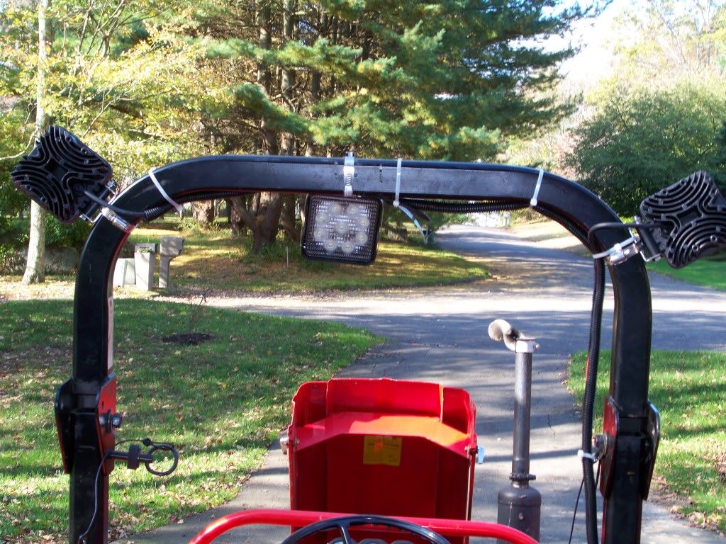

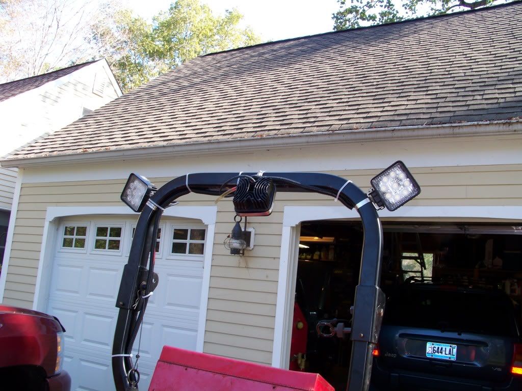

/ Adding extra lights - YM1700 #10
Here are a few shots of what I ended up doing. I ripped off one of the lights (it is now under the ROPS) on the header under my deck becuase I forgot to fold down the rops. But this situation gives a lot of light and should not over run the 15 amp dynamo
