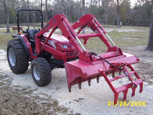

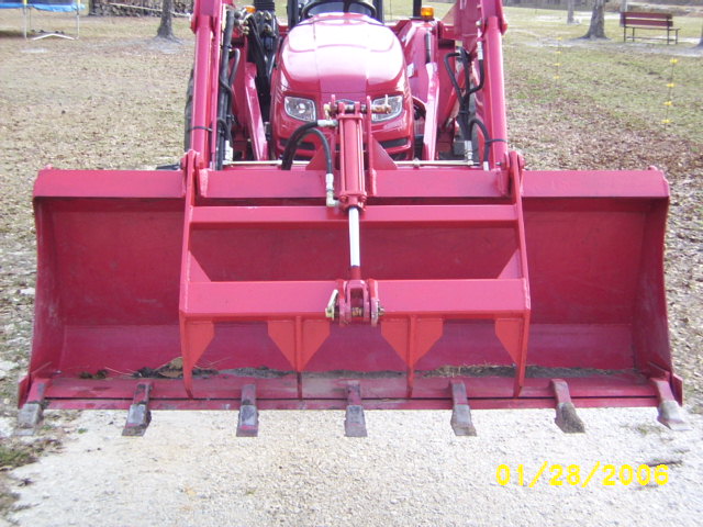

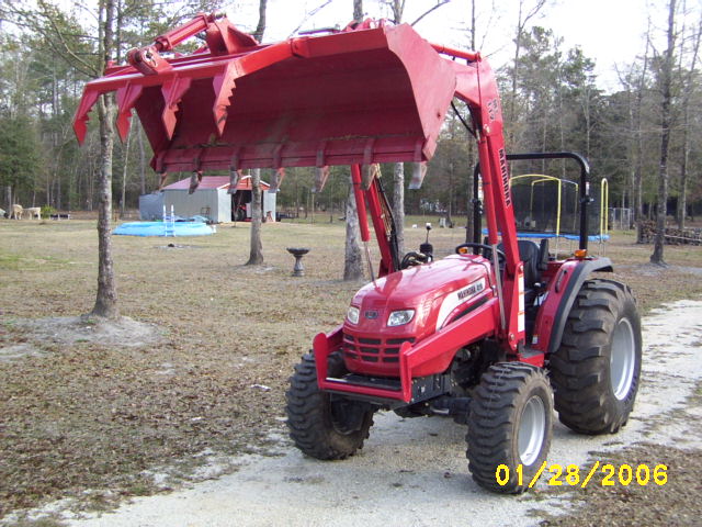

here is my 4110 with homemade grapple......and I bought the toothbar, you will have to beef up the upper lip and top of the bucket or it will bend, I used 3/8 flat stock on mine, I'm also using my rear remote for grapple function, let me tell you the grapple definitely comes in handy for brush-debris cleanup....you can also see more pics and closeups in member photos section of forum just enter my screen name mlitt12345 in the search box......good luck with the grapple.....mlitt12345
Hi Mlitt12345. Thanks for posting those pix and the description of your arrangement (especially the reinforcement details). That is one SWEET looking homemade grapple! Darn thing looks about as stock as stock could get! Want to sell it??? :D
I love the tooth bar too. It completes the look and must enhance the functionality too. I will be sure to check out your other pix. Incidentally, after seeing a few badly bent tops on Mahindra FEL buckets, I was thinking of reinforcing the top edge anyway... but I was thinking angle iron (or even C-channel to get that front drop edge) for maximum stiffness/strength. Is that not a good idea?
That is a nice looking grapple!! What was the build cost, if you don't mind me being nosey?
The upper lip of the bucket is definitely in need of beefing up. I bent mine when I raised the bush hog up, while it was on the back of another tractor. The tailwheel bound on the bucket and I had a chain hooked to the hog on the center hook. I figured I'd get a piece of 3/8 thick angle and reinforce it.
Yes 3/8 angle will work fine for reinforcing the bucket lip, I used flat stock because it was some I had left over from another project....A friend of mine helped me build it, the biggest expense was the fittings, hoses (long run from rear remote) and hyd cylinder.....the steel was mostly left over from other projects mostly flat stock and square channel......I did have to add a orifice inline to slow the grapple down it was too fast without it.......total price $350-400 give or take, can't remember exactly but much cheaper then a store bought grapple and alot lighter then a root grapple bucket.......mlitt12345
