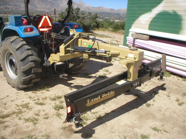

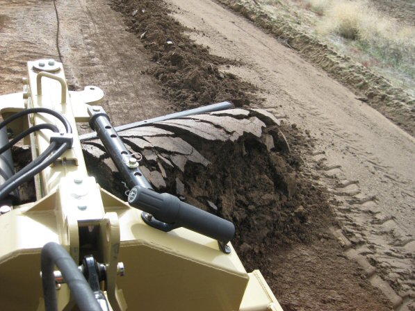

You are suppose to have the relief valves, just a safety factor. I have a Land Pride RBT45108. I bought it without the cylinders, I don't care for the tie rod cylinders that they come with. I put my own welded cylinders on without any cushion valves. No problems so far, going on 5 years. It's all up to you. If you are going to really work the blade, the hydraulic with the smaller rod has a better chance of getting bent. Use what you have, maybe get some new hoses. If a hydraulic become a problem, get a new one then. One last thing, DO NOT RUN THOSE WATER PIPE FITTINGS. :shocked:

Brian, that Land Pride looks almost identical design wise to my Woods. Here's a shot of mine after I removed the hydraulics and pressure washed it:
