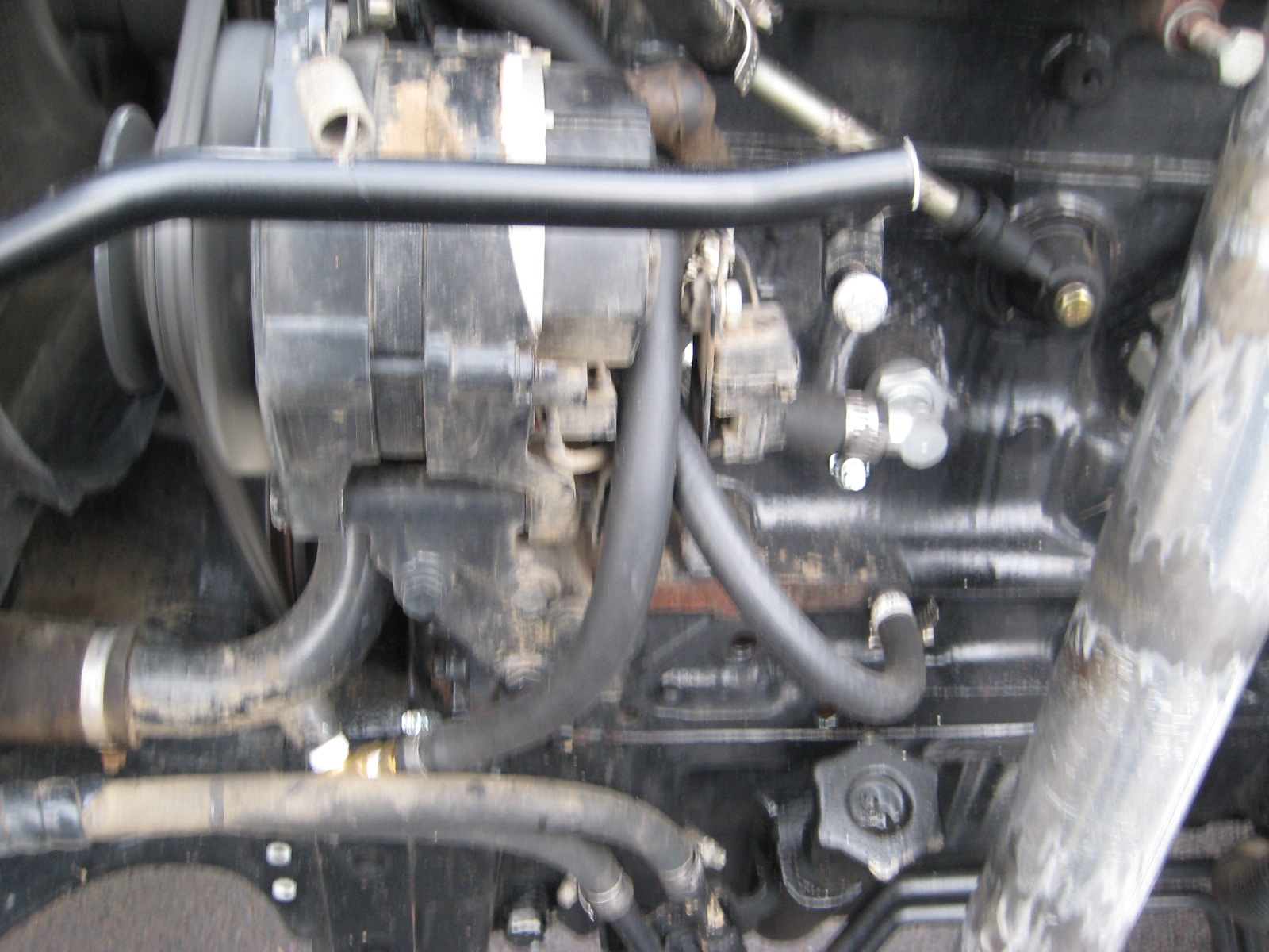

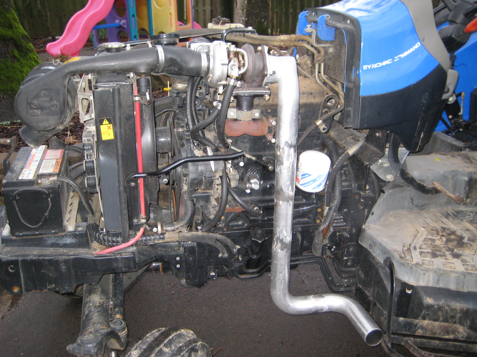

I have been working on this project off and on for a week now and I am almost done. I got the turbo from a friend. I think its off a newer Subaru, but, he won't tell me. All the fittings were from the local auto parts center except for the water fitting going into the block, oil drain adapter and tube. I didn't turn up my injector pump and don't plan on it but the tractor is a lot more responsive then what it use to be. I am now waiting for my wastegate. It was suppose to be here today but now, I am hoping tomorrow.
I have 2 tabs to weld onto the piping for support and then, a little black paint!;) Also, I am not too happy with the way the rubber hose on the intake side is buckling and I might change it. Any suggestions?
I would like people to point out anything they would have done differently. My engineering skills kinda stink and I am always trying to improve them.

The install looks pretty clean with the exception of the intake hose, which likely has enough cross section to allow adequate air flow. The only thing I can suggest here is a offset made out of steel and a smaller piece of rubber on each end.
Most factory turbo installs have nice radiused corners on the exhaust, the first elbow out of the turbo looks pretty square. Turbos installations need free flowing exhaust because the turbo itself is enough of a bottle neck. Your elbow has a large diameter so restriction may not be that bad.
You should have provisions for a boost guage so you can see the net results of you labours. Also possibly a pyrometer to be sure you fuel curve is not to rich and runs too hot.

Three words,
Pyrometer, pyrometer, pyrometer.
You really must use one just after the turbo to tell if the engine is hurting it's self. 1200F is about the hotter you want to ever see. Short bursts of up to 1400F if the pistons have bottom cooling (your's probably don't).
I question the exhaust pipe outlet being close to what looks like plastic. That pipe is probably going to get hot, if not dern hot, maybe even really hot. You may be able to just wrap it with some exhaust insulation like the hot rodders use on headers.
If you can get a steel pipe with a double kink you may be able to use that with rubber sleeves on the ends for the inlet.

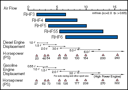

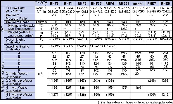

I will start off by admitting that I didn't do any research on this turbo but I now know its a IHI-Turbo, RHF5 VF40 off of a 06-07 Subaru legacy. I have uploaded charts for it below. I got this turbo in trade for some work I did for my friend, about $75 dollars worth.
The wastegate that was on it had a 10PSI spring but I ended up twisting the rod when I had it off, which, broke the seal. The spring is just to hold it closed for to time being. I barely go above idle if I need to move the tractor. I bought a new wastegate that has a adjustable rod, which has a minimum of 7psi.
I realize that I have to increase fuel to get more power but without the turbo, the tractor felt a little sluggish. Now it seems that the rpm's climb quicker, but then, maybe its all in my head.
The exhaust is 2 1/2 inch tubing. Do I need more then that?
I don't want to make it sound like I am a know-it-all, and i'm not but I have done reading online (reading, no hands on experience) on Powerstrokes, Cummins and Duramax's. From what I have read, going with a bigger turbo or going twin will lower you egt's.The VF40 is bigger then the factory turbo's on the TN75 by quiet a bit. Also, the VF40 is water cooled and oil lubricated where the TN75 only has oil. Without a intercooler, how many psi would be safe? I do plan on getting a Pyro meter and boost gauge, but if I only run 7-10lbs of boost, do I have to worry about it?
Sorry for all the questions and my stupidity, but all your input and advice has helped me a lot and is very appreciated.

I looked at the parts manual for the TN65 and TN75. They have the same cubic inches but the block, pistons, rings, and others parts are different part numbers.
The reasons why I don't trade up? There isn't any used TN75's around my area and I couldn't afford one if there was. I am 17, bought the tractor just recently with cashed saved up for $10,500, which, I would like to ask if anybody else thinks that was a deal. I included the dealer pictures below of the tractor. Once I get the turbo done, I will get better pictures. The newest tractor that I was able to find for a price close to mine was a 1995 CaseIh with 4000 hours, they had it listed at $11,500 and I have been looking for a few months.
I like tinkering and especially modifying things. There's no such thing as can't in my vocabulary. I usually tear into something before I actually know what I am doing and it bites me in the butt most of the time. Someone once told me, the best way to learn is to just do it!
Scott, Thats a impressive car.:cool: It must have been exciting to build it.
To get back on the subject, The TN65 is a 179ci engine putting out 65HP. You asked if I can hear when it loads. What would I be trying to hear? Would that be when it starts to whistle? It does whistle at higher rpm's.
I tried but couldn't figure out the air flow part on those maps. Do you have the link to the website you mentioned?

Well, I just saw your pics of the recommendations by IHI on turbo applications, for just "picking any old turbo" you got pretty lucky, that turbo is great for your application if perhaps just a little too big.
IHI does a decent job of recommending "power ranges" and your tractor falls right in the lower end of recommended diesel applications for that particular turbo.
Usually guys don't even plumb the water lines, on a tractor it might be a good idea though... I think your fab work is fine.
Here's a map for the IHI units:
I'd recommend getting a boost gauge and perhaps weakening the wastegate spring (cut a coil? make it adjustable? should be pretty easy) to get the max boost down to a low level for starters (so you don't hurt anything). Then find out what PSI it boosts to (a boost gauge is cheap! few bucks from a parts store for a basic fuel pressure gauge would do fine!) loaded, and unloaded at higher RPMs.
I think the wastegate is big enough on that turbo that all you'd need to do is have it open sooner, at lower boost pressure. You are going to have to watch EGTs, there's no two ways about that - Autometer's decent EGT setup with gauge is like $160, there are cheaper ones out there or go used and get a replacement thermocouple for $30 from Aircraft Spruce.
Anyways, before using it you need boost pressure control (wastegate) and EGT monitoring. Start on small boost. The wastegate shoudl be big enough to let you regulate as low as 2-3 psi.
Set that up then get back with us, and we'll make sure it's working to help and not hurt the motor,
