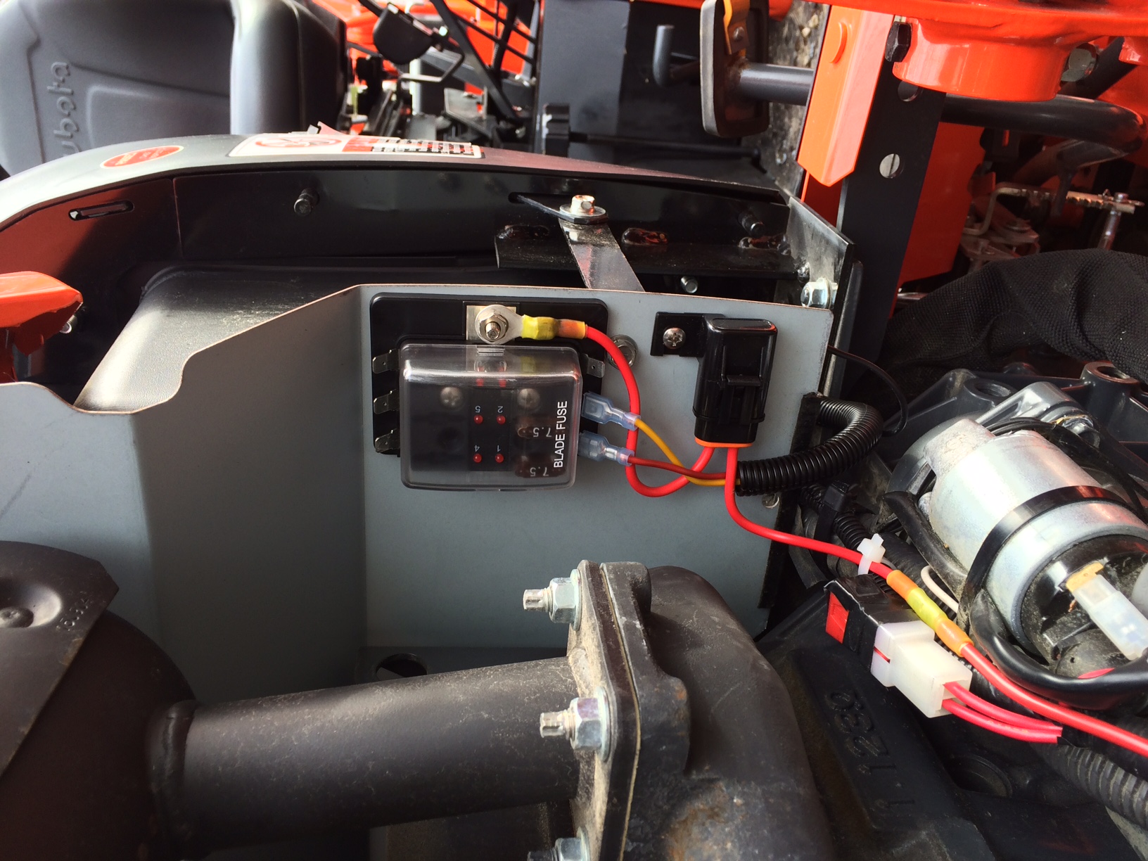

As I understand it, that is what he's doing. He's just looking for a clean way to get key switched power to trigger the relay.
Aaron Z
Yup, pretty much copied http://www.bodenzord.com/archives/579 & put it in the head liner. Have a 60@ relay & fuse block mounted up front. I spaced out the accessory plugs in back, but as I ran smaller wire to run the relay & want to keep it looking nice with all the fuses in one spot. Well 2 if you count the aux fuse box. The 5@ radio circuit fits the bill nicely & my 18 gauge wire wouldn't need another lower fuse.
Gonna pester my dealer's parts guy tomorrow when I call em about some other stuff. See if they have any answers on those connectors.

The relay only needs about 0.0160 amps or 160 milliamperes to "switch" or "excite". Most anything under the dash will work. The accepted way to do it is with one of these-
Quick Splices - 18-14 Gauge
The better way would be to use one of these-
Mini Low Profile Fuse Adapter
To find a switched wire poke around with a test light or volt meter. Just start poking until you find the fuse that does what you want. It should only take a few min to find.

Give one of those fuse taps a try. No splicing and a clean install. Most parts stores stock them.

I think you guys aren't understanding how the product I linked to works. It piggybacks an existing fuse. No splicing, no mess and no hassle.
Simply test the fuses for one that does what you want (switched power), pull fuse, install this device, reinstall the fuse and off you go!
Maybe the video will help visualize-
QUICK TIP: How to install an add-a-circuit for your gauges - YouTube
The added switched circuit would then "switch" or "excite" the relay the OP wants to install. From there it would go into an aftermarket fuse panel and or directly to the devices he wants powered.

If you didn't want to add a fuse you can tap an existing fuse with one of these.
ATC & ATO Fuse Tap
These aren't as common locally. They work by attaching to the load side of the fuse. If you use the line side of the fuse the added circuit will not have fuse protection.

My fuse panel could easily be hooked to a relay to make the entire thing switched. I just didnt see the need, but it installs nice and clean and is weather resistant.Kubota Fuse Panel.jpg
