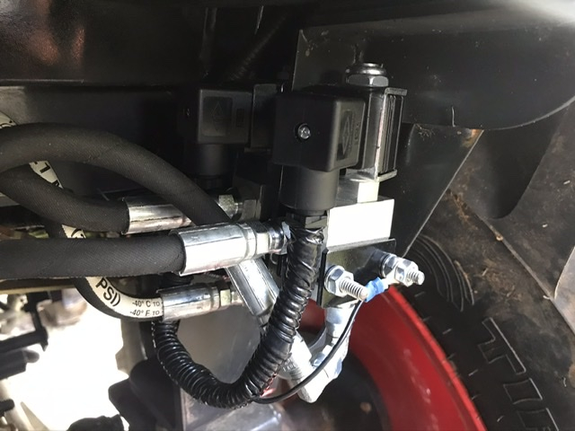

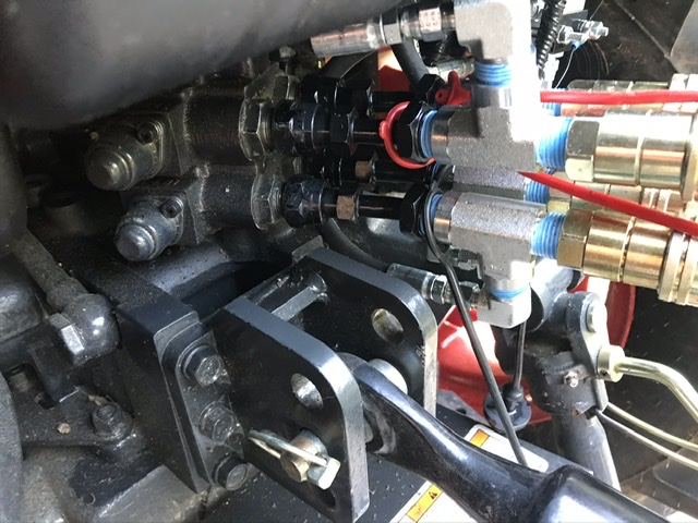

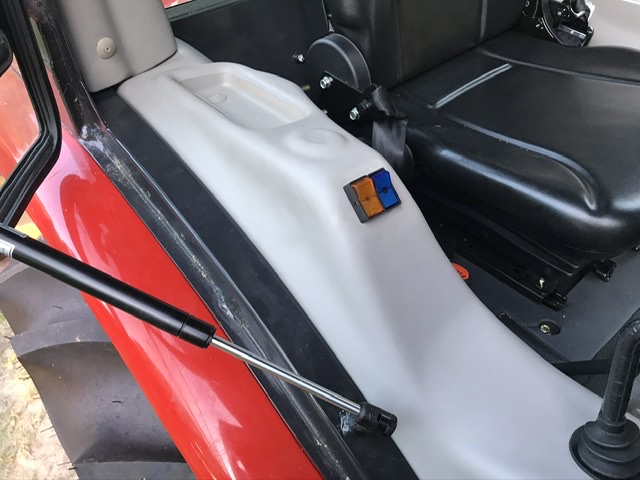

Absolutely want float with a verge mower. Float is not available on my Branson on the rear remotes so I came up with a alternative that works well for me. I added a hydraulic solenoid valve to tie the two ports together on the remotes.
I just raise the head vertical and flip the switch and the head lowers nice and smooth. Then it will float the full stroke. Makes it cut nice and even.

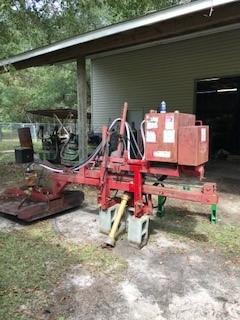

How far down in the ditch will that unit angle? This cutter head floats upward but is limited to going down and it will go down in the ditchbank up to 90 degrees. The problem comes when you hit something solid in the ditch, which would apply to this old cutter or new flails. I have a 10' Maschio slide flail as well.

He didn't specify, but I'm guessing he's going with a side shifting style ditch bank.
Like this one
goes 90° up(vertical) and about 60° down

Look at the volume differences between the rod end cylinder volume and the other end.
/ Adding a float function to my rear Remotes for a ditch bank mower. #18
So I plumb this into both lines and I spin the knob and it floats? Why would I need a line to go back into the tank?
If you want full stroke no matter where the rod is extended when you switch the valve. Just as an example, if you have the rod fully extended and then twist the ball valve, the rod will not move, at all. That is why you would always need to fully retract the rod and then switch the ball valve. If you are fine with that, you're all set. Otherwise the hoses need to be tied into a tank port so that the fluid has someplace to flow.
#19
OK, I think I can understand that. It looks like the guy using the solenoid setup on the Branson tractor, does not use a line going back to the tank (it looks like he simply ties the lines together), that must be why he specifies he puts it all the way up, hits the switch and lets it collapse back down.
Am I understanding this properly?
