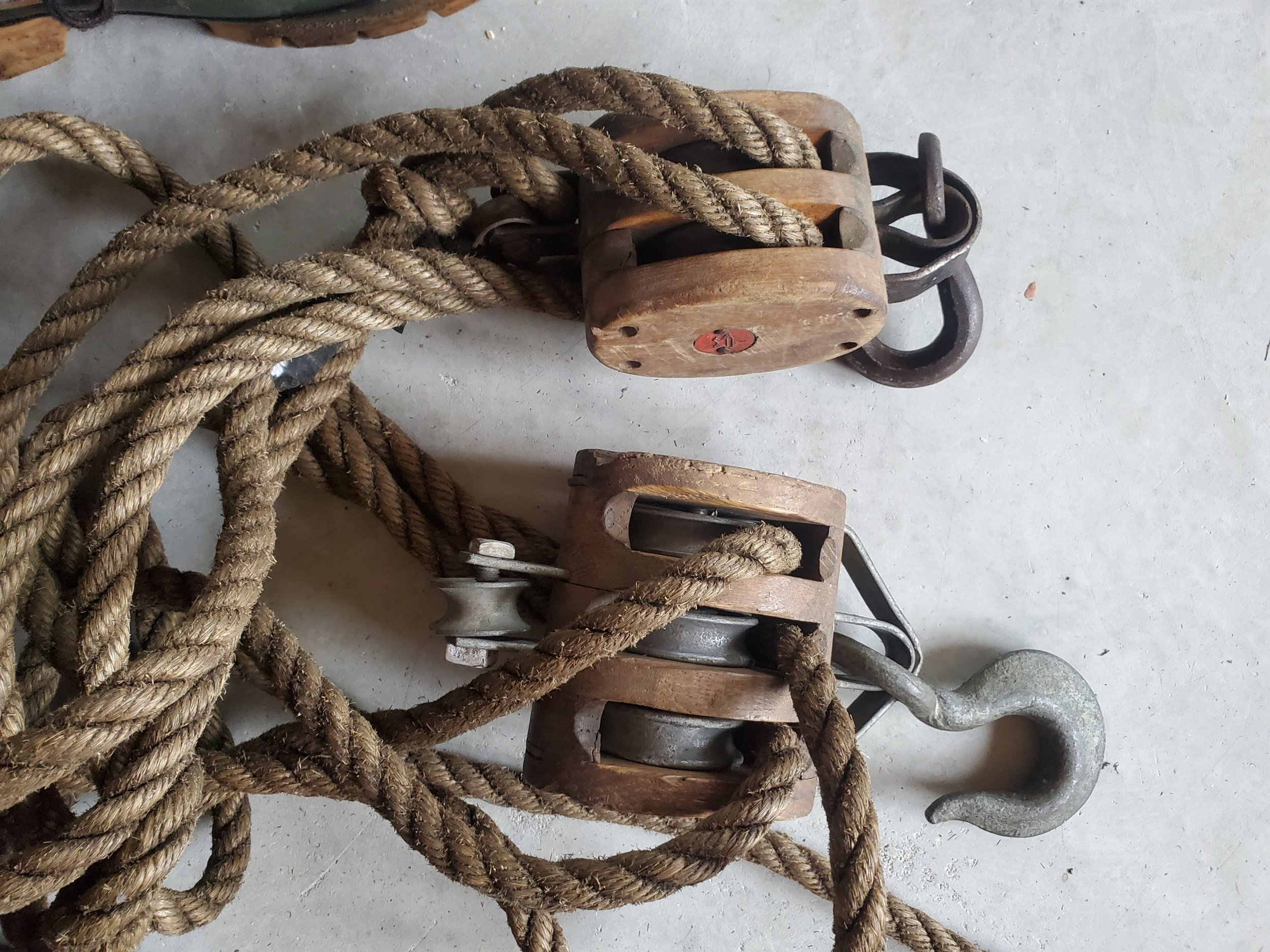

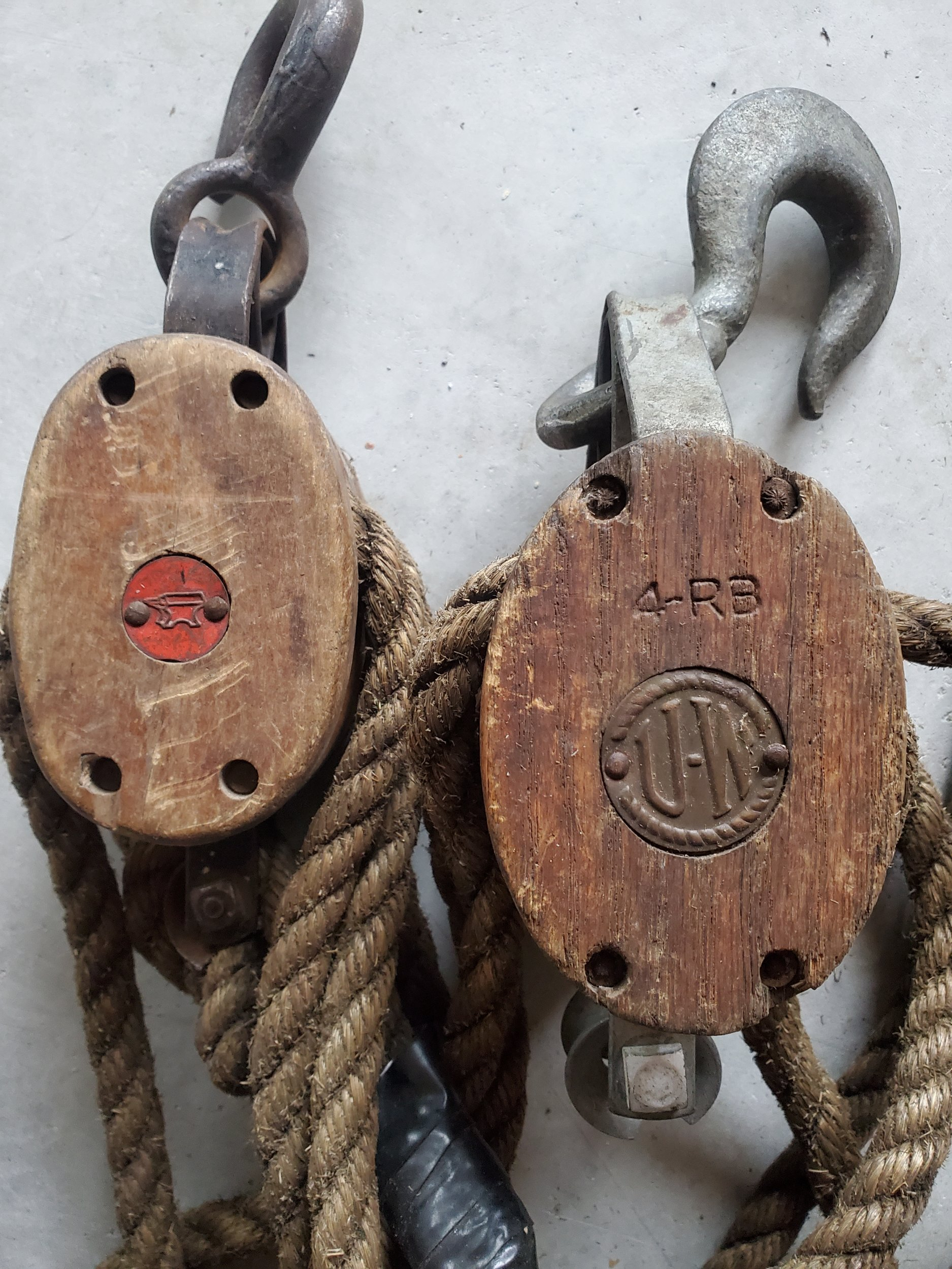

So I came across this set up, looking to use for dragging down logs as well as pulling a tree down that is leaning wrong way. Ropes look to be 1". Can anyone identify its possible rating? I have been using a comealong and recovery strap, but my anchoring tree is further away. Tree is a yellow birch? that is 16" at base and 40ish feet with minimal branches at top.

You will be disappointed with the way a 12V bumper winch will perform. Very likely to damage the charging components of your tractor also. A 12V winch is a recovery implement - not a logging tool.
Use chains, cables or ropes and snatch blocks.
