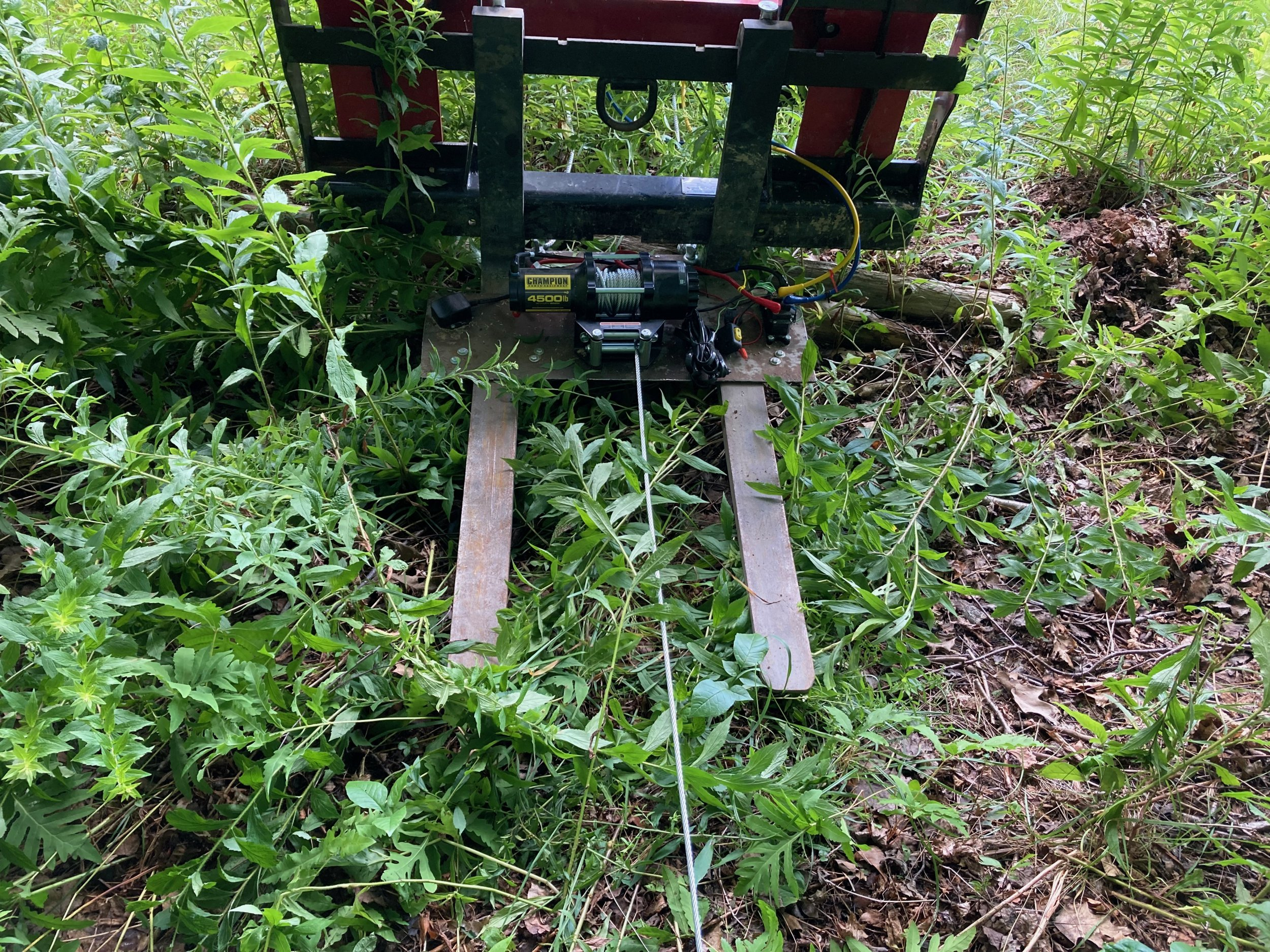

And for another, opposite, opinion. KNOWING it would be slow, I bought a Champion 4,500 lb winch at TSC. I chose it specifically because it has a wireless remote even though it has only a 35' cable. That way I can be up by the log being pulled to make sure it doesn't get hung up. I mounted the winch to a piece of plate steel with "keepers" underneath spaced for the forks. When mounted the plate is connected back to the tractor frame. In use the forks are on the ground, there is to stress on the loader.
Now why do this instead of pulling with the tractor? Well I do that too but when you have to get a log out and have no room to pull a distance, going back and forth with the tractor is a pain. On, pull forward, off, remove the chain from the drawbar and get it out of the way, back the tractor up, reattach chain, rinse repeat. I prefer to leave the tractor planted than dig ruts in the trail.
I'm not pulling full logs if they are large. Depending on the diameter I cut the tree to 8-12' lengths. I only winch those to the trail then can use the quick hitch as a logging arch to pull them to an open area where I can pick them up with the forks (no 3rd function/grapple) and carry them through the field back to the barn where I do the bucking and splitting.
Yes I have to pull the winch cable back out every 35' and reconnect it into the pulling line (12,000 extra low stretch line)/tow straps/chain (yeah I have a real hodge podge of stuff), yes it is slow. I leave the tractor running so the battery doesn't die. I've not had the winch overheat. I don't pull very many trees, just enough for winter firewood. If I pulled a large quantity I'd fork over for a logging winch, would love a nice Wallenstein, but for the amount I do the cost is not justified.

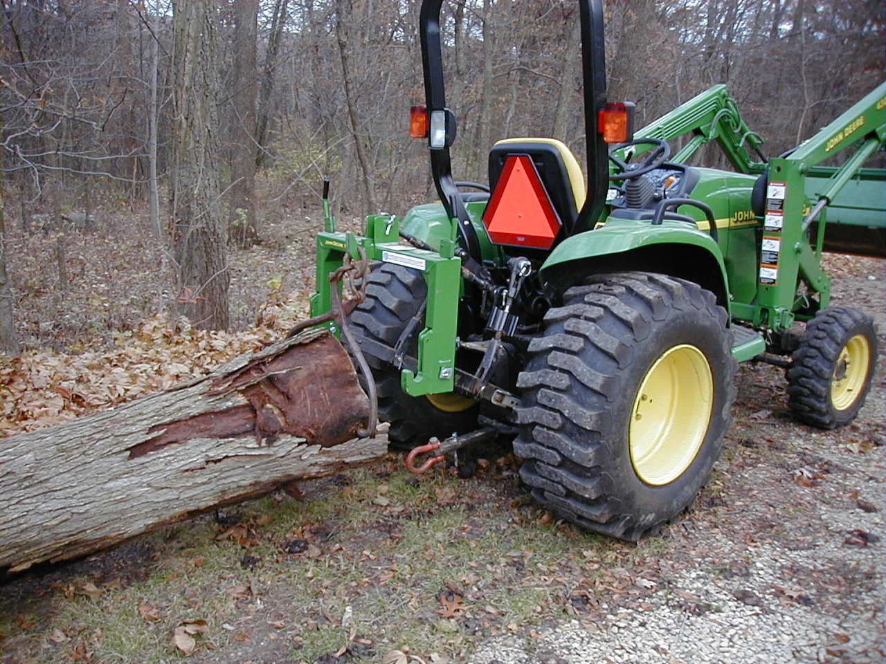

From a YouTube video on winching logs and such I made this up for my 3 pt. Had a large 30 inch log that I couldn't get traction due to soft soil layer and a slope. Took about 5 minutes to drag that oak log 50 feet. Used an old rear blade and cut it down to act as a holder in the ground.

With your tractor at the top of the slope, maybe use long straps/chains to tie onto the log. Then back up as far as you can, stabilize the log, re-set the strap/chain and back up again. Just keep doing that until the log is at the top.
I would pull from the rear. More pulling power, and wheel lugs are set for pulling forward, not backward.
Good to have a quick hitch on the 3 ph to hook to, for better traction as well.
Use a snatch block to help locate the position of the cable for the best pull.

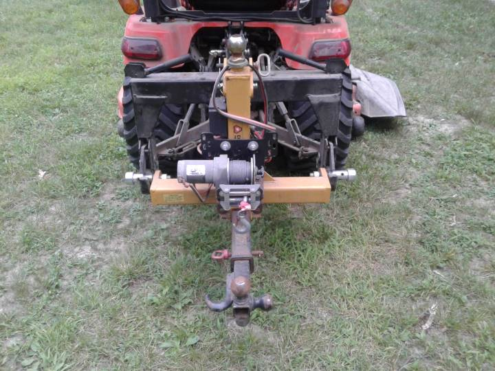

Not for quite the same purpose, but I installed a winch on the front of my Kubota ride on mower/lawn tractor. Despite the 4WD I kept getting stuck in the winter, and didn't have the tractor at time, so came up with this as a cheap way around it.
It doesn't get used for long periods of time so the power draw isn't a concern and it has got me out of a number of sticky situations - both for pulling the mower when it got stuck, and pulling logs and other heavy stuff. The winch was fairly cheap, about £100 (about $140 or so).
I fabricated the mount out of 3mm plate (excuse my welding!):
