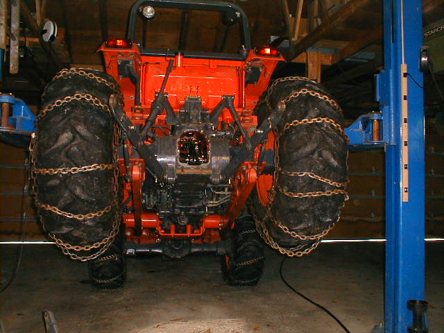

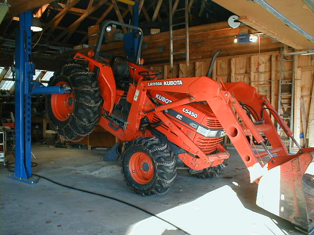

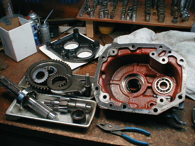

Peter - the lift was made by Phoenix Equipment, they were based in Miami I think, don't know if it's still available. I liked the design because the cylinders hang down from the top - they use the small-side piston area, running higher system pressure - makes for smaller posts.

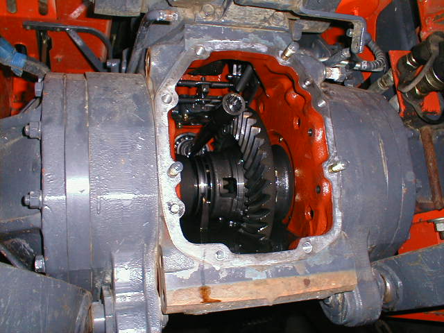

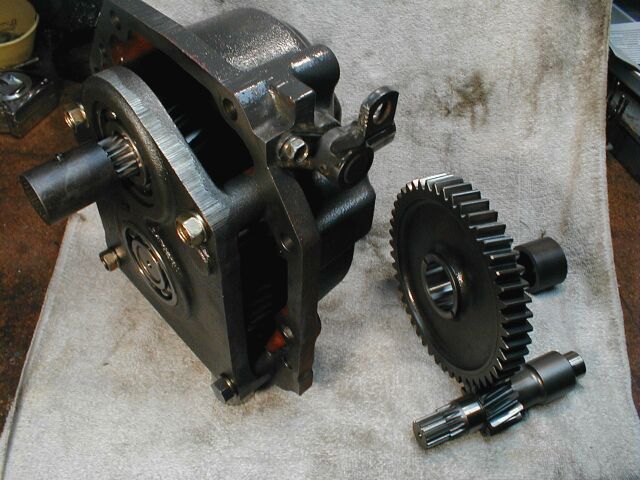

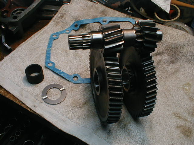

David - hope this is what you had in mind for documentation. There were some pullers and press tools needed too - but anybody who would open a gearbox knows about that.
There may be a very limited number of tractors where this conversion is possible. The ones I know about for sure are L4350, L4850 and L5450. High-speed attachments are still made in other countries though - so maybe there are other models with 2-speed pto's ?

I'm confused. I thought pto speed was a consistant 540 rpm regardless of engine speed thus the need for a 2 speed gear box to run high speed impliments.
/ Adding a 2-speed pto
#25
Tractor pto's are engine-driven and their rpms go up and down in proportion to engine speed. It's the proportion that can be changed with gearing.
A constant-speed pto would be possible but pretty expensive - maybe some HST parts put in backward? /w3tcompact/icons/smile.gif

The meter on the dash says 540 pto at about 2200 engine rpm. Many recent US/Canadian Kubotas run their pto's 540 rpm at about 2200-2500 engine. It looks like Kubota just wants to play extra safe by not allowing the possibliity of common attachments getting over-revved.

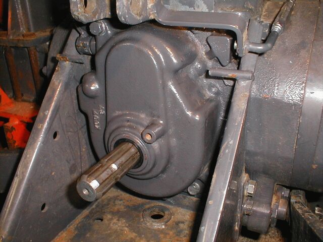

IT WORKS - got some heavy granular snow today and on the high pto speed the blower throws it a mile (well maybe 40 feet) And from the pto gearbox: no leaks, no drips, no noises. Life is good.
/ Adding a 2-speed pto #33
Those extra rpms at the pro will make a big difference. Out of curiosity, what is the diameter of your auger/impeller?
#34
It's 22" diameter. At engine rpm of 2450, pto 840, tip speed is about 4800 ft/min. Chute is fixed at 45 degrees, but can rotate. Like any pump it works best with a full bite.
/ Adding a 2-speed pto #35
4800 feet/min should give you a decent throw. Too bad you couldn't get another 500 ft/min as that would make a big difference. Is there any gearing between your pto and auger? I am guessing that since you have a single stage snowblower there is no gearing change. On my two stage snowblower, there is a direct drive to the impeller but a 4:1 reduction to the auger. How is the clearance between the impeller and the drum? If the gap is getting too big you might want to build the ends of the impeller up a bit in the off-season. Anyway, it weems to be working for you.
#36
Auger/impeller run direct at pto speed, no reduction. Increasing the engine rpm 10% from 2450 to 2700, the pto would increase to 920 and tip speed would be 5300 ft/min. The engine could actually be run at 3000 maximum, where tip speed would be almost 5900 ft/min. But I don't think it needs that much. It seemed to work well with the engine just below 2500 where the pto is at 840 with the new gears.
That speed wasn't possible before the gearbox modification.
