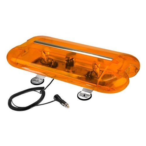

I did return that warning light for a smaller unit, BTW.
I fit it to the ROPS to see how it would work. Before use, I'll fabricate a bracket to hold it more securely.
The picture shows to unit just setting on the ROPS. Although the magnets are the same, this one is a heavier lamp for commercial use and it needs all 4 magnets to hold it in place. I'll also need a longer power cable.

Hey Roy just curious if you are going to just rely on magnets to hold that light on.
That's what it's designed for, but I haven't decided. It depends how well it holds when all four magnets are used (doesn't do too well with just two magnets which is all that was holding it in the pics I'd attached earlier).
I really don't want this thing crashing down on my head when plowing!

Oh yeah...I also need to acquire a bracket or plate of some sort to hold the warning flasher itself.
