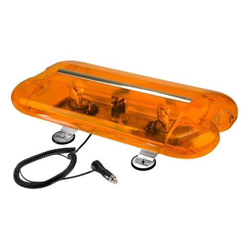

This one...
Amazon.com: Wolo Model 3550M-A Aurora Magnetic Mount Halogen Mini Bar Warning Light - Amber: Automotive
Haven't decided on which outlet though. It'll be a marine type since those are all weather types. Amazon has quite a collection.
As I'd written in my first post, the strobe would be used in my pickup as well for road side emergencies. In fact, it would be kept in the truck except for the relatively rare times I'd want it on the tractor.

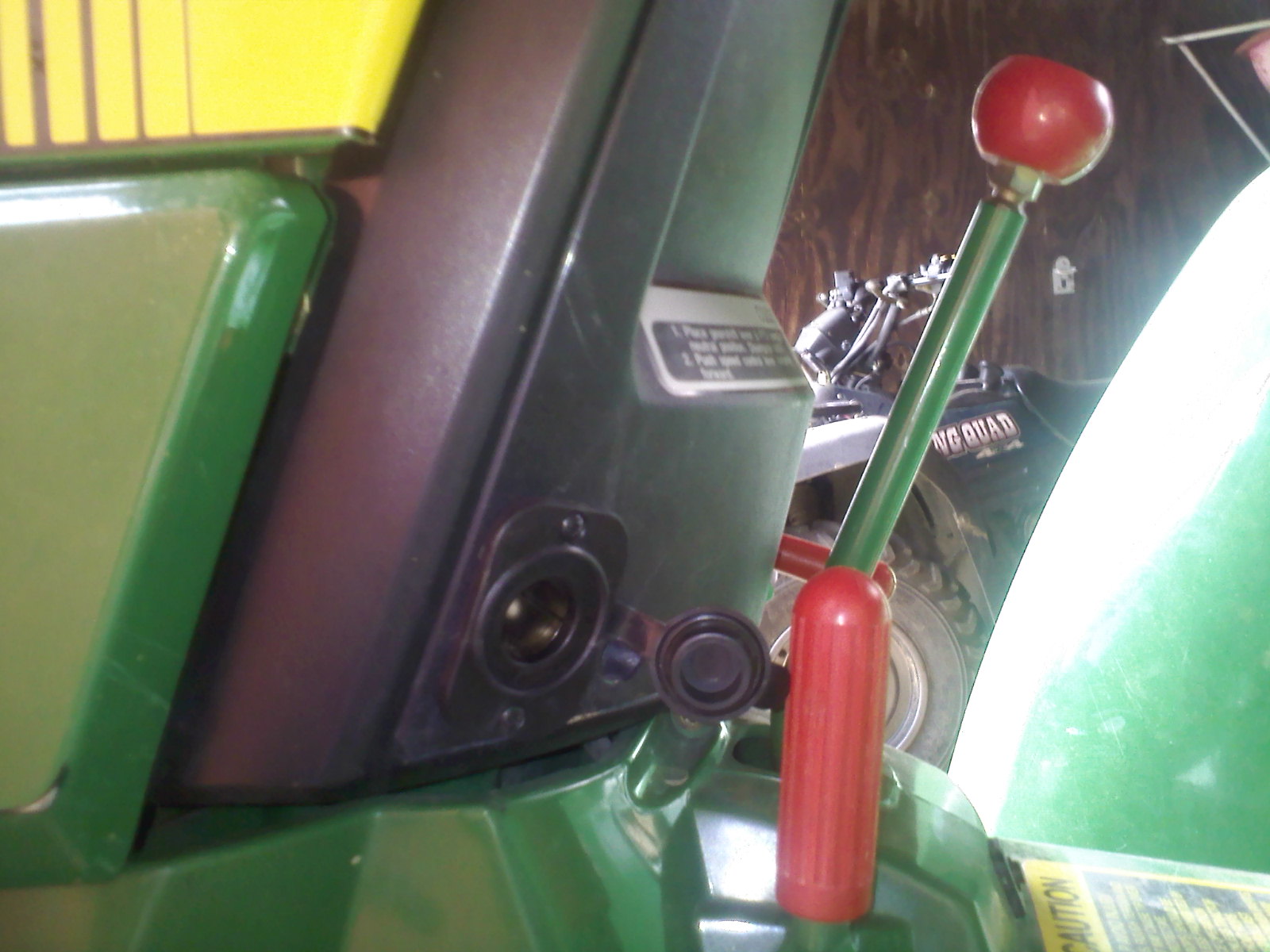

Roy, If you do not already know this the receptacle you are looking at is the same one Deere puts on the 2520 and 2720 tractors.

Roy, I bought a stainless steel marine outlet for my 4200. I plan on putting it below the dash on the left of the fuse panel door. I already looked behind there and there's nothing in the way that I can see. I'm just going to run a hot wire directly to the battery through a circuit breaker and ground the other side to the frame. If anybody sees a problem with that idea please let me know before I start drilling.

That's probably what I'm going to do too...since Tractor Pilot brought up the very good idea of using it for a trickle charger too.
Nope, didn't know that...

The warning light was delivered a day ago. It is a nice light...very bright!!!
It's also considerably bigger then I thought it was!! It's 26" long by just about 10" wide. I rough mounted it on the ROPS and I am considering returning it for a smaller unit.
I bought this one off Amazon.com which list the weight, but not the dimensions. If any of you are considering a warning light such as this, I suggest you go to the manufacturer's website (in this case, Wolo) and look for the dimensions before you order.
It would work very nicely on a pick up truck though.
Yep same one as my gator and on my 4120.

The one I got was $84.00 on Amazon.

Have you tried it out yet? Would it be bright enough to be seen on a sunny day with the sun reflecting off the snow?
I plugged it in to a portable battery (jump start unit)...yeah, it's plenty bright even during the day. Like any warning lamp, it's not just the brightness. The rotating pattern is what catches one's eye.
A strobe would probably be more noticeable, but more costly.
BTW, you can view short videos of the Wolo lights on their website, if interested.
As far as operating, I don't spend much time on the road. I just plow about 15-20 yards on either side of the entrance to my drive...also, my neighbor's drive sometimes. I normally plow at night or wee hours of the morning (well before dawn).

Wow, 26" is big. Most mini bars are around 17"...
I did return that warning light for a smaller unit, BTW.
I fit it to the ROPS to see how it would work. Before use, I'll fabricate a bracket to hold it more securely.
The picture shows to unit just setting on the ROPS. Although the magnets are the same, this one is a heavier lamp for commercial use and it needs all 4 magnets to hold it in place. I'll also need a longer power cable.
