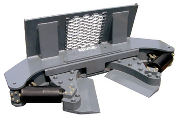

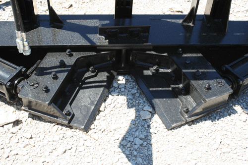

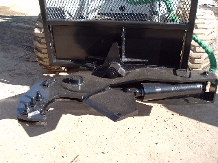

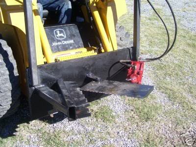

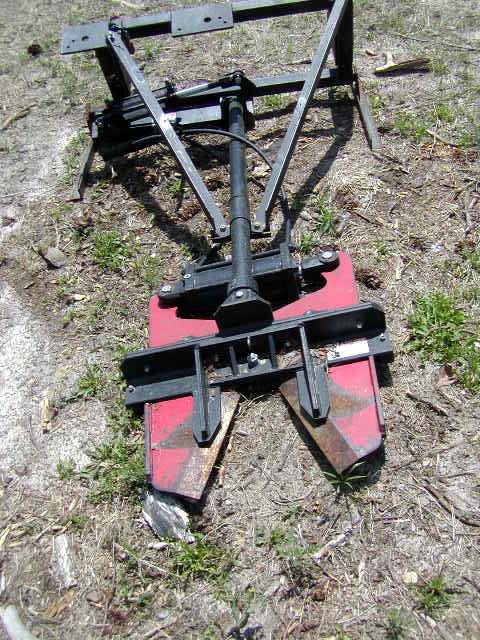

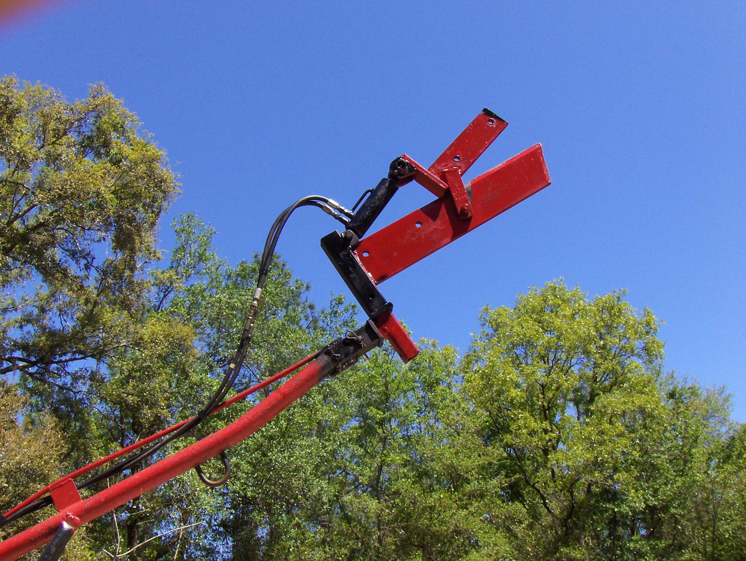

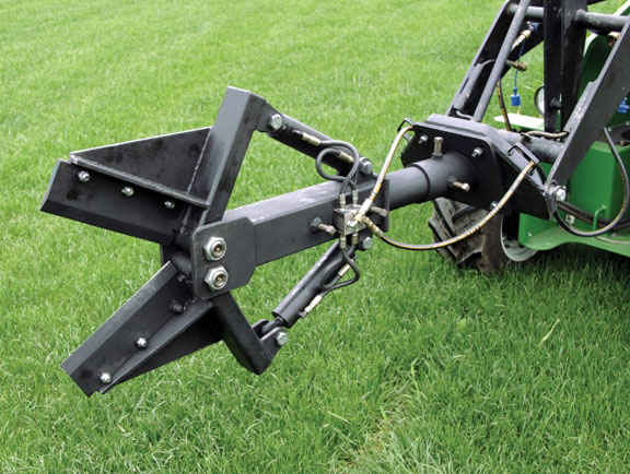

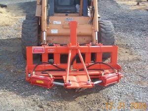

Here are a few pictures of tree shears to give you some ideas.
I built the small red tree snipper to reach up in trees.
