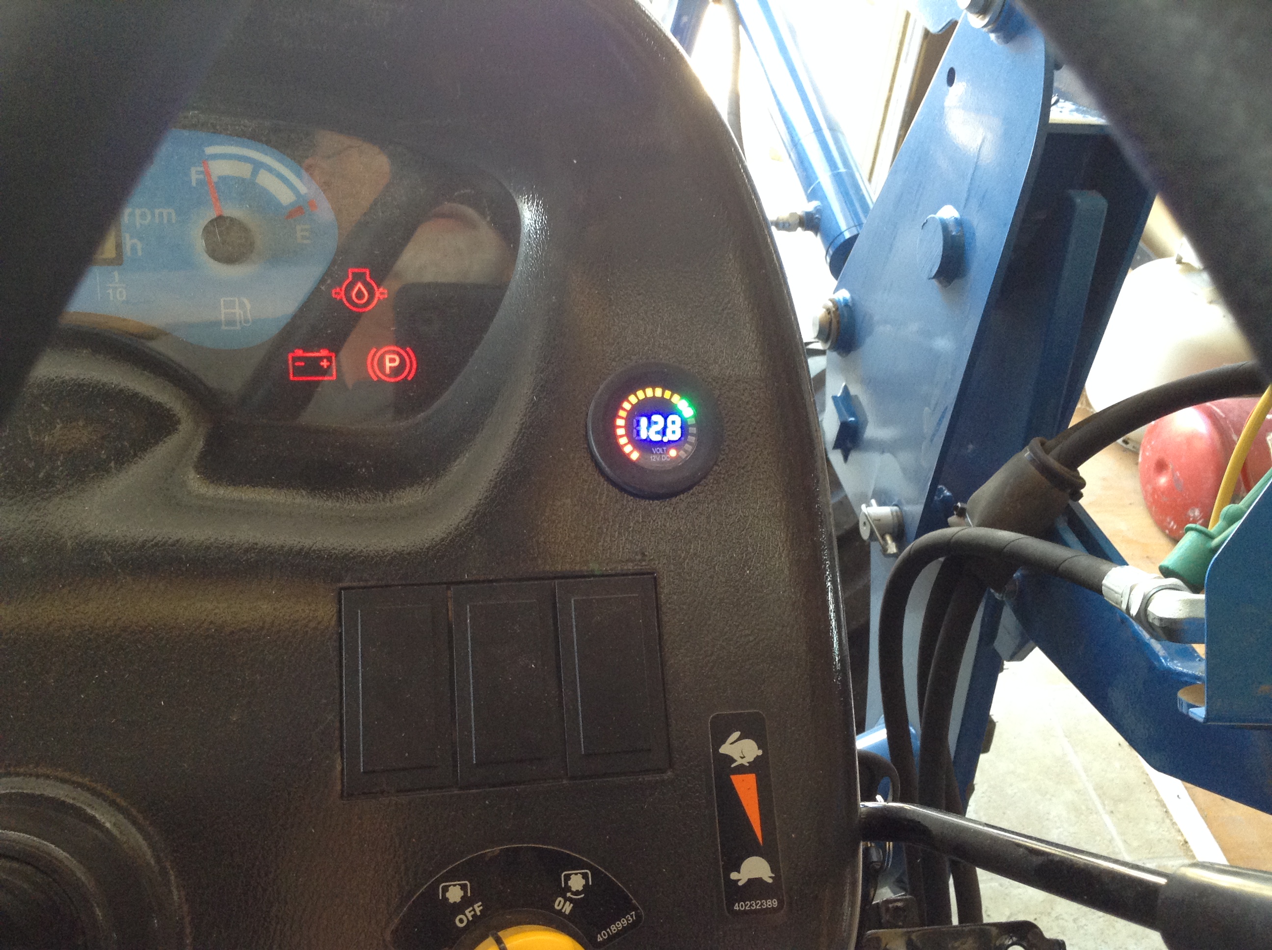

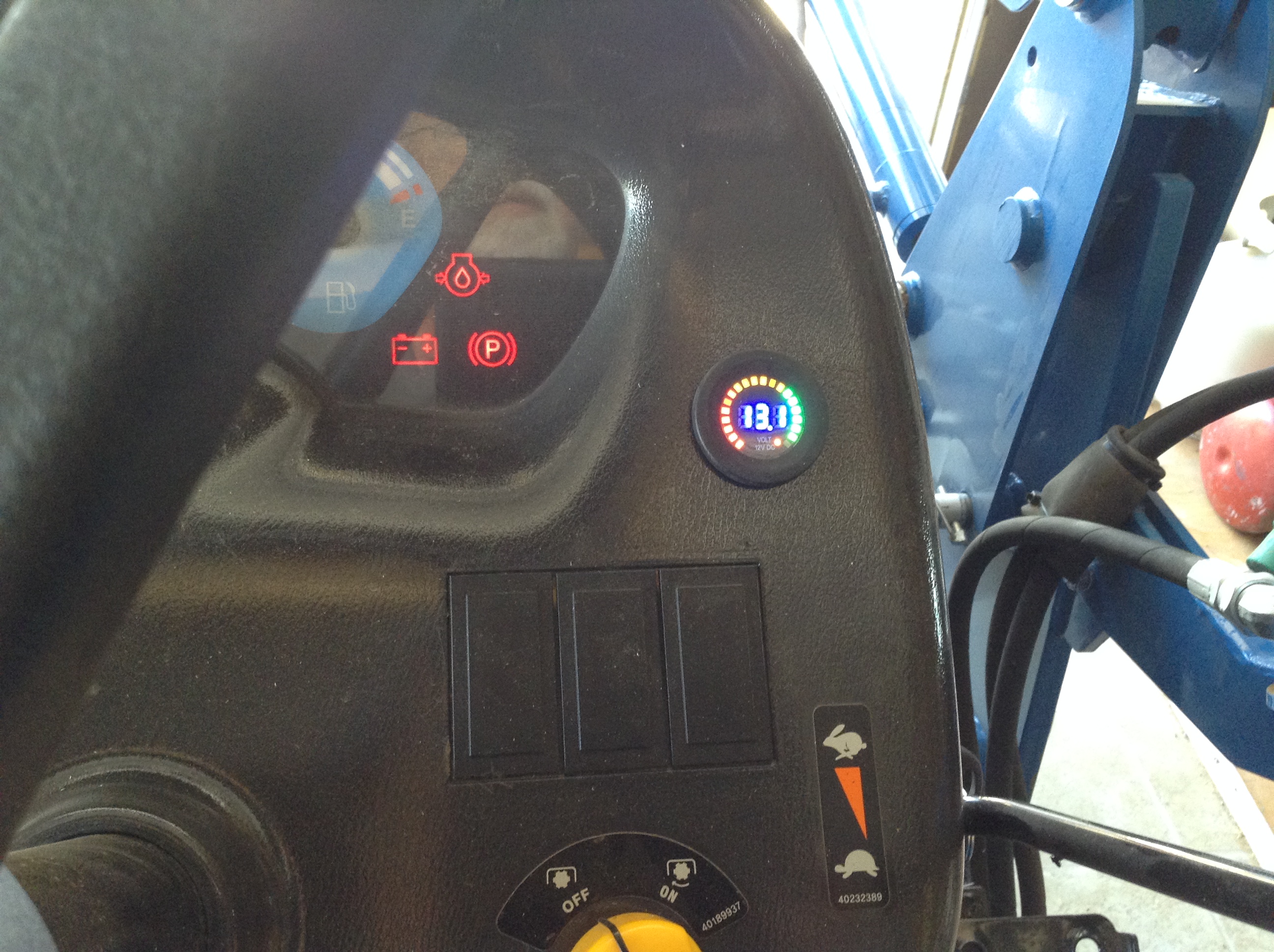

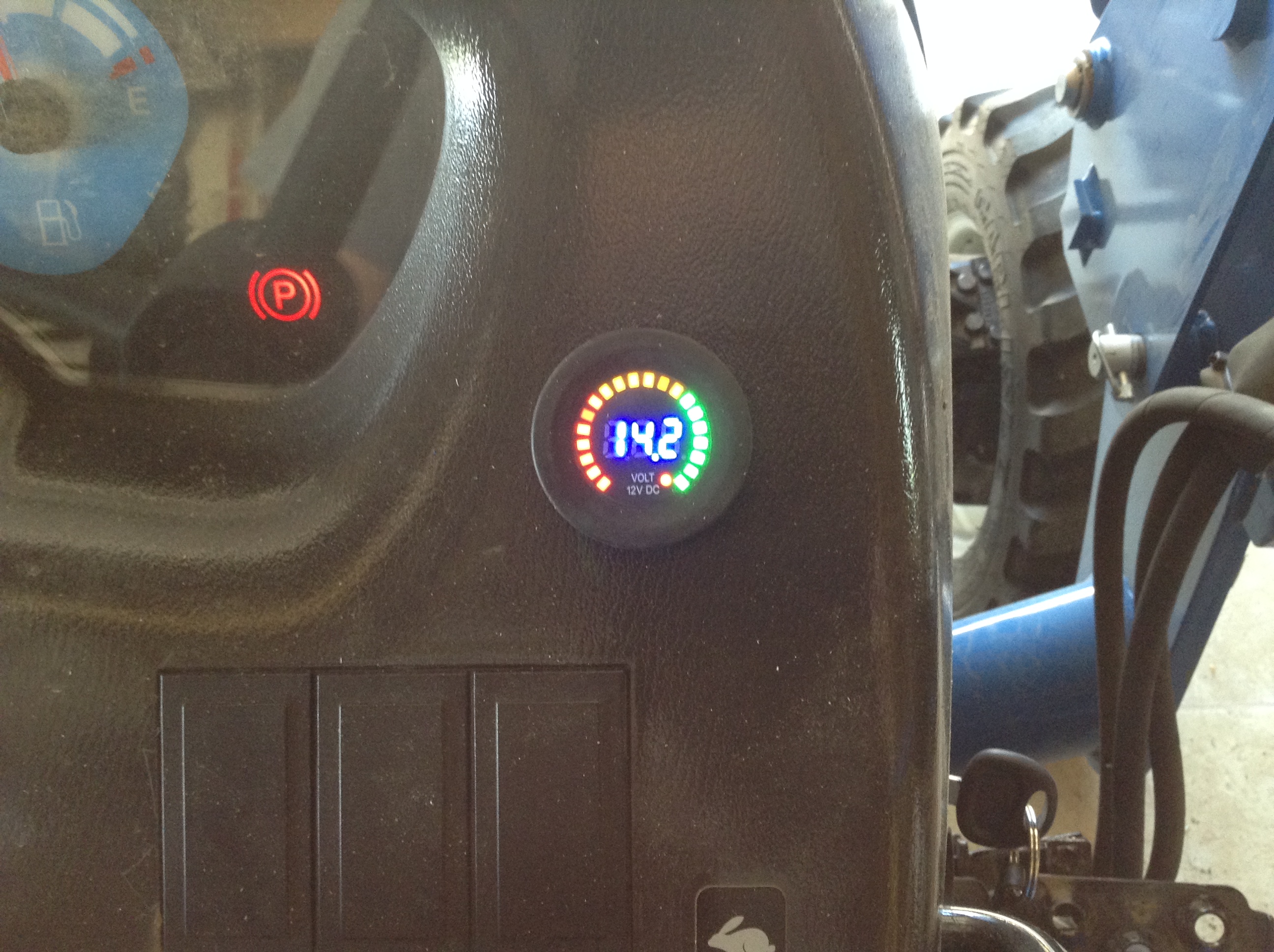

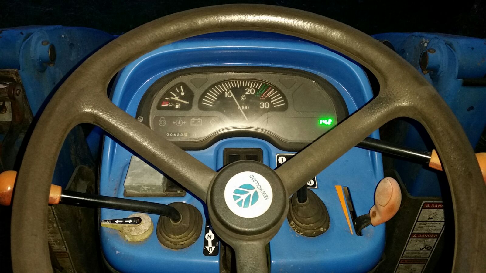

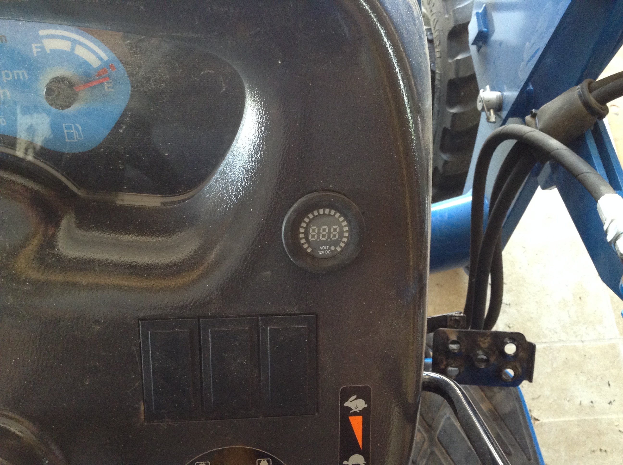

I hated not knowing what the battery status was at, so added a digital volt meter. Has a red, yellow, and green bar around the edge and a digital volt readout. Wired it into the fusebox supply, so a good reading.

The lit circle is just fluff.... The actual numeric value is what is important.... Good job.... Don't know why all tractors have not gone to this.... The 14.2 volts indicate good charge voltage/system status voltage...

What I really like about it is that when you just turn the key on, it will give the battery volts, then after starting, the charging volts. I agree that the manufacturers should have them standard.

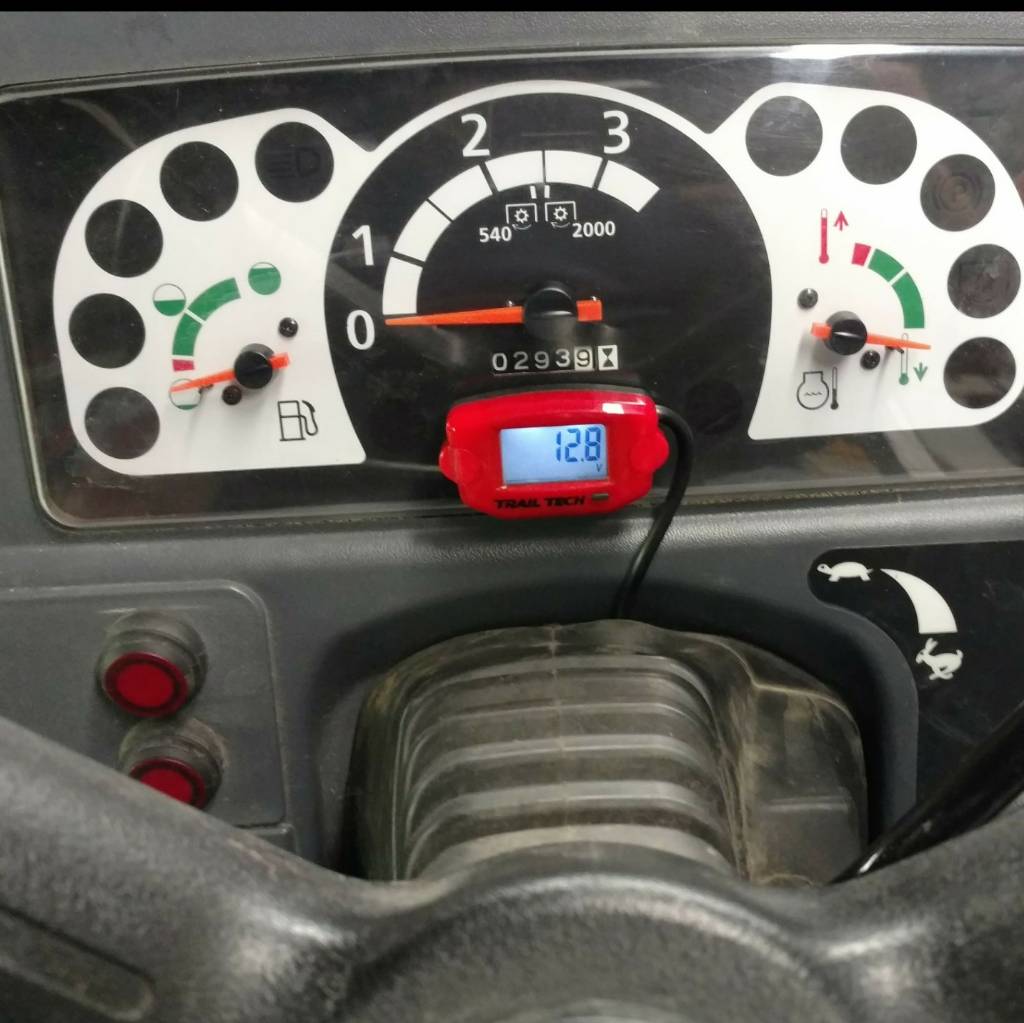

I started out just wanting to add a clock to my dash and found the volt meter/clock from Trail Tech. Their stuff is geared more towards ATV's and off-road vehicles but made a good solution for what I wanted. You would think that a volt meter would be standard equipment on any tractor. IMG_20190630_164136.jpeg
