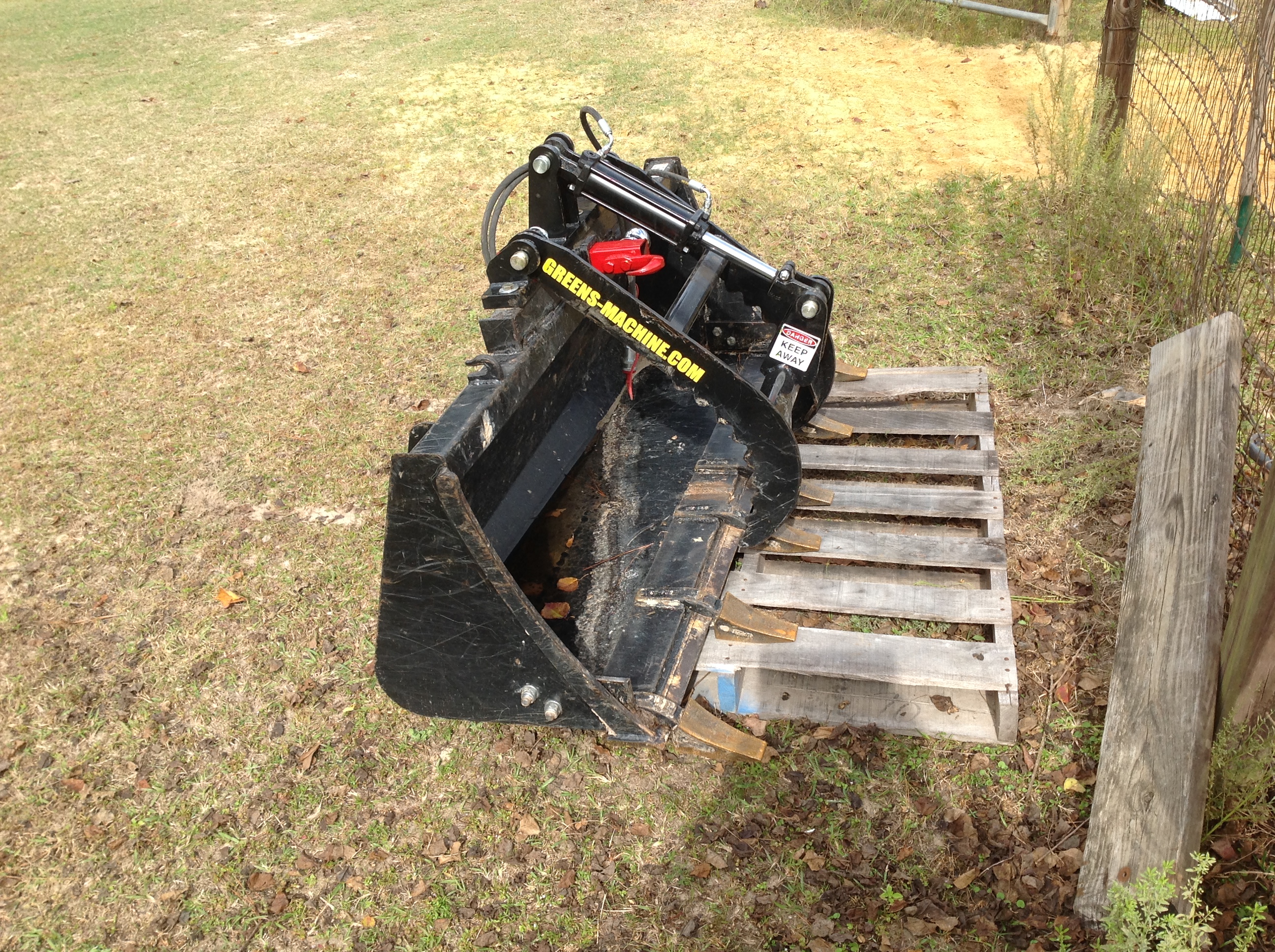

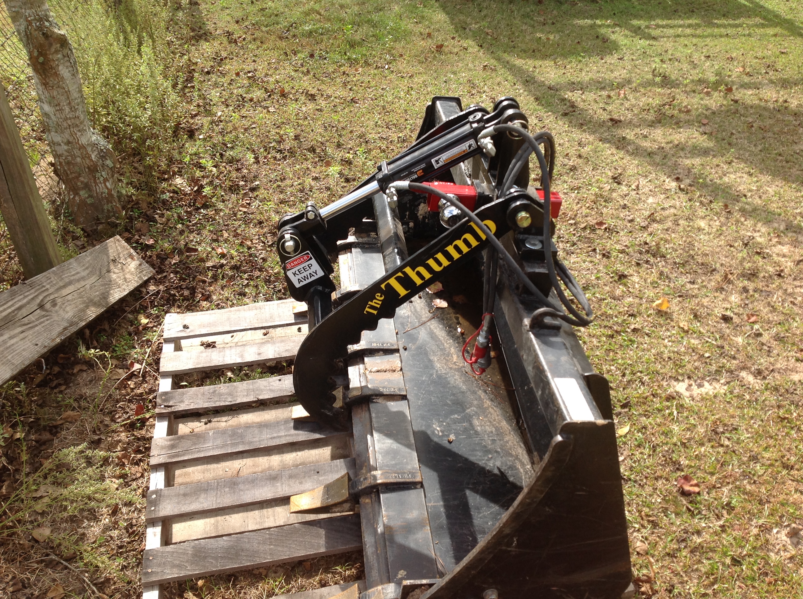

Added grapple and tooth bar to bucket. Love it for small clean-up, still put full size grapple on for brush piles.
Grapple from Green Machine The Thumb They call it the Thumb. Tooth bar from titan implements. IMG_0737.JPGIMG_0738.JPG
/ Added Grapple to bucket #2
Very handy and useful set up that you have added :thumbsup: I bet you find it way more capable than you originally thought and will enjoy the added versatility off having both a bucket and a grapple.

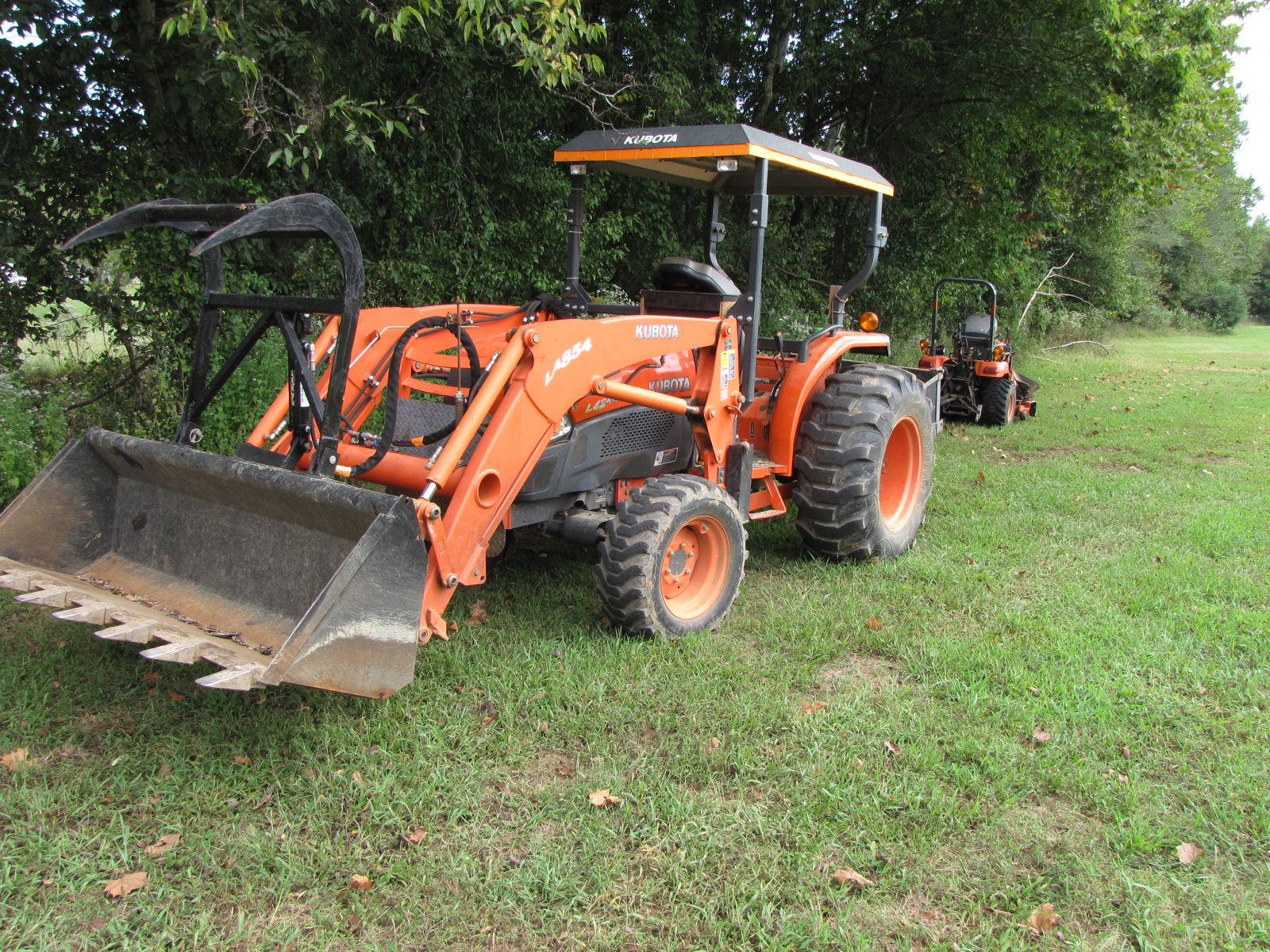

Here is the one I put together for around $500.00 bucket and all.
/ Added Grapple to bucket #6
Looks great. I have one of the Green Machine The Thumb on my Kubota bucket. It works great and is very handy.
