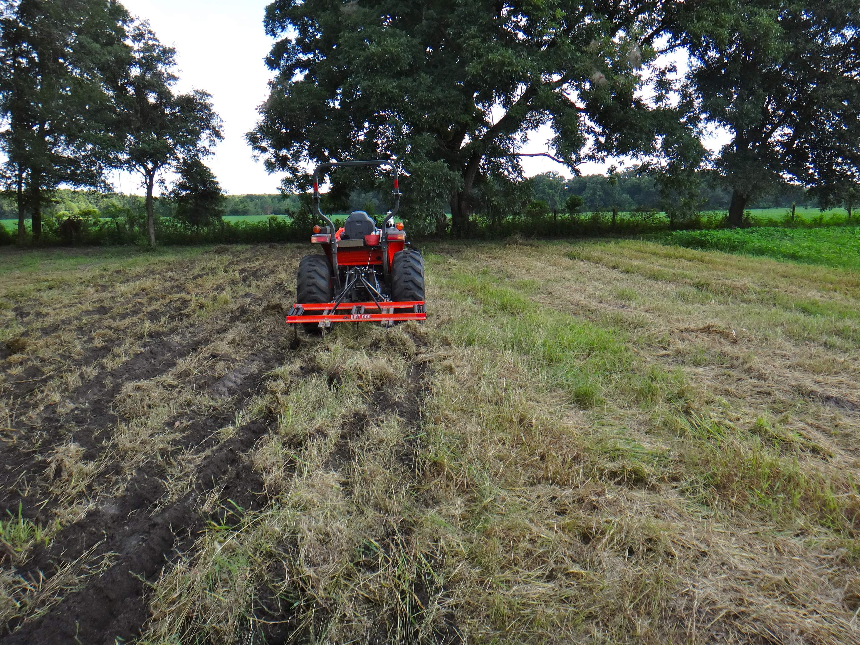

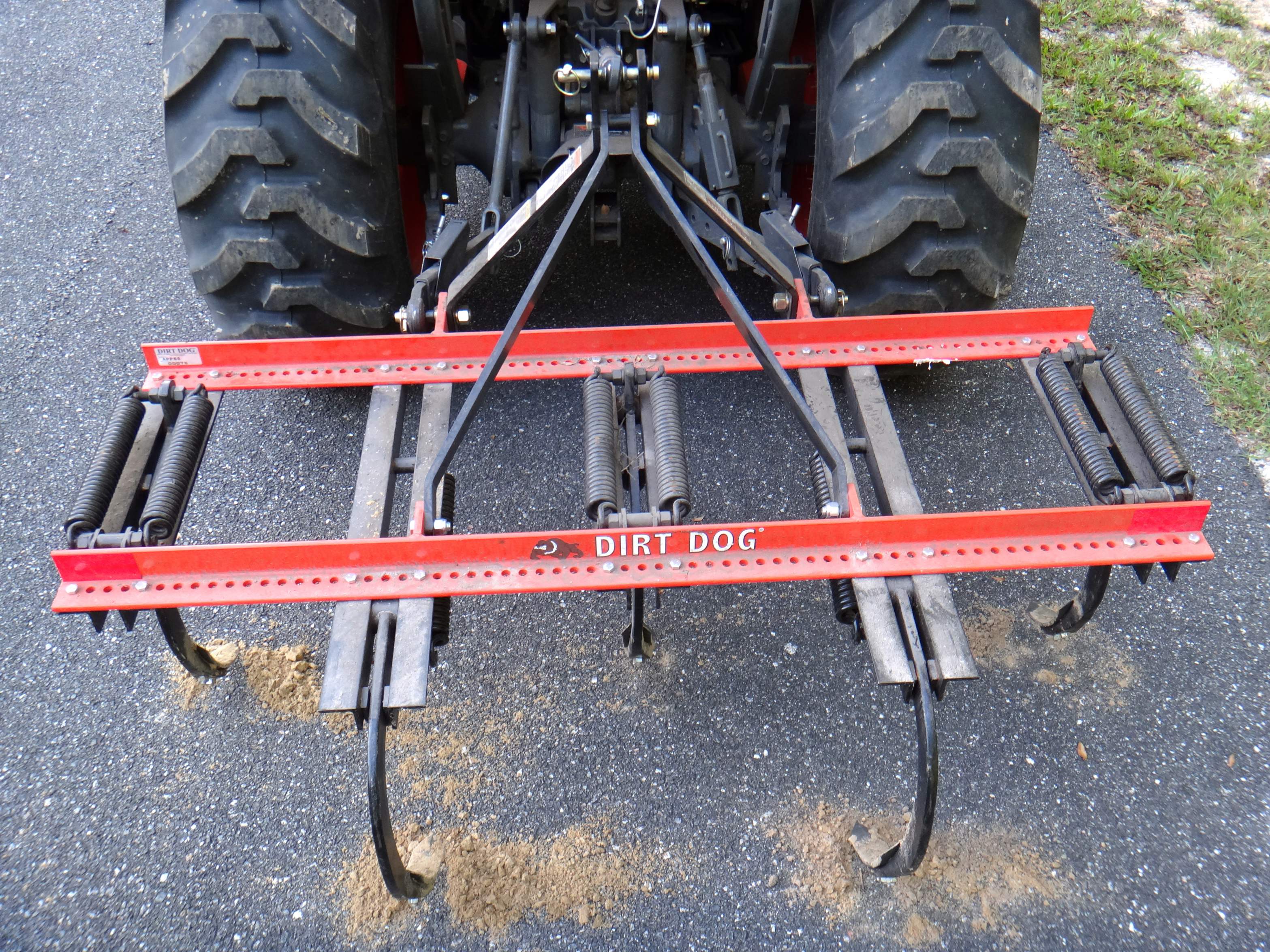

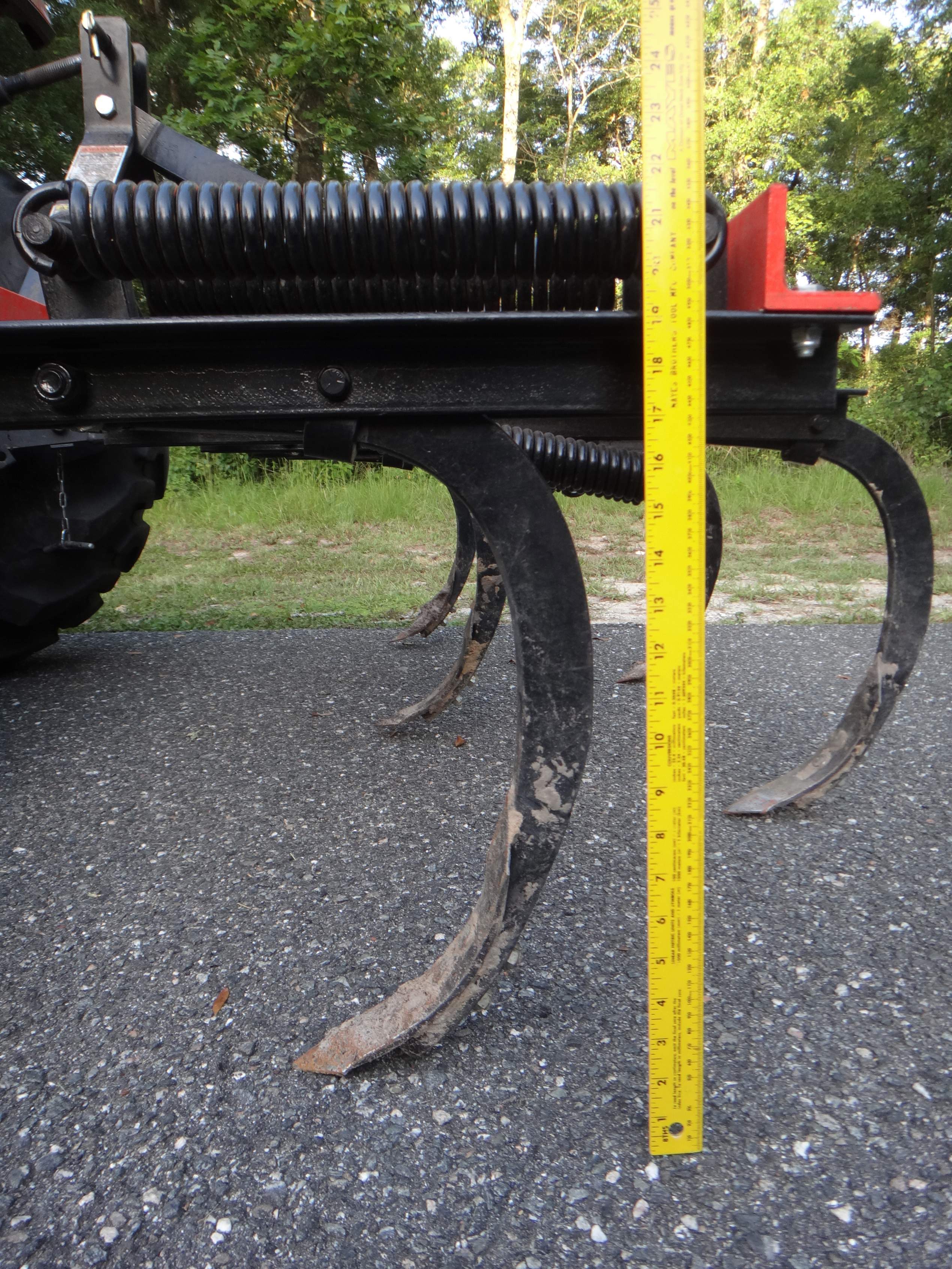

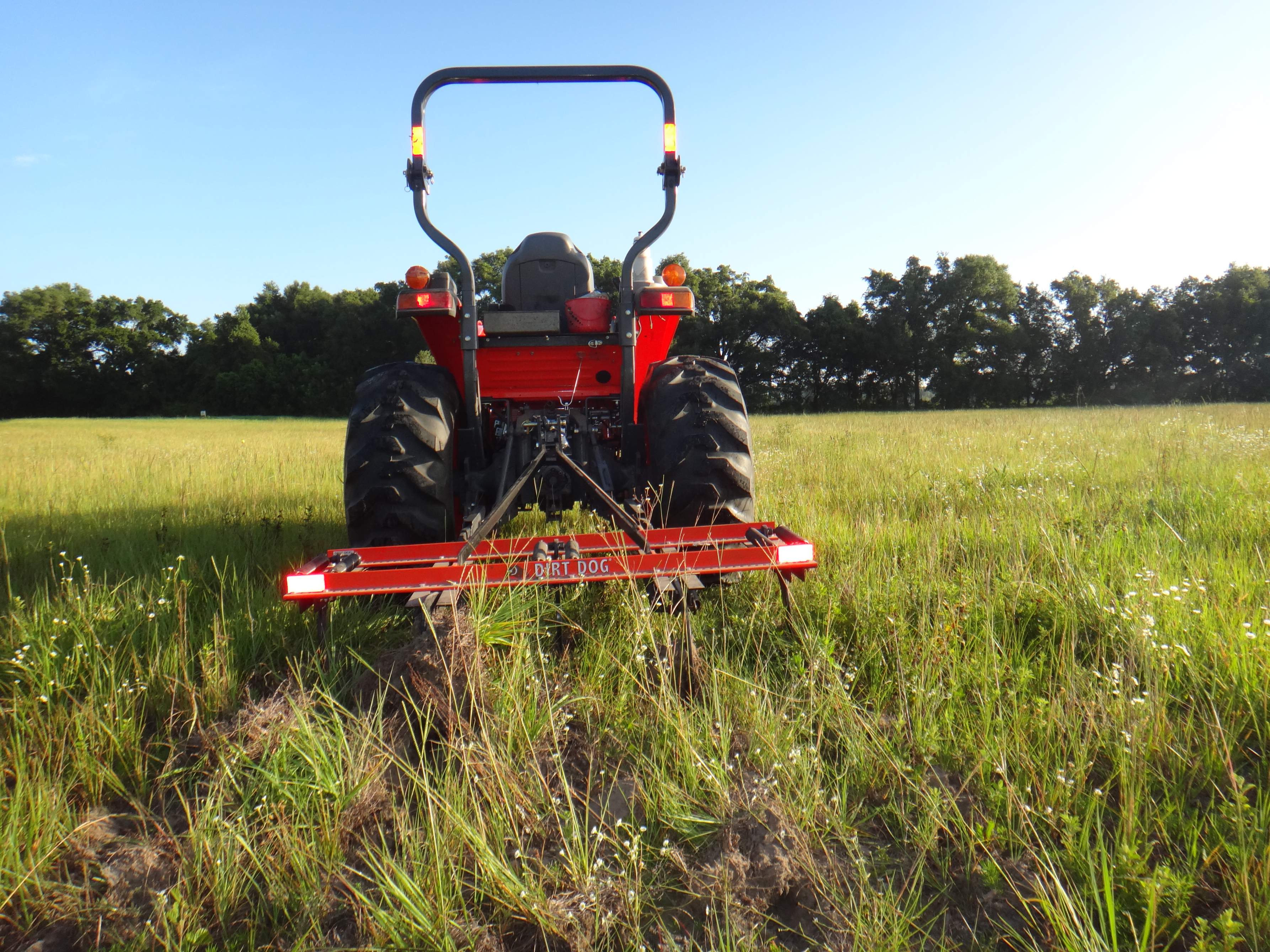

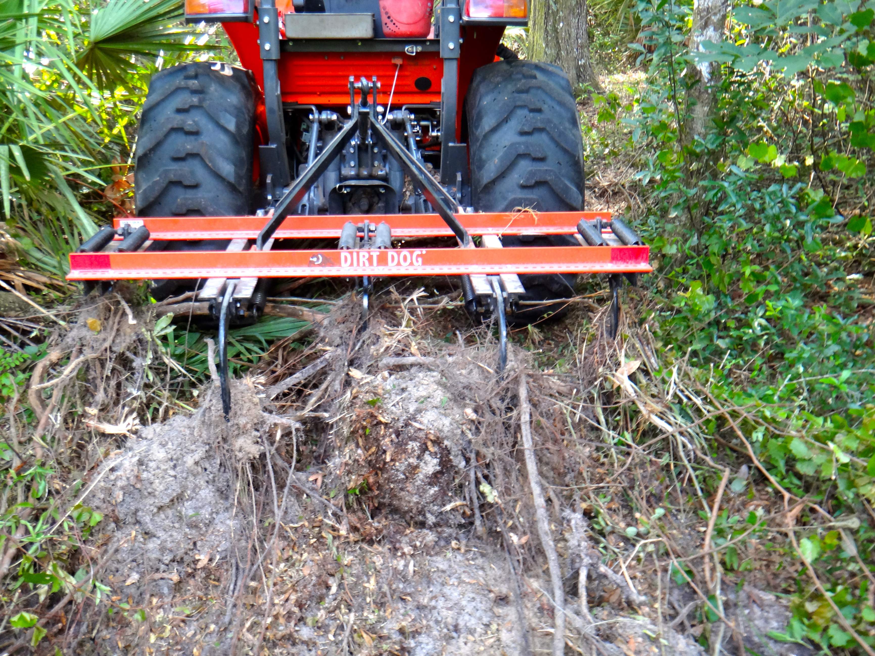

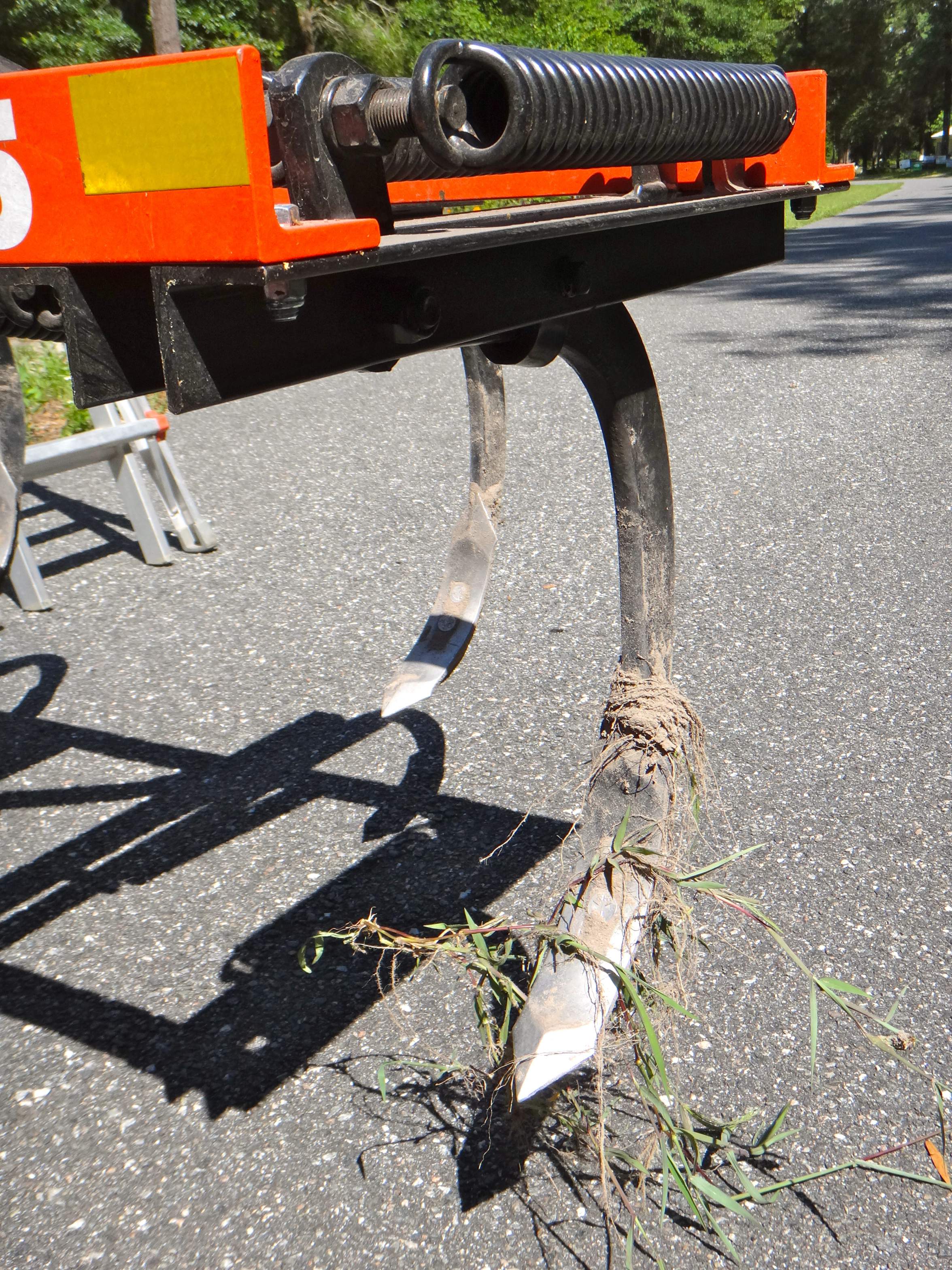

ElSueno Farms:
I wonder if a Field Cultivator would be of any help?
Field Cultivators for compact tractors are secondary-tillage implements. Horse compacted pasture will be too hard. You will break Field Cultivator points too frequently. You need a plow, or a single shank Subsoiler, if you want to aerate and loosen 12" deep, for primary tillage. Going 14" deep one time with a Subsoiler is good idea, relative to pasture history.
Field Cultivator is excellent for periodic secondary-tillage pasture aeration.
LINK: http://www.tractorbynet.com/forums/attachments/339095-dirt-dog-all-purpose-plow.html?highlight=
I know the disc and tractor weight is important, need an education on Disc Harrow set-up and operation.
Ask, and thou shalt receive.
LINK: http://www.tractorbynet.com/forums/...ing-three-point-hitch-mounted.html?highlight=
NOTE: MY SOIL IS FLORIDA SANDY-LOAM, NOT CLAY.
