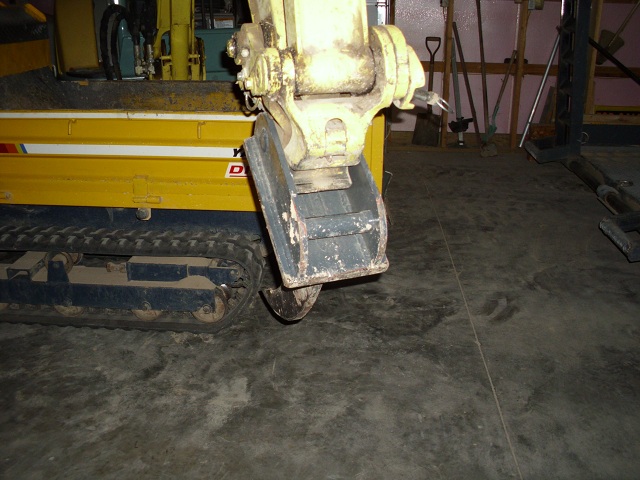

FYI, Michigan Iron earns their money. I probably haven't saved a dime other than the fact that I used less material. If you subtract that, I will have almost as much in mine and did my own welding. I didn't think I needed one that HD and it turns out I didn't.
   / Added a ripper to my Woods BH90x: Trees beware #112
Awesome job Reed, just wish we had more pics of the build! Did you cut the 3/4" plate or was that done by someone local? I'm also curious about the cutting edge...when I enlarge the pic it looks like the inside radius was cut in with an end mill then sharpened w/ a grinder? Have you got a Bridgeport hiding in the corner of your shop?

OK, a few pictures for you picture junkies. The hydraulic quick connect is the reason I got this machine.

I had Shew Bro. cut out the pieces and I welded them together.I am almost out of Oxy/Acy. I'm not low enough to have them refilled and not enough left to do the job.
