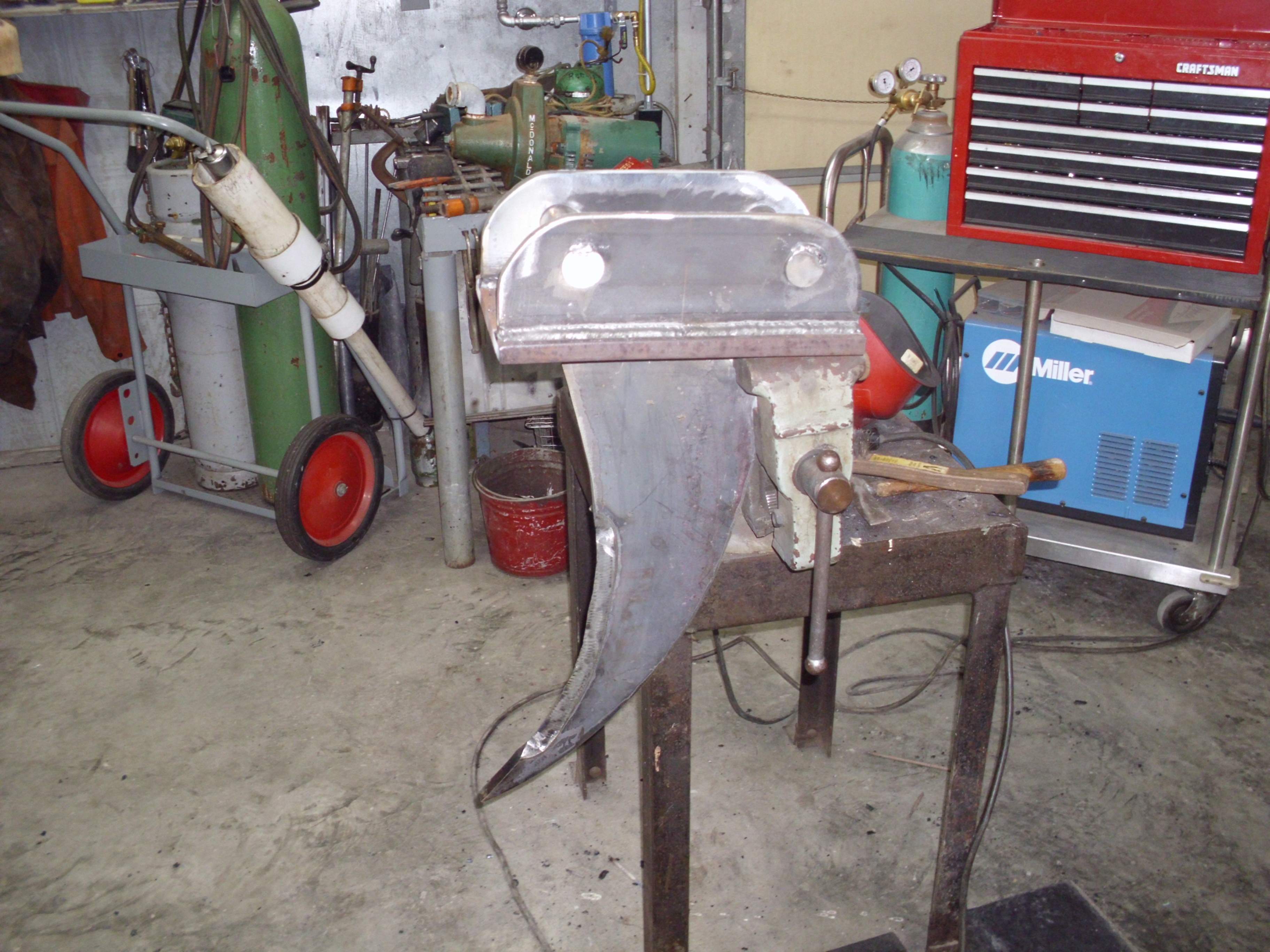

If anyone is interested, I have started a ripper for my miniexcavator. I will post this picture. If anyone is interested, I'll post more as I finish it.

Looks great. I presume you will add some lateral gussets for support.

My ripper is 3/4" plate. I have a slot cut in the top plate that the blade fits in and is welded top and bottom. My machine is small and I don't think the lateral load will be great. I am just using it for cutting. I have a quick attach that is hydraulic. I can change from bucket to ripper in less than a minute. I have a coat of paint on it today. I will mount it up and show you guys the quick attach. Yanmar comes with a hydraulic quick attach, stock. If you are interested, I can take some pictures of the grapple bucket I adapted from a miniskid steer to fit. We had a huge storm a couple years ago. It paid for my goodys in short order.
