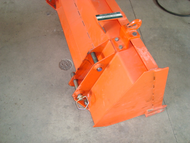

I did a bunch of research on this basic subject and found out that the best place to place a hook is in line with the bucket cylinders. A hook in the center of the bucket would be very handy as well. The idea is to keep the weight of whatever you're lifting centered in the bucket so not to induce a twist on the loader. As stated, you will most likely need some reinforcment. A picture of your bucket would sure help us out and there might be someone here that did the same thing to his bucket. Here is how I did mine.
Steve
/ Add on bucket hooks #8
If you or someone you know can weld you can probably add bucket hooks for about $30. Here's how I did mine.

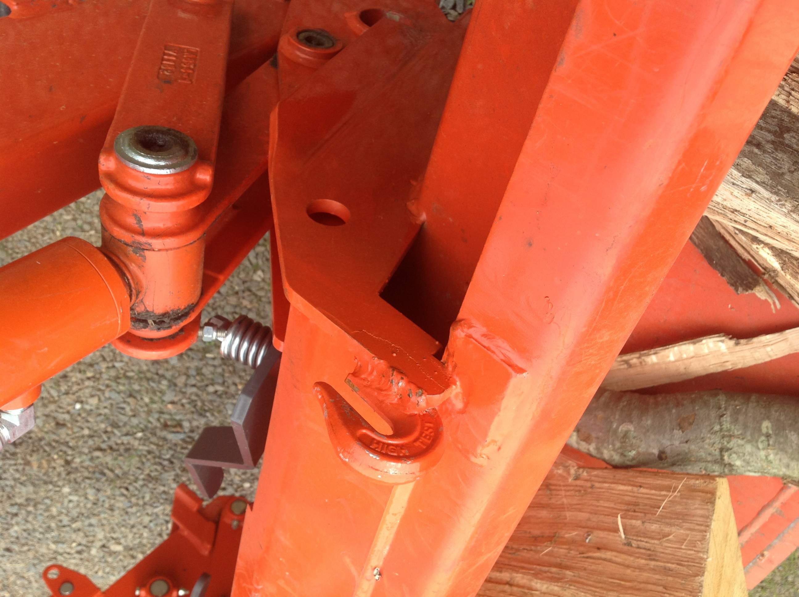

My tractor has a quick attach bucket instead of a pin on type so it has the QA frame on each side. I welded my hooks to the top of that frame. The frame also runs across the top of the bucket so there was no need for a reinforcing plate.

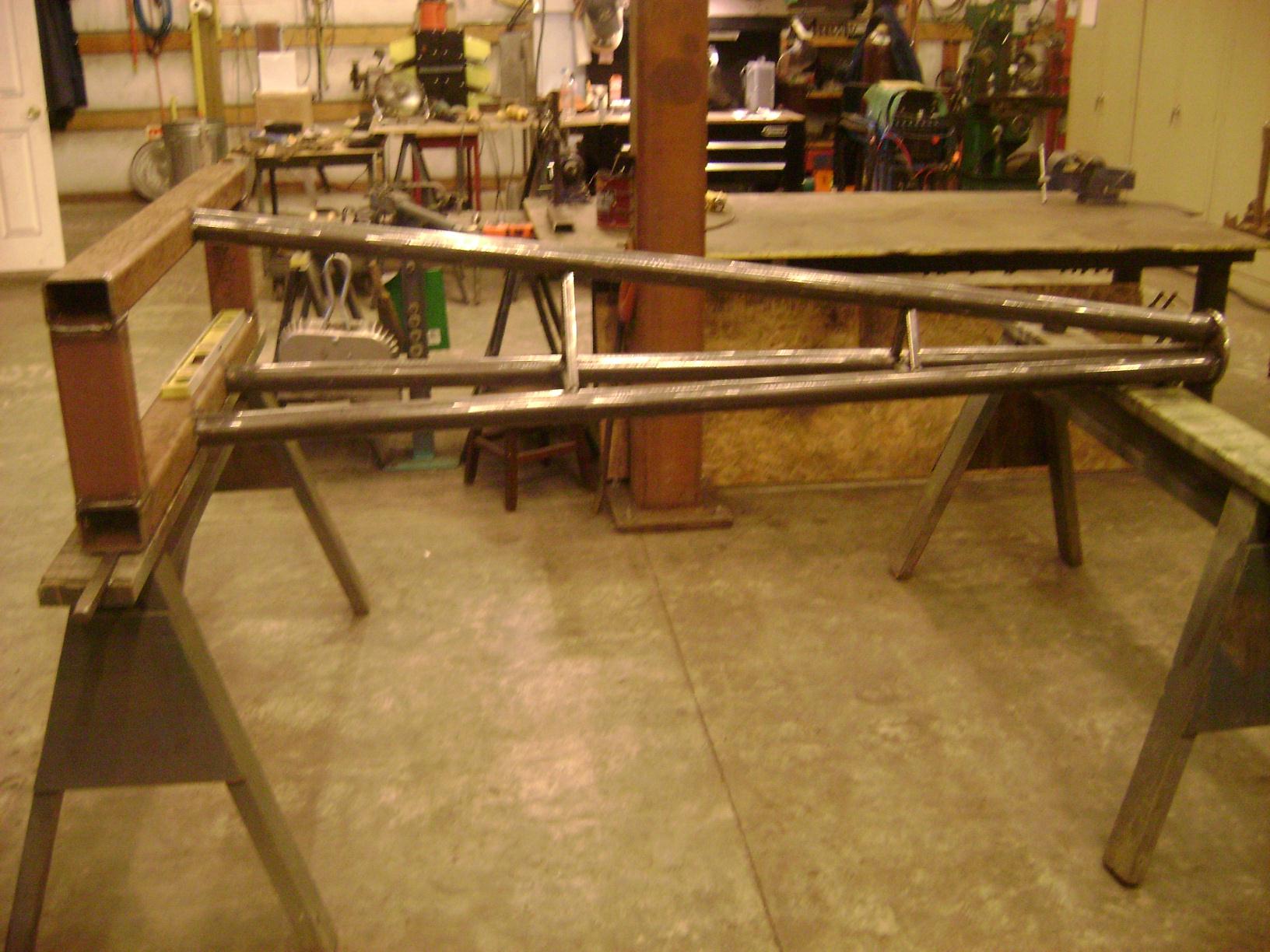

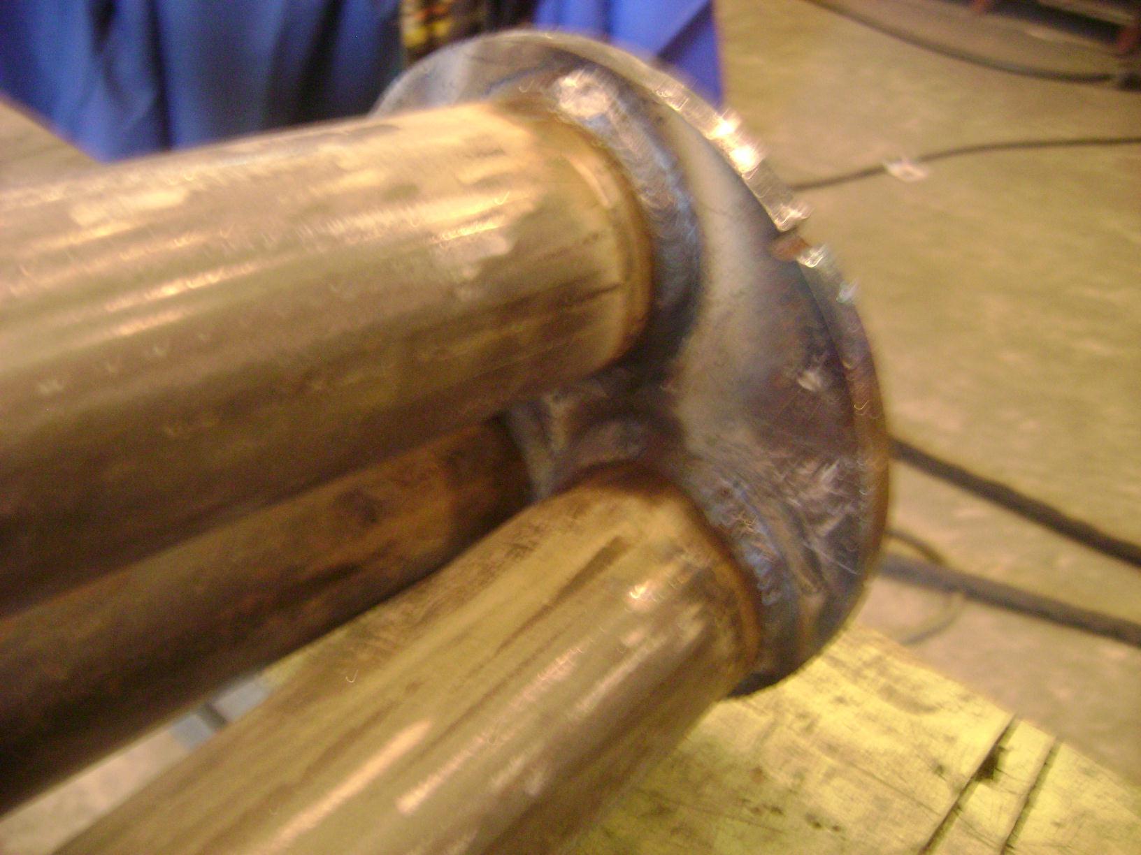

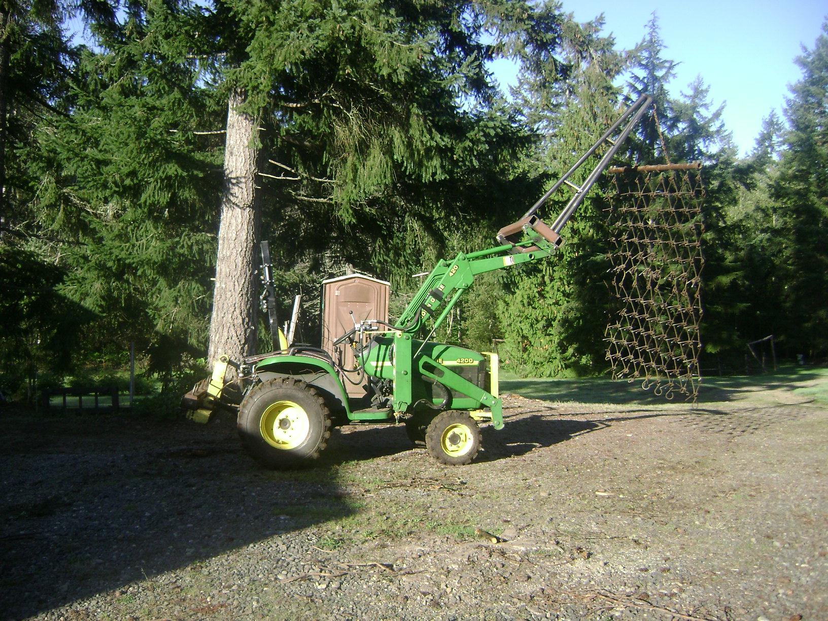

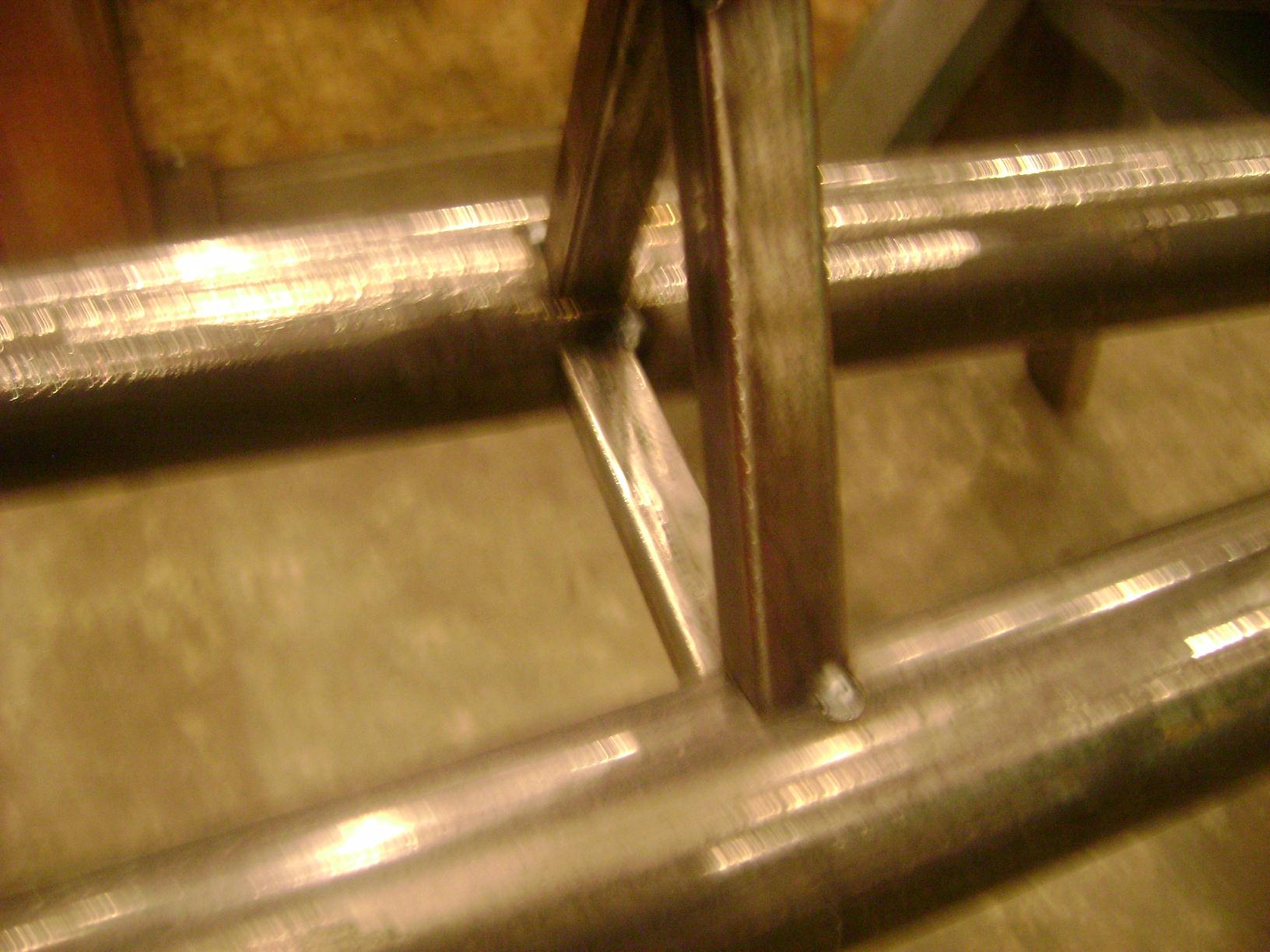

We use the front end loader the most on our tractor. I built one of these a few years ago. It really comes in handy for some things.
