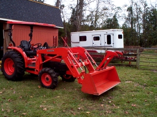

I had a 72" bucket grapple on my 3830. It was so heavy the loader was overloaded to start with.
Found this on Ebay, Grapple
Works like a champ.
I already had an extra valve from Construction Attachments.
Gerald

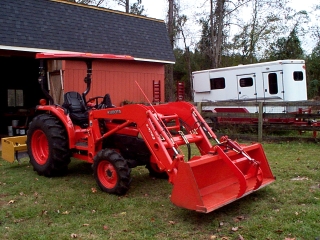

Pic with grapple open.
It is very easy to take off when not needed, 3 pins 2 quick disconnects.

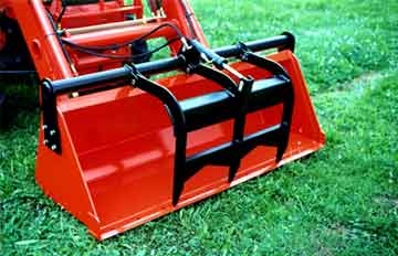

I like that. I have been looking to make or buy a grapple like for my loader bucket. ATI Corp ATI Web Site offers one made to bolt on the sides of the bucket (see attached pic). I haven't called them to get a price. Just comparing the pics I was wondering what people thought might be the pros and cons of each. The EBay grapple looks like it has a beefier hyd cylinder. Flat bar attachment along the top might be an issue for some peoples bucket type. On my Magnatrac I've got a pretty strong flat top on the bucket and I don't have a center chain hook so either type looks like it would just bolt right on. The $450 price seems affordable enough to save me the effort of building one.
Gerald - Is there anything that you had to reinforce/modify to install on your Kubota? Are you happy with the quality of the grapple construction?

   / add on bucket grapple #7
John,
Sometime earlier in another thread someone had posted that they had problems using their bucket next to buildings coming to it do dump or backdragging away from it because of the grapple extending out too far with the bucket tilted forward.
That would be one situation when being able to easily remove the bucket grapple when you're not using it would be a plus. /forums/images/graemlins/wink.gif
   / add on bucket grapple #8
I have the ATI grapple. I have had problems hitting things with the grapple when the bucket is in the dumped mode. I don't know how heavy it is but it is removable by pulling 3 pins. I am planning on building a holder for it so that I can remove it when I am doing solely dirt work.
Vernon
   / add on bucket grapple #9
Yes that is another feature I like about these grapples is that they can be put on and taken off easy.
Vernon - Can you tell me how the ATI grapple price compares with the $450 Ebay grapple? Are you satisfied with its performance for grapple type work? Is it well made?
John
   / add on bucket grapple #10
john, i have the ATI grapple as well.It's great cost was about $700
delivered and is well made But you have to weld the 2 end plates
to the tube .No big problem unless you don't weld
