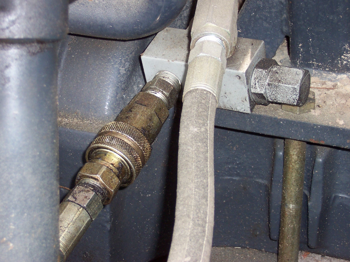

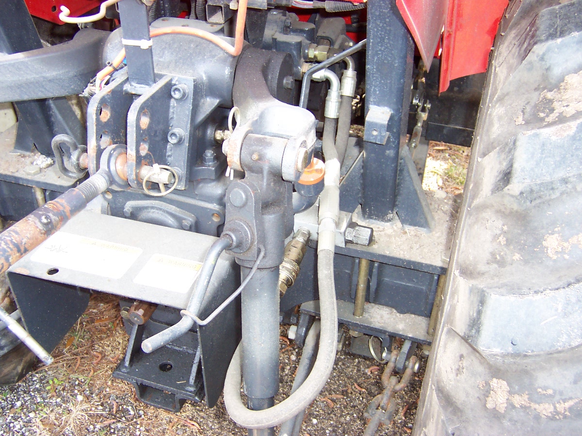

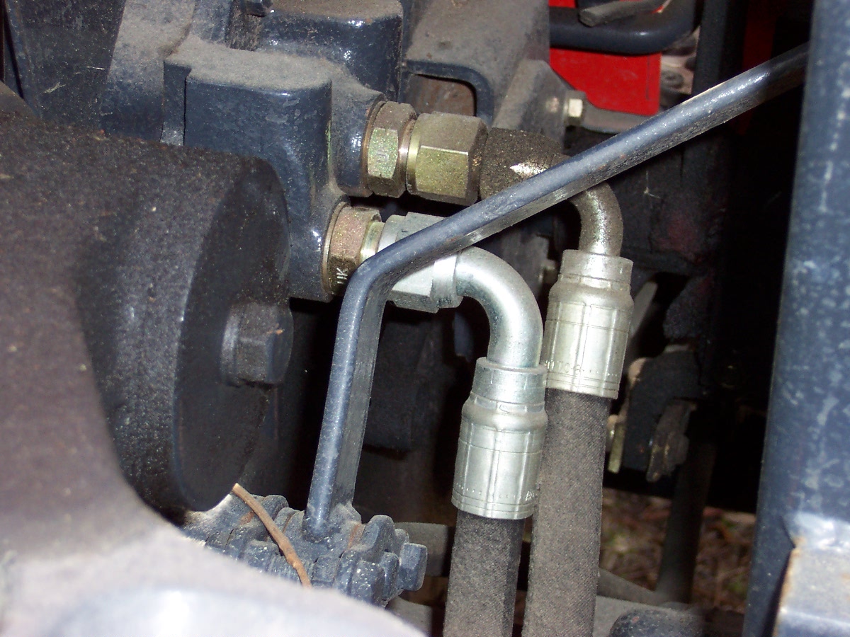

Here are pics of my 3510 rear hydraulic connections for my Chinese Backhoe.
The fittings are available at a good hydraulics shop and I put an adjustable pressure release (aluminum block) in the circuit for my own peace of mind.
I always store it with the hoses connected as shown.

Can you post the page from the manual about the two ports you use for the log splitter.
Do you still have use of the 3pt?
Does the relief valve have a tee fitting for the relief pressure and is it also the the tank line for the log splitter?
Where is the input port for the 3pt?

Hey Stimw, can you tell me which port on your Branson is the Supply and return in the pictures you shared? The one where the banjo crossover bolts are. Thanks
   / Add Aux hydraulics to Branson 3510 h #7
If you look at the first pic, supply is the front one.
If you look I have the female connector on that line. If the male connector was on it and it was unplugged Hyd fluid would come out.
