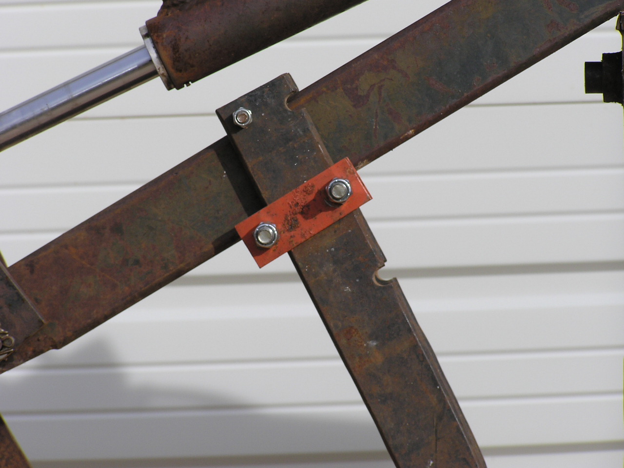

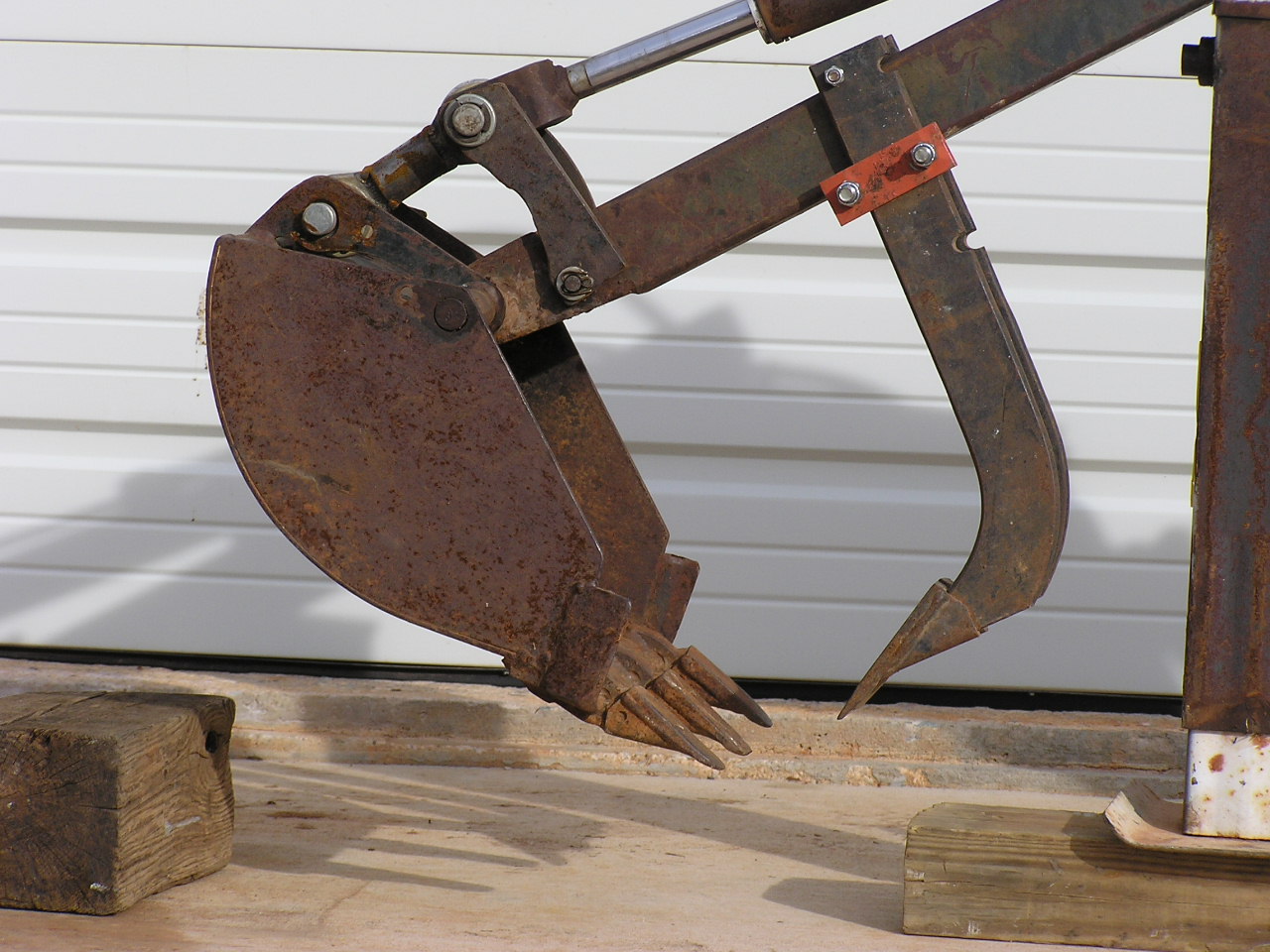

I have a Branson 2800h with the 00 loader with the single add-a-grapple that I got through Tractor Mike (Single Add-A-Grapple for Sale - Ask Tractor Mike-Ozark, MO). I use it all the time. I wanted a full grapple but I can't get a quick attach for the 00 loader.
I was afraid that the bucket would limit me gut it only does with long spindly branches. A true grapple would get more of them. But with clean up it actually gets more in. I drive up to the pile of crap and then close the jaws on it. When it comes to logs I am more limited by the weight of my tractor. My tractor will lift more than its butt can keep on the ground without a lot of weight on the back. I like my 48" tractor that allows be to get in and move around the garden so I have to accept its limitations.
I couldn't find a 3rd function kit for my tractor so I got a generic kit and made brackets. For the price it is great. I keep it on during most of the year to collect brush and trees. I store it on one of the Harbor Freight car dollies (1000 Lb. Capacity Vehicle Dollies 2 Pc). I roll the bucket over and set it on the dolly, pull the bar out, disconnect the hyd lines and roll it away. I can get it off in five minutes and put it on in 10 or so.
I hope this helps others.
John.
