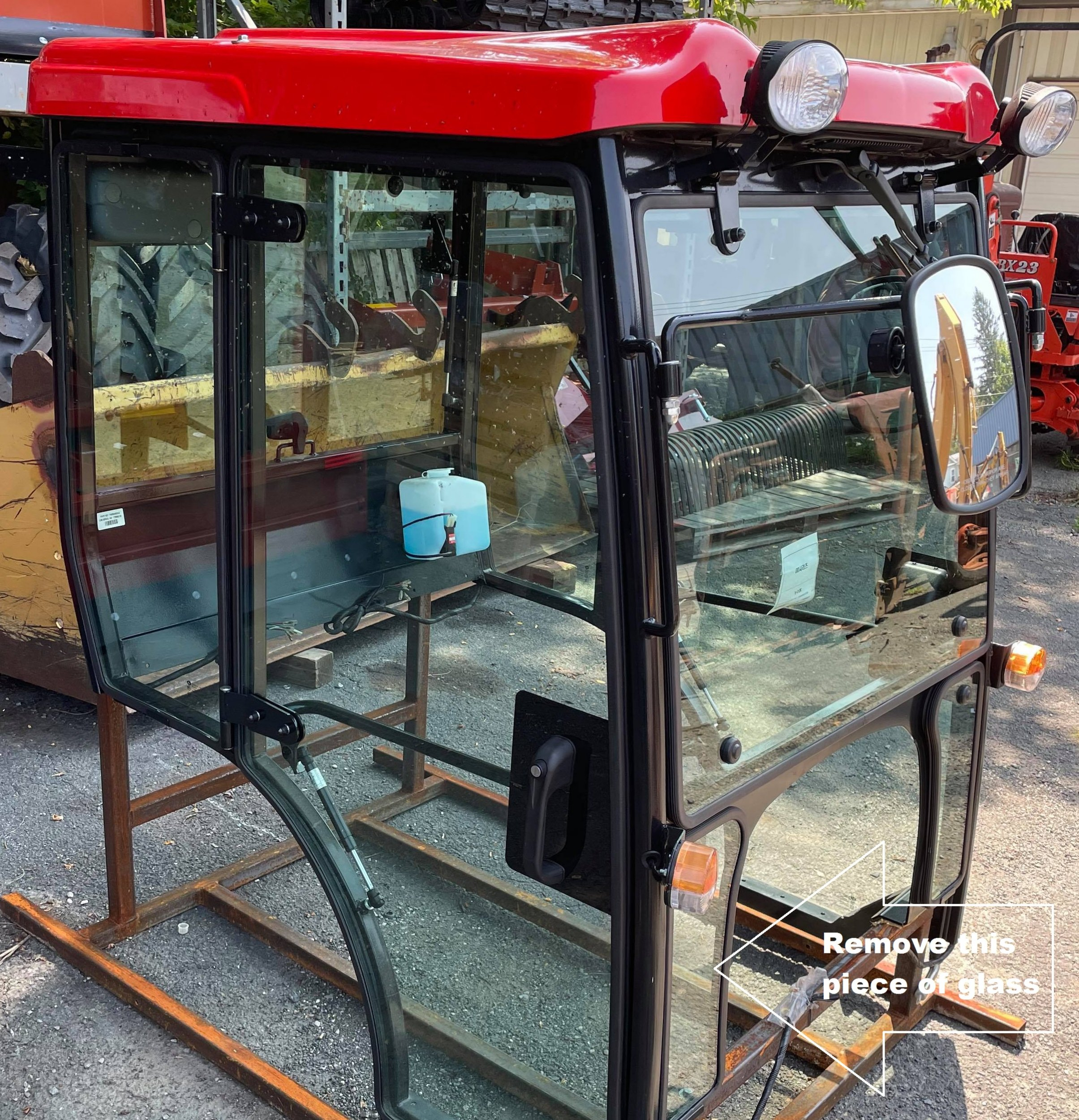

Was wondering if anybody has ever added a cab to a 2400,2510 or 2610. If you did, did you lose the float function of your loader? I'm hearing you will loss the float if you add a cab because they have to change out the loader vale set up to add the cab.

That is correct the tractor itself's length, wheelbase and width are a little bigger But A nice gentleman on here did take some measurements and it all looked like it could be done with a little teak here and there. But I was unable to move forward with it at that time so but I would like to now but I saw a post in another forum where someone said the dealer told him he would lose his float function if he added a cab. I talked to a friend yesterday who had it done and he told me last night that they had to change out his Loader valve assembly and the mounting set up and he did lose his float. So with this new info from last night, I may forget about a cab. I'm going to try and set a time to go look at his 2400 and see what they did and if there is a way to just change the mounting set up to my valve.
/ Add a cab #4
If you can get the cab to work you could go with a aftermarket valve set up and have float. You will have to find a place to mount it and most likely use a cable joystick assembly but it can be done. Some people have fabricated their own cabs for tractors so that could also be a option.

Slowpoke Slim Thanks I will check them out. Branson Bob if I was to build my own cab I would even think about using wood it would be Metal. The issue I see with the factory cab is the lower glass I'm going to look at a cab and see if the lower windows are separate or all fabricated into the cab. I know on some the section around the dash is separate from the rest of the cab and bolts in.

Hey Moak ,
K5 was correct about the cable loader set up on the loader it’s what is on my 2400h w/cab, it has a bracket off the cab to anchor it, Dan
/ Add a cab
#13
Dan Lamp With the cable design do you have a float opinion. I'm only thinking about a cab so to run a front-mounted snowblower without getting snow blown back into your face and no float would make that kind of hard I think you would need to either hold the lever in the down position to keep the blower on the ground at all time.
/ Add a cab #14
Moak,
Yes I do have the float position , plenty of room , DAN LAMB
/ Add a cab
#15
Thanks, Dan We look into these valves.
