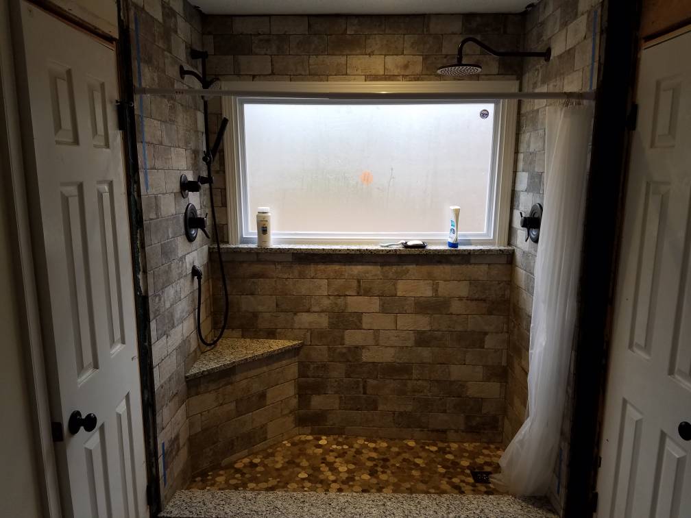

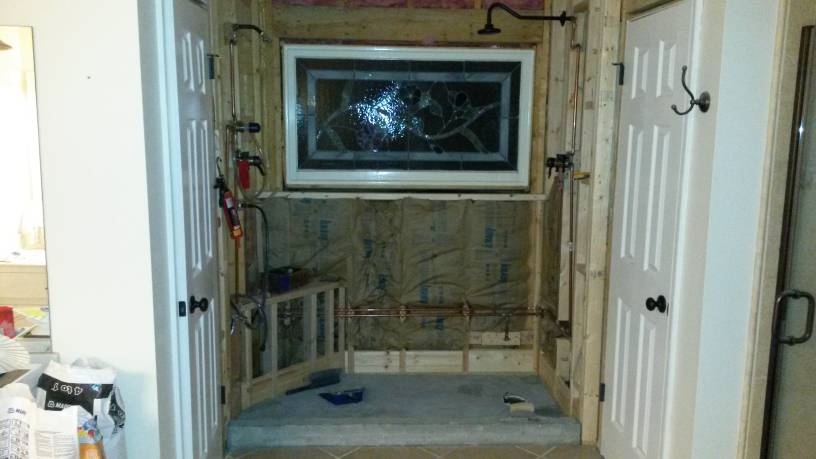

I use oatey #95 tinning solder and their lead free solid core for plumbing. It works well. Any other flux I have used, that solder didn't work.
This is the last thing I used it on. Also rebuilt the service coming into the house.View attachment 588304View attachment 588305
That tinning flux is the only thing I too have found that will allow me to solder copper pipe with the lead free solder.
