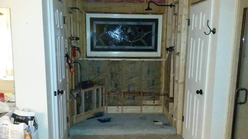

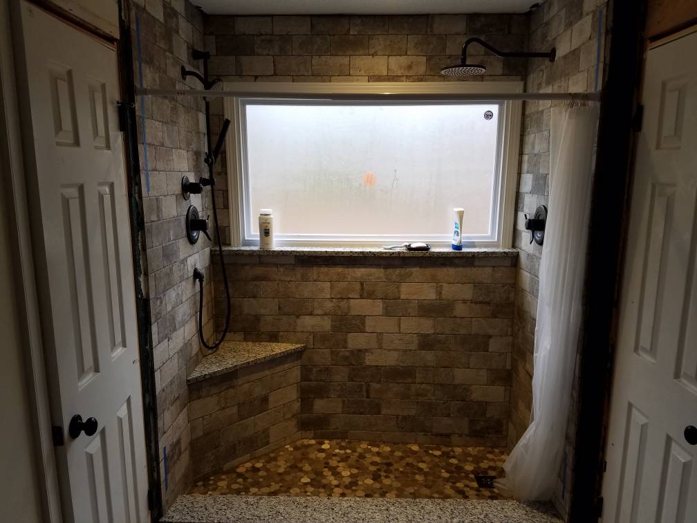

Supposedly acid core will eat the pipe away after many years.
I use oatey #95 tinning solder and their lead free solid core for plumbing. It works well. Any other flux I have used, that solder didn't work.
This is the last thing I used it on. Also rebuilt the service coming into the house. 20170425_222849.jpeg20190104_130729.jpeg
