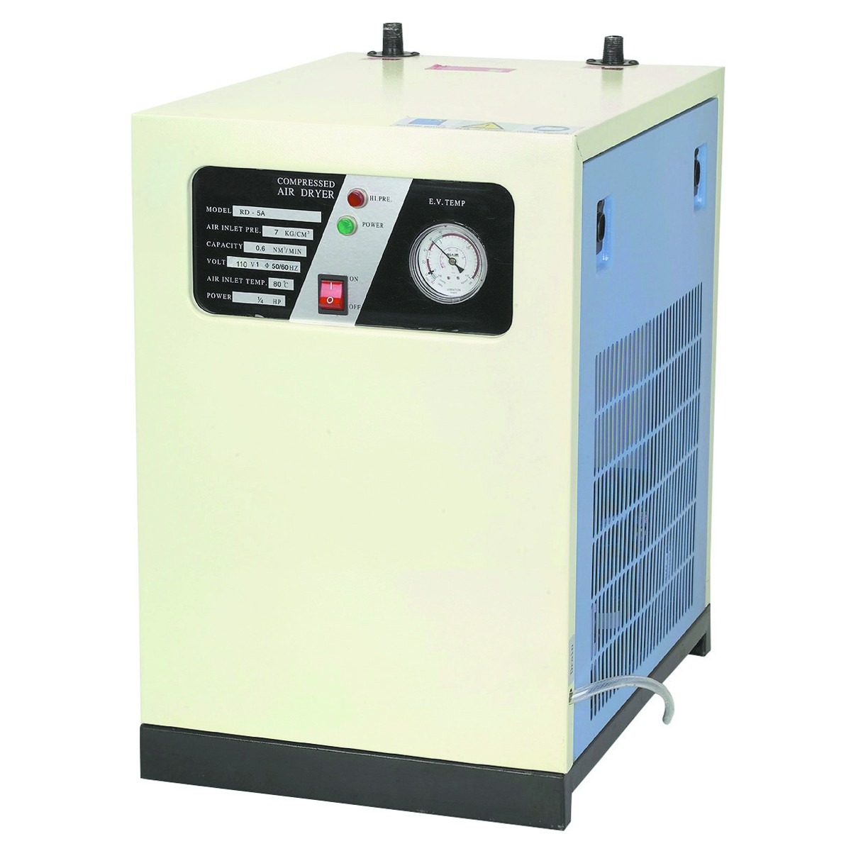

i have a refrigerated air dryer on my system image_11243.jpgharbor freight $399. i paid about $300 back a few years ago. It works amazingly good. removes 99% of all moisture from lines. The post filter (canister paper filter) is 3 years old and looks new. I used to have to replace the paper filter every month.
best investment ever....if you need truly water free air source.
Compressed Air Dryer - Save on this Compressed Air Dryer

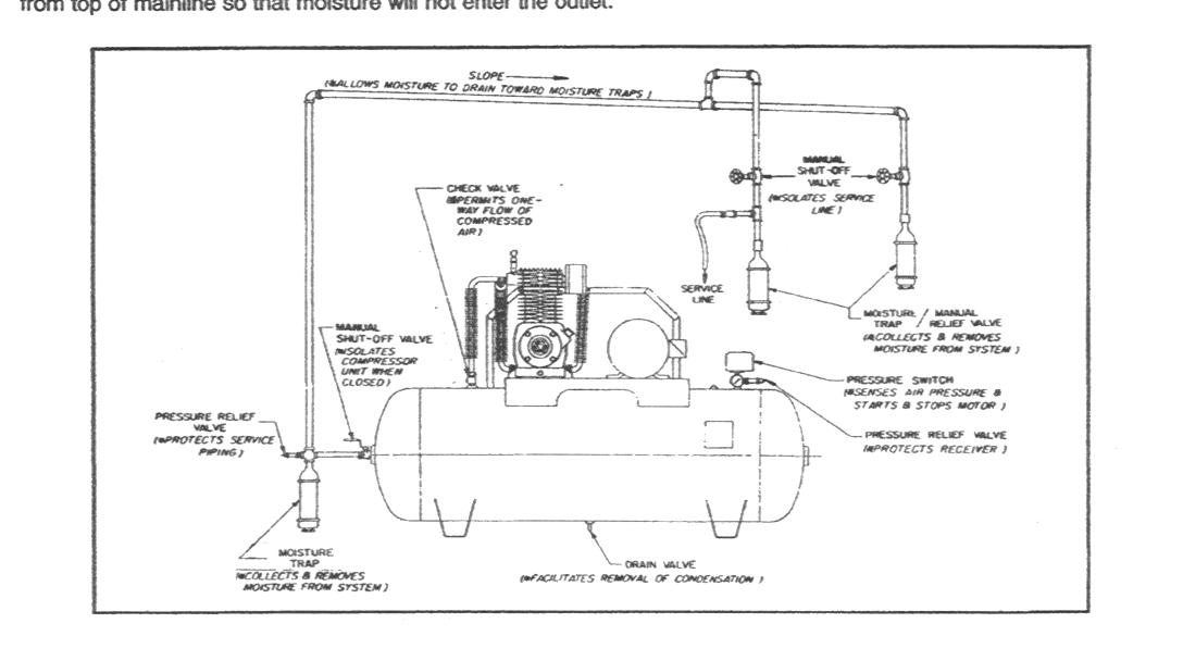

Re: Accessories my new air compressor
when piping the air compressor, notice the line take off the top of the line, and there are drip legs on all out lets,
by draining the machine daily and by following the piping diagram in the picture, you will nearly eliminate the majority of the moisture in the compressed air, the large tank you looking at helps as well as the air going into it is cooled and the moisture condensed,
BIG DOOLEY has some excellent pictures but a few changes in the piping would help a lot on the potential moisture content of the air,

What everyone on here has said is correct...
I am in the process of adding an inline water condensate trap to my system...
The air dryer is the best option but the most expensive...
The schematic shown is correct in configuring the line from the tank...
This will trap the majority of water out of your lines...
