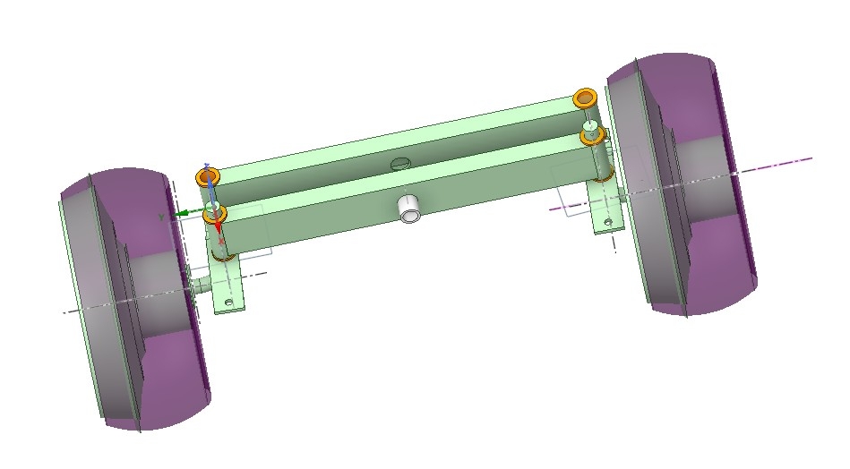

I have been modeling the front suspension of my Hart mower to determine how wide the new suspension part has to be to allow the same turning radius as original. As far as I can measure accurately, the front wheels turn a max of 40 Degrees. So I would have to make my new suspension beam 2 inches longer on each side.
