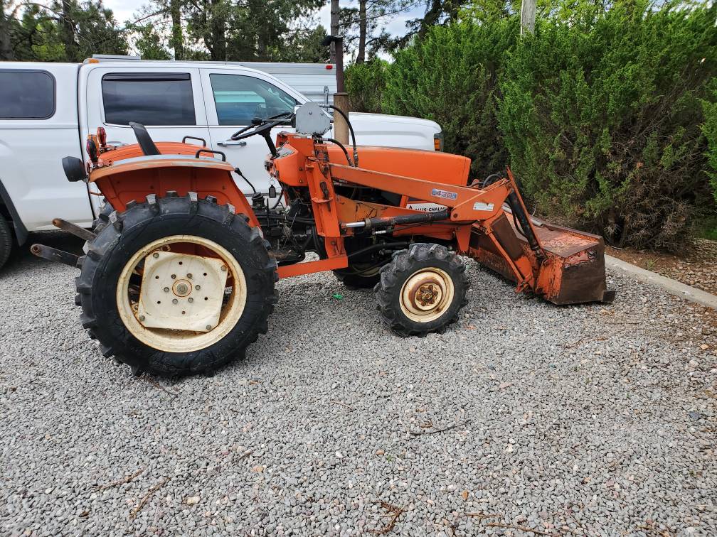

She has 497 documented hours. It's been worked but everything functions pretty well . The right front leakes oil at the knuckle. Other than that there are no other leaks that are worth talking about. It has power steering from a kit that someone built for them 20 years ago. It workes well. New last Friday loaded rear tires and nearly new fronts. I have the original manuals for the loader and the tractor plus a reprinted service manual, 2 sets of filters and a quickatach for the 3 point. I would like to get a 4 ft mower and box blade for it. Moved about 18 yards of dirt and compost this weekend and got about 100 plants into our garden.
I put marvel mystery oil and power service in the silver can in the fuel, should I be using different additives?
It starts right up with just a few seconds on the glow plugs. Clutch was replaced at 250 hrs. No problems shifting in any gear. PTO engages smoothly. 20190531_162414.jpg

It had the thermostat replaced somewhat recently and seems to stay at operating temp well. Cooling system seems to be working great.

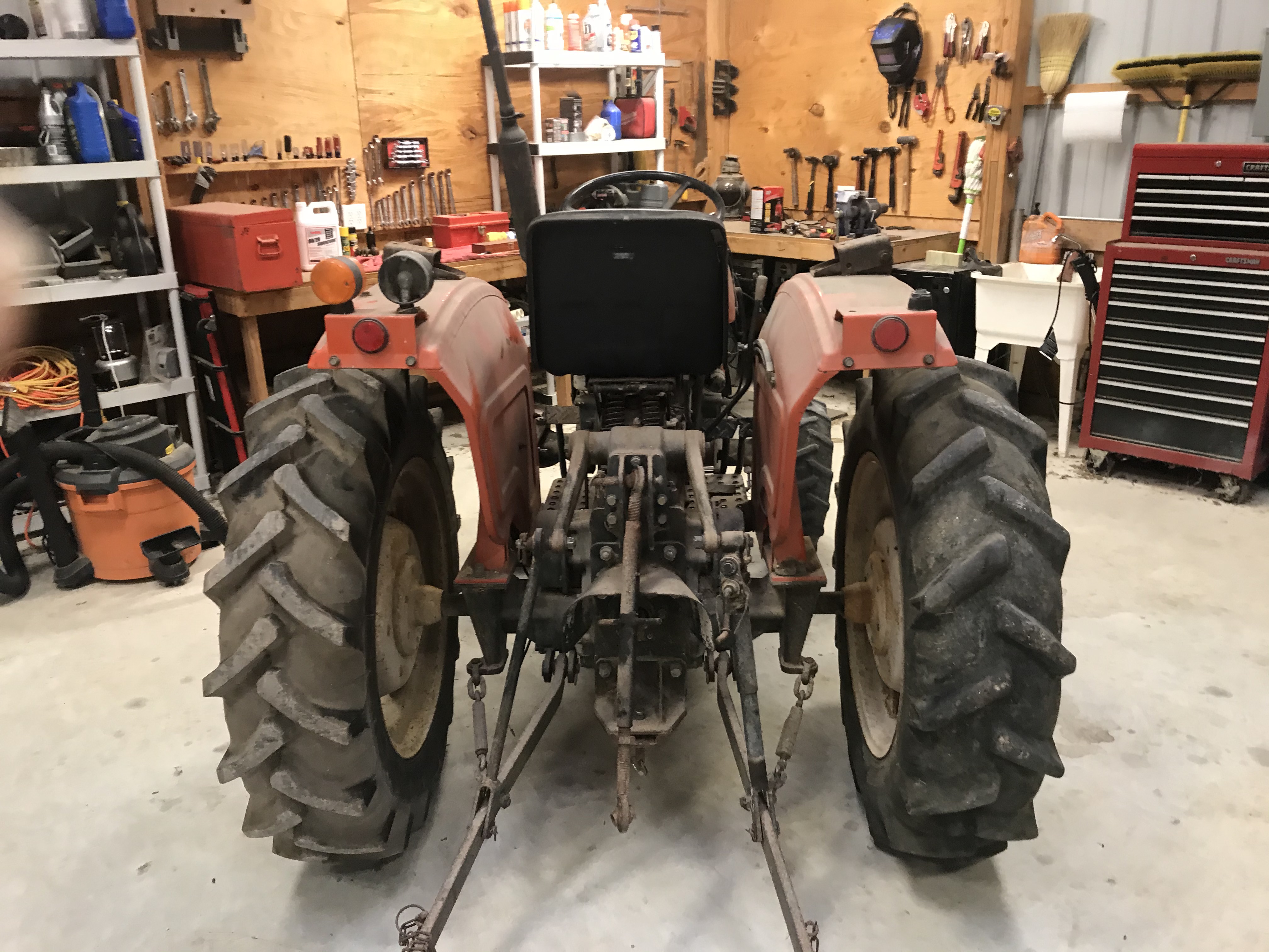

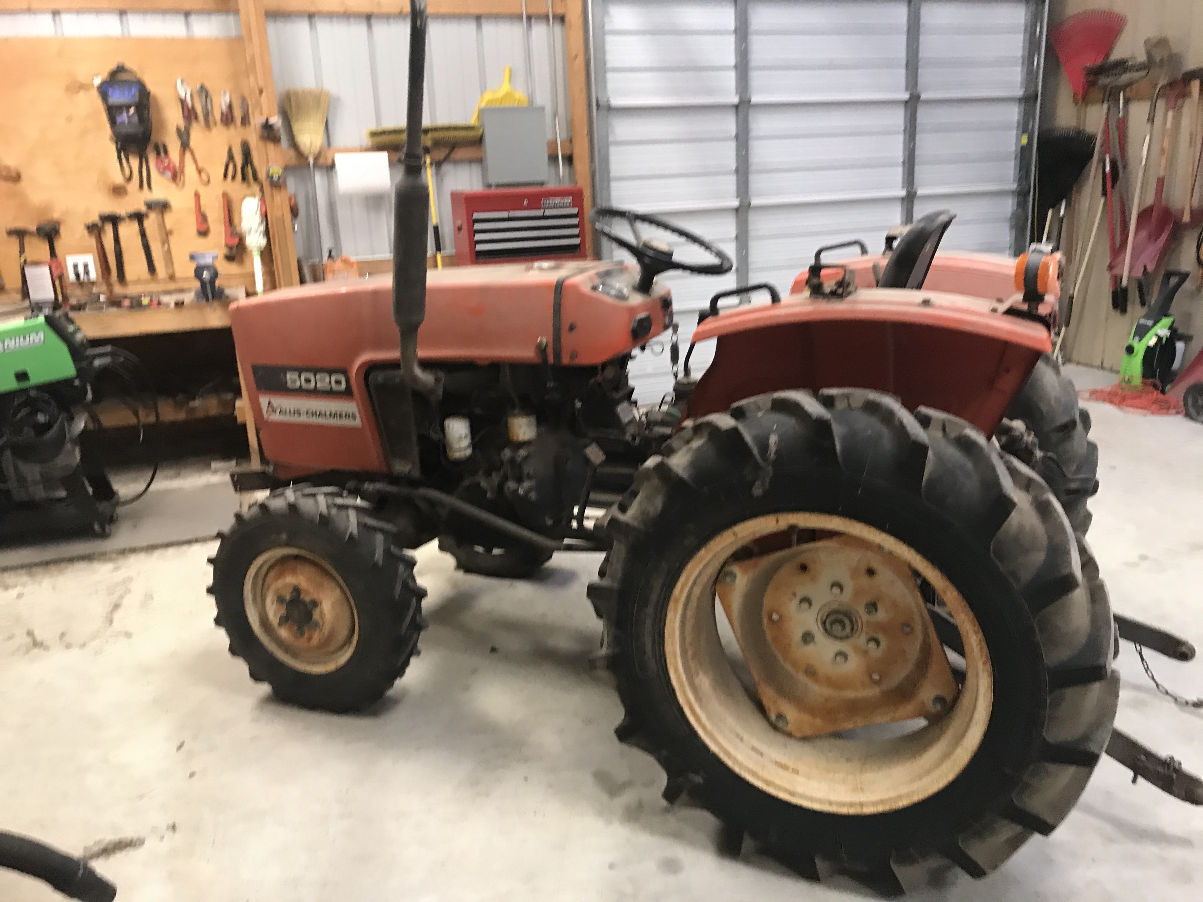

well, I finally got it drug out of the barn it had been sitting in, on a trailer and into my barn. It was not easy. This thing does not roll free even in neutral. Here are some pics. Which links do you want me to measure?50201.jpg50202.jpg50203.jpg50204.jpg

it looks all original. was it in 4x4? i can push mine when its in 2wd and in neutral fairly easy on gravel.
the link that picks up the 3 point arms, yours do look the same though. good luck. ASAP has some parts availible, i just picked up a muffler, they also have some engine parts.
/ AC 5020 / Hino E23 / MF 210 under contract. #13
the fixed link on left side is 21 1/2" center to center.

also upgraded to a harbor freight led flood light on the back, and got the tail and head lights working. used some silver polish on the lenses on mine. looks like yours has sealed beams?? seems odd they would have changed the headlights. I had to order bulbs as they are a base i have not seen before.
