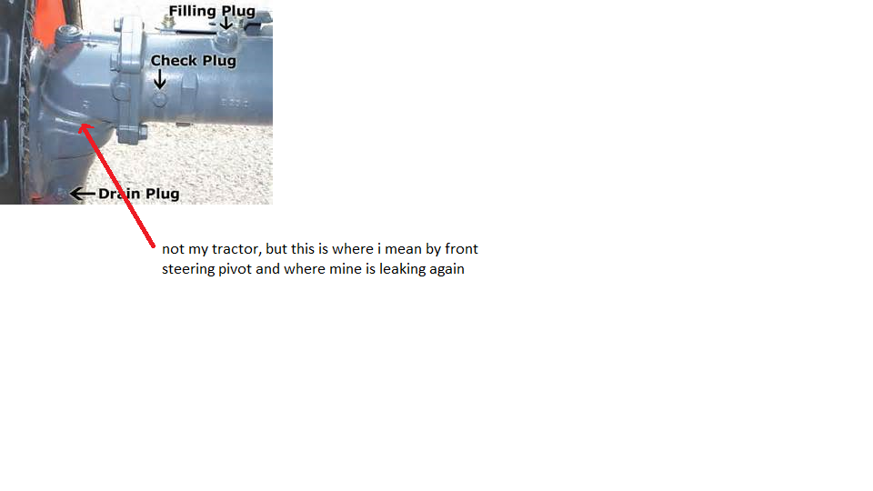

My 2007 Kubota b7800 tractor with la402 loader just started to leak on the front axel where the steering pivot is. this time it is on the right side. about 300 hours ago, it did the same thing on the left one. this tractor has 1550 hours on it, but it seems the front axel issues are starting to add up.
just a month ago, the front axel pivot starting squeaking bad when going over bumps and mounds. upon inspection, the axel pivot was so tight, I could not pivot it unless I jumped on the tire when I propped it in the air with the loader. the "o" ring in the rear part of the front axel (where the 4wd shaft goes in) was gone and all the bushings were corroded and rusty. the front axel adjustment bolt was not too tight as I checked the torque and it was right on the correct 15ftlbs.

this is a picture or where I mean

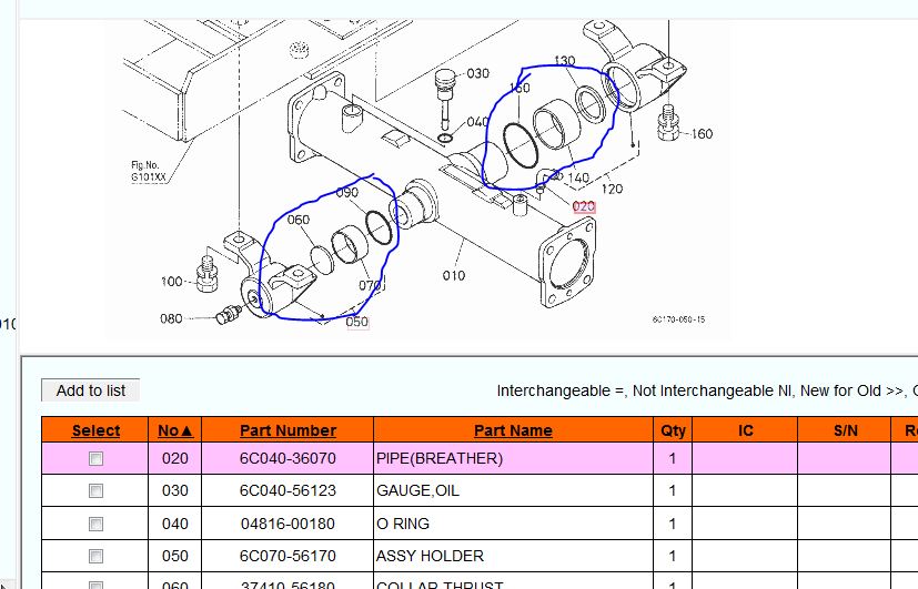

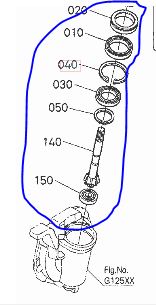

Ray, Im not sure how mech. you are If I still lived in PA Id be temped to come help you. I love wrenching on tractors.
attached are two kubota parts list so you know what your up against and what parts you would need to replace. Front Pivot.JPGsteering shaft.JPG
hope they images come through other wise ill try it again.
attached are two kubota parts list so you know what your up against and what parts you would need to replace. View attachment 388238View attachment 388241
thanks displacedpa. I did need the steering pivot break down. I have the axel pivot bushings and o rings to still put in. good timing I guess as at least I can fix BOTH problems at ONCE. save some money on axel oil and save on down time.
