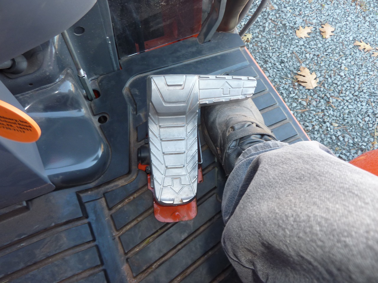

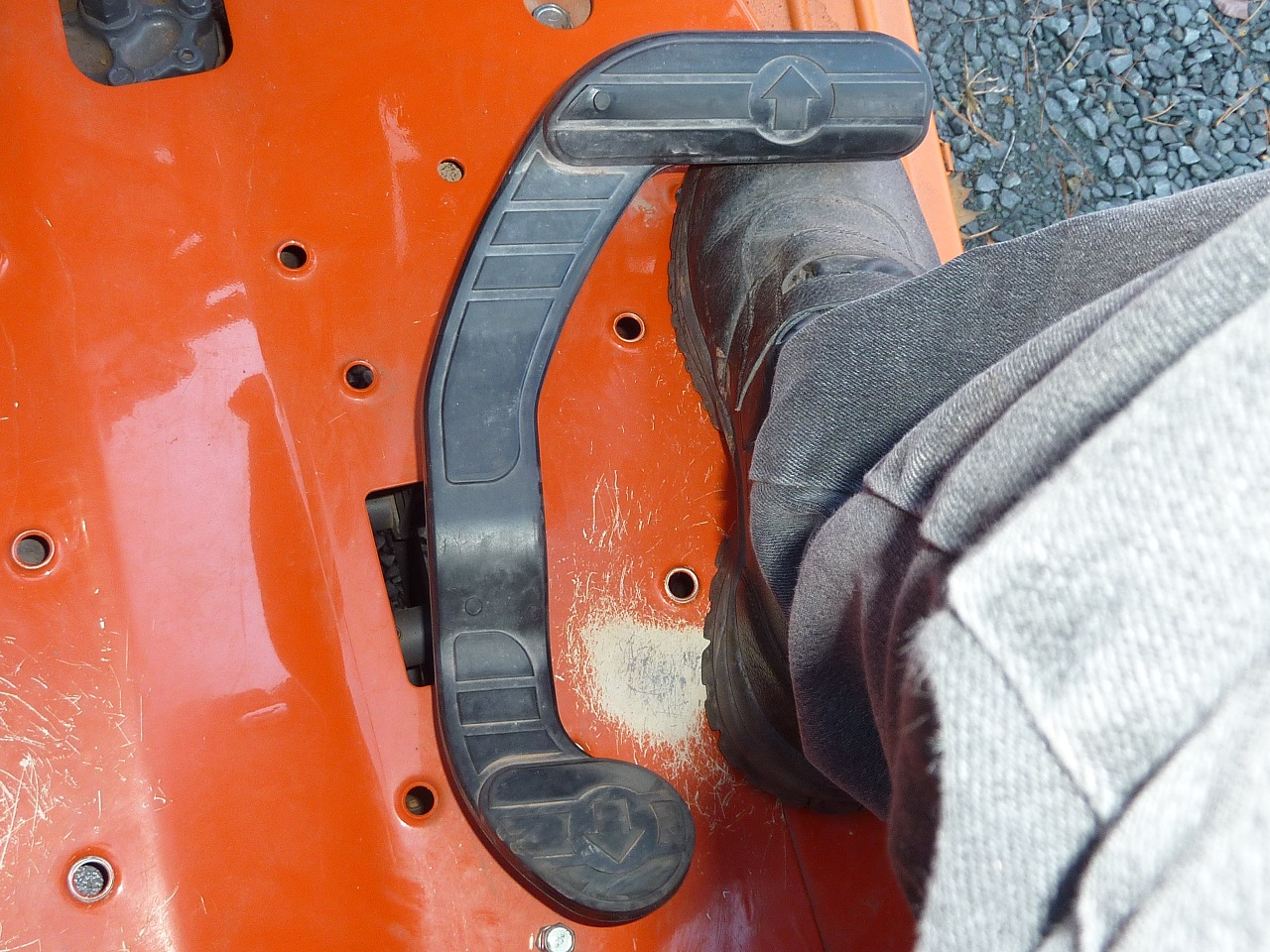

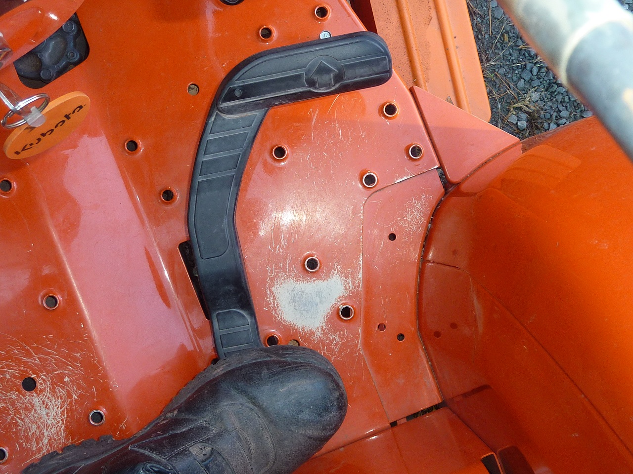

Obviously there are a lot of differing opinions on gear vs HST. If you don't do much maneuvering or frequent repetitive tasks, Save a few $$ and go with gears. In my case, five of the six Kubota's I've owned over the years have been HST's. For the work I do in tight spaces, I much prefer the time savings of not having to stop and shift frequently.
I'm not sure what model year Kubota tractors you're looking at. Since there is no clutch on Most newer L series HST's, many now have split brakes on the left. This is the case with my current L6060 and MX5800 and I frequently steer using brakes.

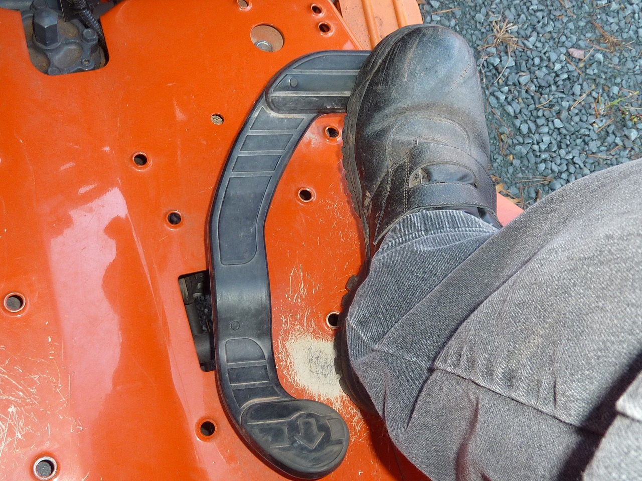

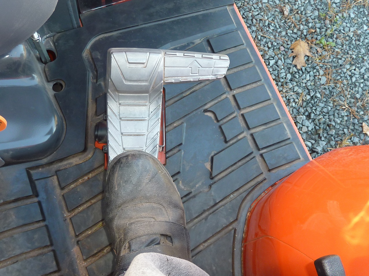

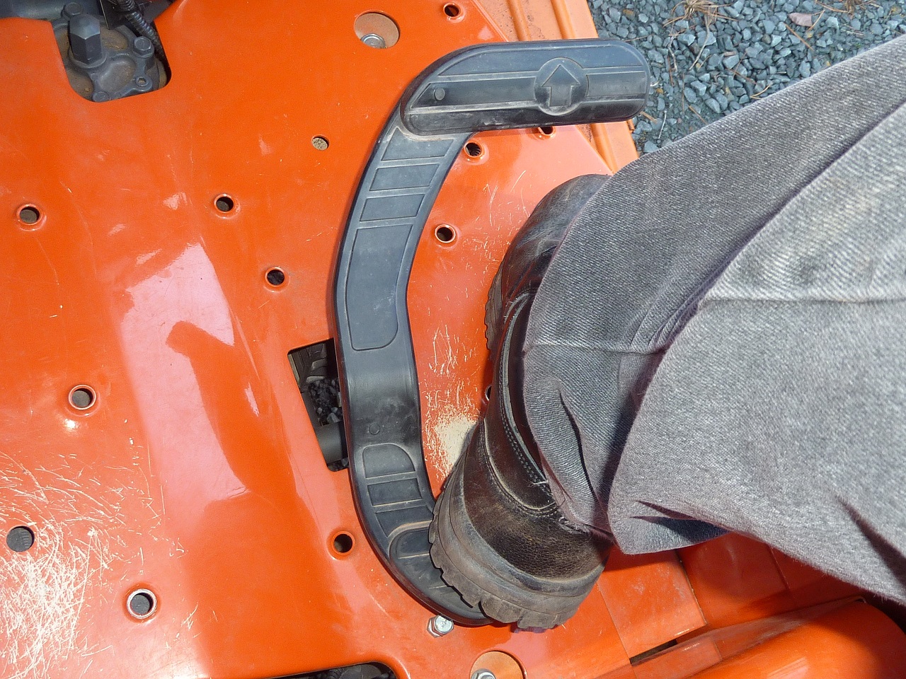

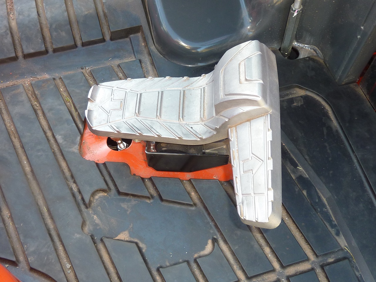

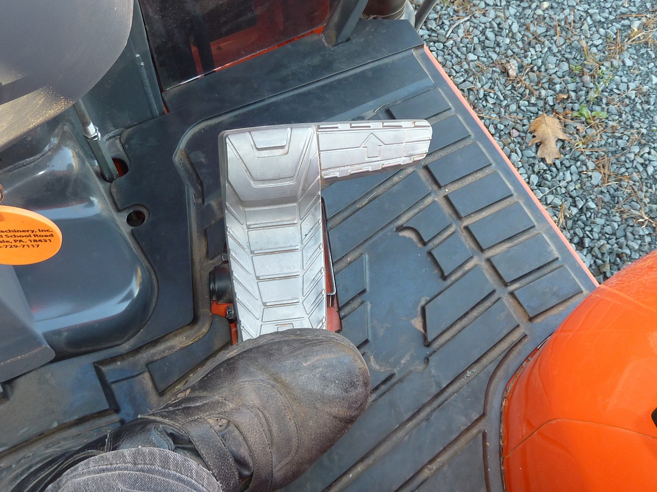

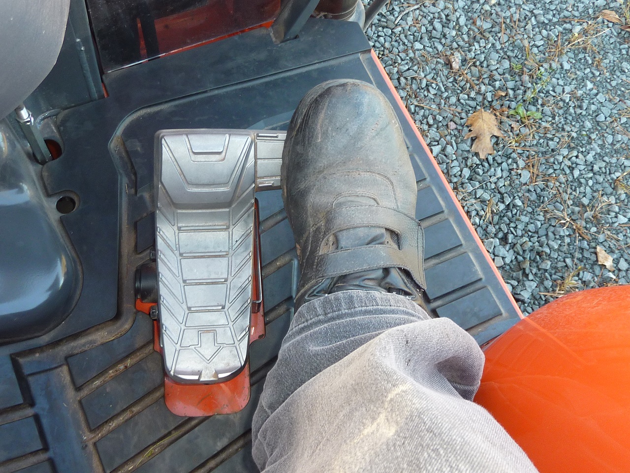

The HST pedals are also subject to personal preference and some user adjustment is required to use comfortably. I use these techniques:
L6060
MX5800
When operating in reverse, I use the toe of my left foot as shown in the third picture in each row. I can't speak for others but I have arthritis & two joint replacements and have no trouble with these operations.

Your bottom pics are how I operate my MX5800 as well. Never operated a Geared tractor so I have no experience to say anything about them.
