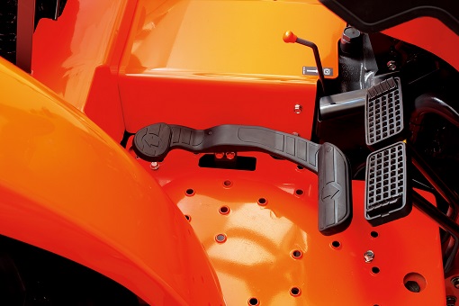

The peddle took me a little while to get used to, now I like it. Big mistake placing your foot on the top and "rocking" back and forth. Its just way too uncomfortable for anyone over 5ft tall. Use your toe on the forward end and rest your heal on the floor board. For reverse, lift your foot and place your toes where your heal was, and heal on the rear part of the peddle. Yes, its more movement of your leg, but way easier to control.
As crashz states, that is the way to operate rocker pedal. I think first impulse for some is to place foot across whole top of pedal, which again as crashz states, a big mistake, then they're turned off to the treadle.
   / About this pedal thang #84
While I agree that the split brakes are useless on these models unless you have cruise control, they actually don't need them. I used the split brakes on my 770 a lot, but the 2501 seems to turn better. With a 5ft mower on the back, I think you'll be able to get to everything you need to.
Would I chose gear over hydro next time? No way! This machine so nimble and controllable, I could never give it up. For close quarters, its amazingly handy. The 2501 will do any ground engaging and loader work you can throw at it, but If you need a lot of PTO power, the higher power model (3901) may be a better choice. I've had mine bog in heavy growth with both the 6ft finish mower and 5ft bush hog on and had to slow down to clear it out.
Really, I don't see it as a big mistake at all. I find it odd that that's the way someone uses the treadle pedal in the manner you've described and the one shown in the video linked earlier, if that's what a person likes then so be it. Our son has an L3940 with almost 2000 hours on it that's used 365 days a year on a cattle feedlot, lots of in and out feed troughs. It's other main job is to load a 155 bushel manure spreader. I've timed it and that spreader can be heap/pile loaded in under 4 minutes and I've never seen anyone here lift their foot off the treadle pedal to go from forward to reverse. Now I realize the L3940 has a slightly different shaped treadle pedal but he had an MX5100HST at one time and it was the same shape as a L2501 but maybe a bit larger pedal not sure. I don't recalled anyone not being able to just rock their foot on the MX.
Very glad to hear you like your L2501 BTW, our son is looking at one for doing clean up work and odd chores.
   / About this pedal thang #85
I don’t understand it either. People criticize having to lift their foot on a Kubota. I have green and orange and I find the Orange easier to use. There is one thing for sure one has to lift there foot to go from one hydro pedal to the other on green. Funny that no one ever complains about that.
   / About this pedal thang #86
My foot somehow figures it out all on its own.
   / About this pedal thang #88
My only experience with the peddle is on a buddies 2501, I'm 6'-2" and there is no way I can comfortably rest my foot on the peddle, it's too uncomfortable on my hip and muscles. Now if the seat were higher for us taller fellas it might be different.
   / About this pedal thang #89
The Kubota L2501, 3301 and 3901 have the split brakes on the left side of the tractor, HST treadle on the right side of the tractor.
Brakes are on the right above the treadle
