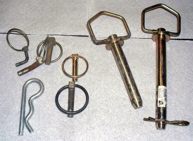

Well, I took a picture of the lynch-pins so you could see the difference (see attachment). The pin with the black spring-ring is obviously much heavier than the cheap 3 for $1 type. Also, as you can see at the top of the photo, the cheap pins bend easily and their spings sometimes become frozen so that they don't close all the way. The large hairpin I put in toplinks or stabilizers where I won't be disconnecting often. I push them all the way to the large ring so they can rotate, but not bind or fall out. I've had good luck with them anywhere I would otherwise use a lynch-pin. Finally on the right are two Category 1 pins. You can get them in various lengths at Tractor Supply. If you want the premium ones with plastic coating on the handles, they are more expensive, but seem to hold up better. The only drawback to these pins is that the hole in the end is too small for a normal lynch-pin. You have to use a hairpin or a small lynch-pin. I hope this helps. /forums/images/graemlins/grin.gif

Hi Jinman Thank You very much for the attachment showing the various pins.
I'll check at TSC for the ones wih the black spring and if they don't have them, I'll check with NH Dealer. Thanks Again, Leemac
