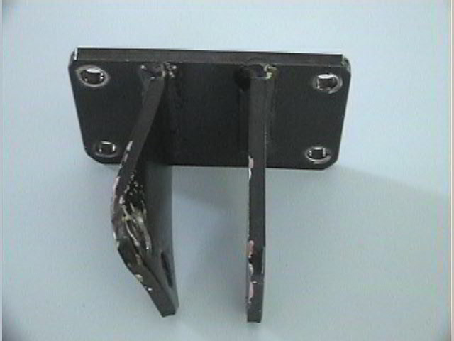

Here' s a photo.
Bruce
   / Aaaarggggh! I broke it! Help! #12
What I would do is put a spacer between the tangs that is the same thickness as it was originally, then take a big hammer to it. It will straighten right out.

<font color="blue"> I guarantee that I will no longer be using that type of pin for my top link.

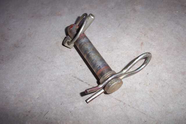

I experienced similiar problems with pins coming out either at the top link or lift arms. I have found the trouble to be not at the end that has the lynch pin, but the other end that is just small enough to sneak out. I have now resorted to placing a hairpin (no, not the kind for your hair) on the other end to keep it from falling out. I'll post a picture later.

Ok, here is the picture I promised. Notice, I do not use a hairpin in place of the lynch pin, I use it in addition. I've had problems with top link pins sliding out the 'other' way. So, I use a pin on both ends. I have never had one come off since.
Also, can someone show a picture of 'safety wiring' a hairpin. I am not familiar with this.
