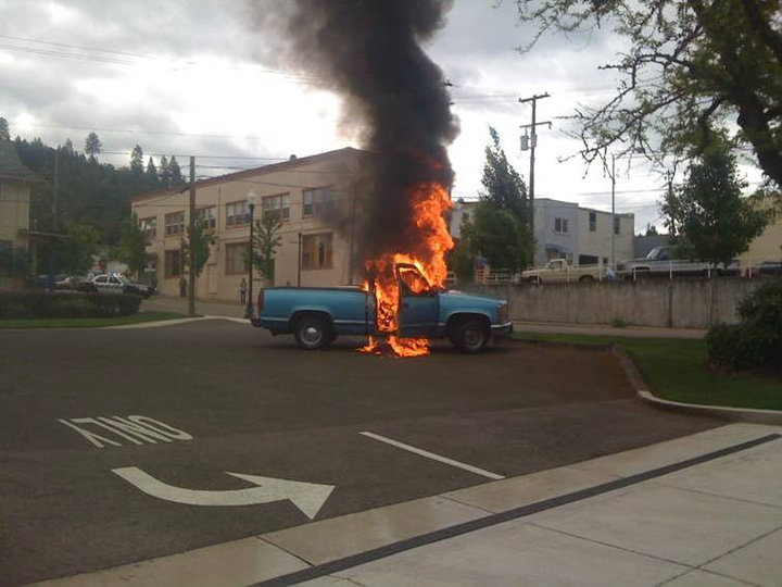

I got to pull a fire alarm once. I saw a car fire start on the top deck of a parking structure, smoke coming from under the hood. First it was just a puff of smoke, but quickly got bigger. By the time the fire department got there the whole front half was on fire. They pulled it out away from other cars, but didn't really try to put it out, just foamed it and let it burn.
I also ran across this one in a parking lot next to where I worked. From the position of the vehicle, it must have caught on fire while someone was driving it. It was a block from the main fire station, so this is how fast a vehicle fire can progress.
