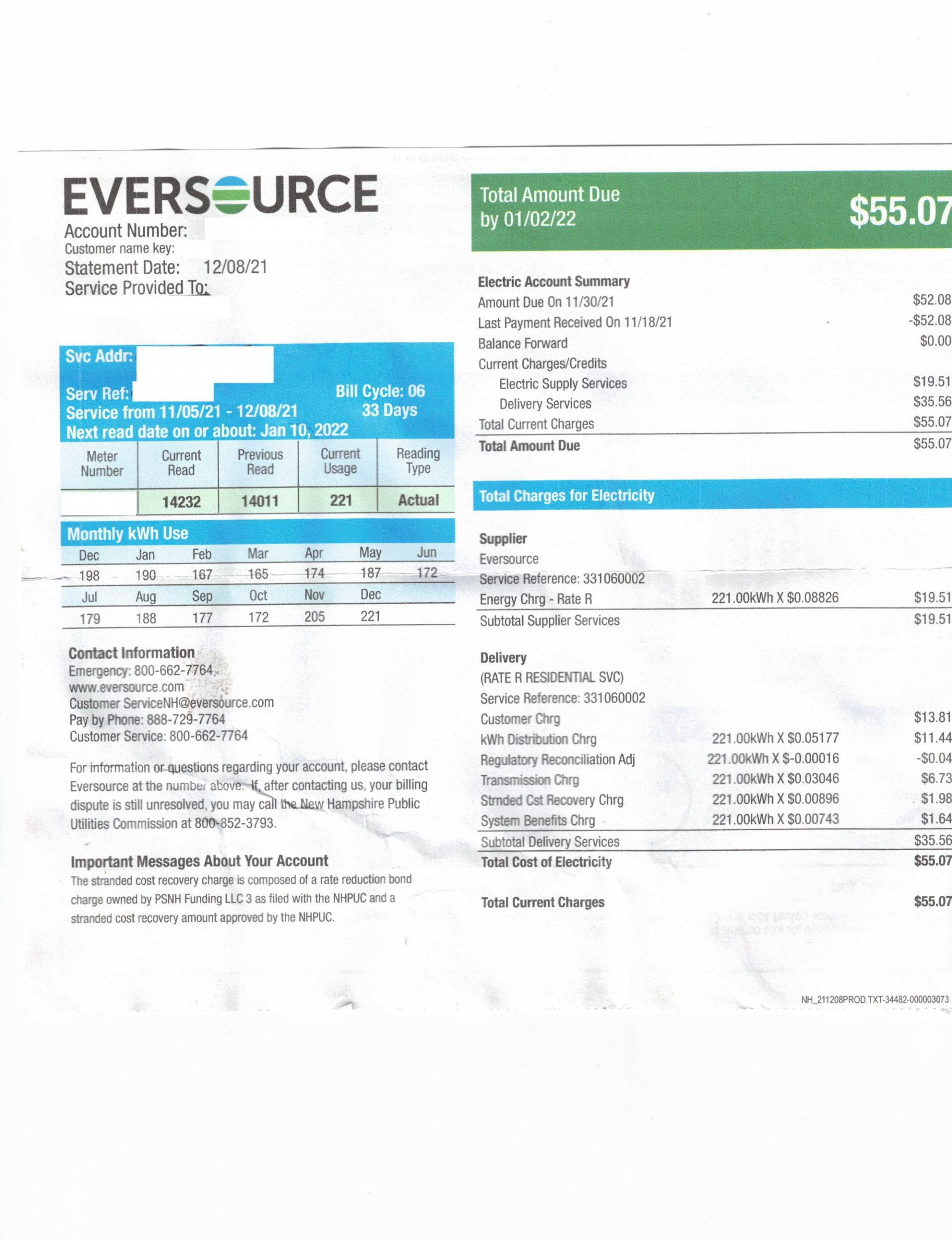

220kWh on a 30-day month is an average of just over 300 watts continuously.
Do you have a refrigerator or any lights?
Im confused on how that's possible unless you have solar already. That's equivalent to about one hot washer and dryer cycle of laundry a day and no other usage.
Yes we have lights, refrigerator, a small freezer and all the other modern conveniences. It's just the 2 of us, we maybe do 3 loads of wash a week, no dryer. Woodstove for heat, propane HW heater & kitchen stove, gravity feed well (only get ~22 psi, but that's enough for anything we need to do, even shower). Unless you count a clothesline, nothing solar.
As you can see, last month was the highest usage this year, not sure where the extra is going.
I guess I have to ask, what do some of you with considerably higher electric bills do that uses so much electricity?

We use on average 550KWH/month - 3000 SF house, do 4 loads wash a week, electric dryer, FHW Oil heat, gas/propane stove, 1.5HP well pump, 3 TVs', and a fridge.
I don't consider our use extensive, but Eversource is expensive at $.22/KWH so $120/month. The garage 7.2KW solar panels net metering offsets/covers 70% of the house bill.
